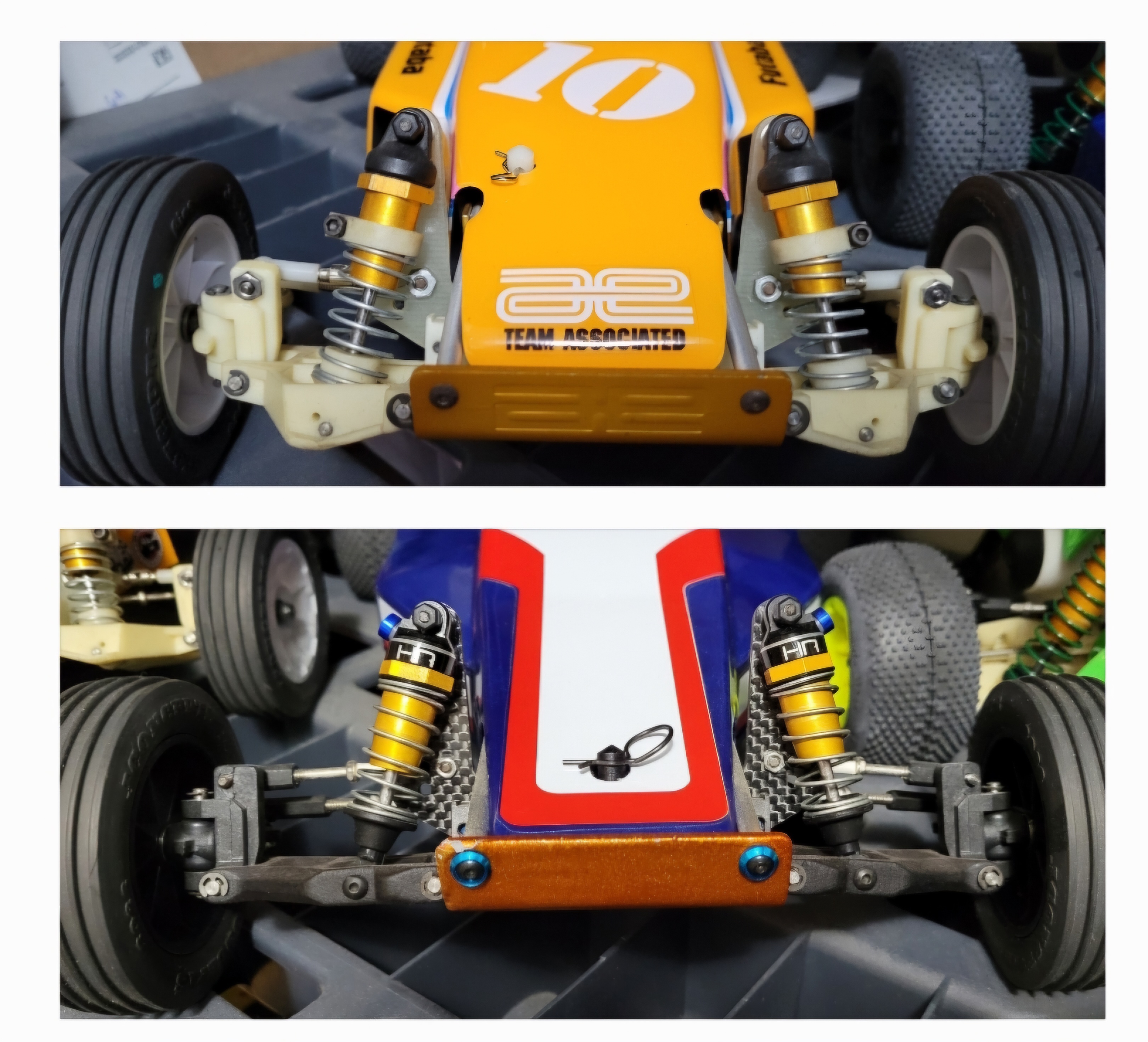

by juicedcoupe
Here is a comparison Pic. Both car have the same length shocks, same springs, and same tires. The short arms and Andy's arms mount the shock relatively the same.
The difference in spring seat height and preload is pretty evident.

I did look at the cups , they are really deep , I did consider just making a 2 or 3 mm spacer to go over them so I might start there
