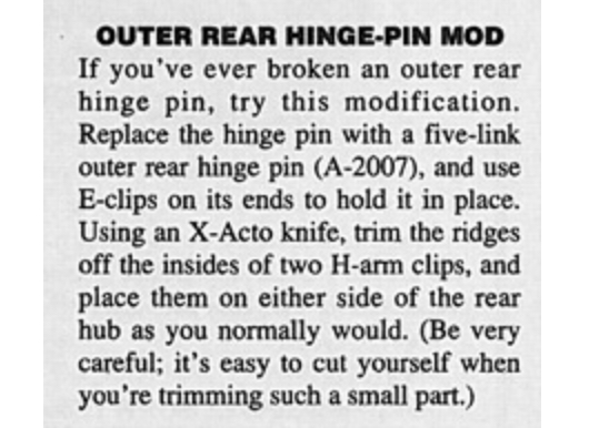

Sounds like the breakage caused the accident.. For a stronger modification, you can use A-2007 5-link outer hinge pins. This was featured in Losi Tech Talk back in the day. Here it is on my runner JRXT but I used some shock spacers instead of the push on clips.

BattleTrak wrote: Sat Dec 14, 2024 1:47 am Sounds like the breakage caused the accident.. For a stronger modification, you can use A-2007 5-link outer hinge pins. This was featured in Losi Tech Talk back in the day. Here it is on my runner JRXT but I used some shock spacers instead of the push on clips.
Thanks so much for that info BattleTrak. Coincidentally the A-2007 pins are what I was able to find on Ebay. Sounds like I got lucky.

The parts arrived and everything is back together. The A-2007 mod worked great. Weirdly my old JRX-Pro lists the outer hinge pin part number as A-2007, which it definitely was not. I'm guessing that was a misprint that carried over the JRX-2 part number. Oh well, happy accident.

Tucsonan wrote: Mon Dec 16, 2024 8:36 pm The parts arrived and everything is back together. The A-2007 mod worked great. Weirdly my old JRX-Pro lists the outer hinge pin part number as A-2007, which it definitely was not. I'm guessing that was a misprint that carried over the JRX-2 part number. Oh well, happy accident.
I never noticed that in the Pro manual! The correct rear outer H arm pins are A-2023. Glad it all worked out and you’re ready for battle again!
