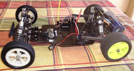

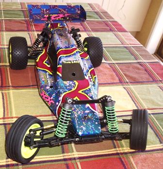

I just bought a couple more vintage Losi'-A JRX2 & a JRX Pro.
The Pro is in good shaep and will become a nice shelf queen,soon.
I want to run the JRX2,and have been-with a brushless setup in it!
The JRX2 is currently running H-Arm rear suspension,with two upper side 4-links still there.
I REALLY want to put this car back to it's origional 5-Link rear suspension,what do I need to do this?
I have two new side four link mounts on the way and already have the upper two side links-what else do I need and where can I get it?
I'm sure I have the correct uprights to run the 5-Link,so I guess I need the lower two 4 bars on the side and the four links where the A-arm is at the moment.
Am I missing anything I need?
I want to run the JRX2 for a good,long while before restoring her,with the brushless!
It's rugged looking,but I kinda like it's beater looks...A wing would be cool,too.
Does anyone have the parts I need?

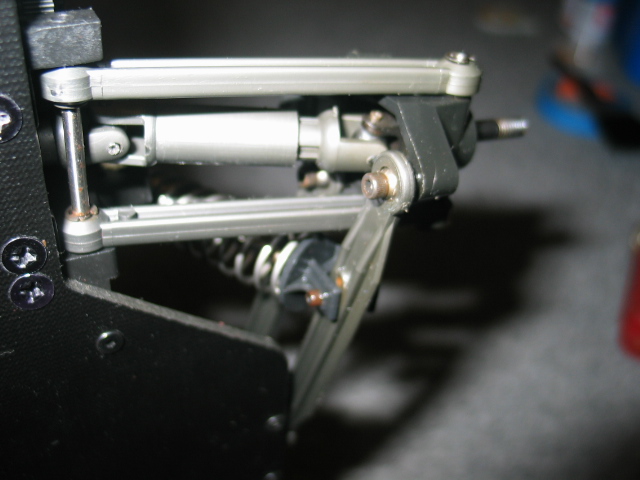

can you post more pics of your current setup without the rear wheels on? I'm curious as to how you have the shocks mounting considering they normally mount to the bottom link which is missing. If you plan on running the car regularly you will find that the rear lower shock mounts tend to be a weak spot.

If I remember correctly I think the main things you need besides the links mentioned are the lower shock ends and the shoulder bolts that go with them. Other than some pivot balls and bolts for the lower side links, which should be no problem. I’m assuming that you have the correct hubs, otherwise no where to mount the upper side links that are on the car.

Sure,I'll pop the rear wheels off and snap a couple photos.
The shocks are bolted to the H-Arm,with 10mm spacers.Thanks for the links-Much appreciated!

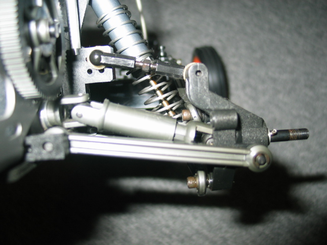

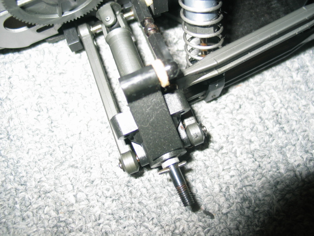

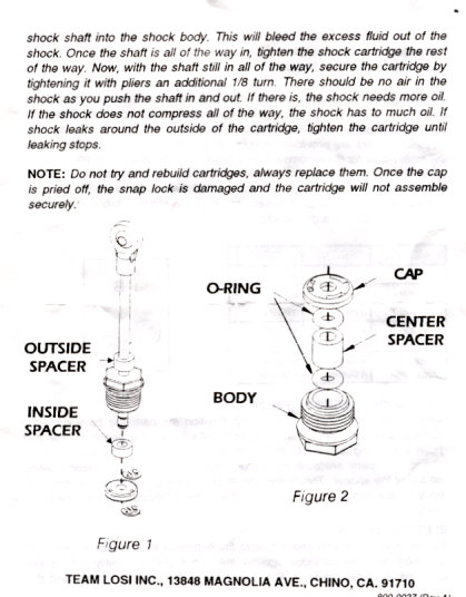

The newer style shock cartriges will fit, but they may require spacers. the new ones are signifigantly shorter, both the portion inside and outsied the shock body. They used to come with a little slip of paper to explain what spacer went where depending on which car you were putting them on. If I can find one I will post a pic of the instuctions.

Aaaah,ya beat me to it,Gary!
Here's mine,anyways...

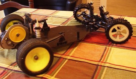

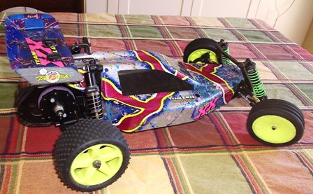

Check out my $50 Losi XX that arrived today...Even has an X-Cellerator body!

Not to mention a working,leak-free HydraDrive!
Cool,so the XX era double 'O' ring catriges will work on my JRX era shocks?
NICE.Cheers,Gary!
NICE.Cheers,Gary!

Thanks so much for the shock catrige info,Gary!
