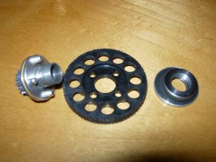

Any thoughts on the MX-4 spur? I have not taken it apart yet, nor found a manual yet, but it really looks like not-standard.

The spur gear is unfortunately crazy specific. Getting to it requires a good amount of disassembly too, but once you get the slipper right, its a set and forget thing.
As for the gearing, the internal ratio is 2.2 and the stock spur has 84 teeth. I'd start with 19-20t pinion to get you an fdr of 9.7 or 9.2.
Here's a pic of the gear, please ignore that it's stripped to DEATH!

The rear shock tower is the MR4-BC part. Many of the parts are interchangeable between the MX4 & BC. The diffs, rear belt, frt bulkhead moulding, wishbones & front hubs are indentical, & the rear gearbox main mouldings are interchangeable (but not identical).carloco8 wrote:Stick with the molded rear shock tower. It absorbs all the force in a bad rear impact or upside-down crash. The graphite and fiberglass rear towers will crack, but the molded one will flex a bit more. I think its also an MR4-BC part/MX-4 upgrade?Mr. ED wrote:3. I have seen on the old Keil site that the MX-4 pictured there uses a flat sheet of carbon for the rear shocktower. Yet on mine it's a molded 3D part. Which would be the better one?
The spur gears on my cars is an offset moulded part, I've never seen one like it on any other car. The MR4-BC took a standard Kimbrough style spur...but then it had no slipper and destroyed rear belts & diff screws as a consequence

The spur gears on my cars look like Carloco8's - an offset moulded part, I've never seen one like it on any other car. Also the slipper is a real pain to adjust but at least it has one - the MR4-BC takes a standard Kimbrough style spur, but has no slipper and so destroys rear belts & diff screws as a consequence

Spurs should be easily available. In the UK, the sport version of the MR4-BC came with the MX-4 spur mounted on a plastic moulded layshaft pulley.
The race version of the MR4-BC (called a "Special" and only identified on the box by a sticker, in true Yokomo style) was the one that used a standard type spur, but mounted to an alloy layshaft pulley.
The standard BC was on sale here until 3 years ago - I'm sure CML distribution or DMS models in the UK would have spares still.
