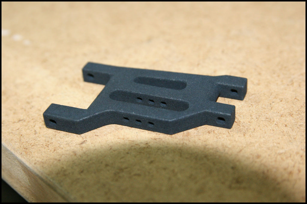

Been building this for a while now - just getting around to finding some pics. Between my camera, my wifes old camera, her new camera and 2 cell phones I'm digging through everything trying to find them! lol. Besides spare/use parts I'll be doing some 3d printed stuff as well. As I find more pics I'll post them...

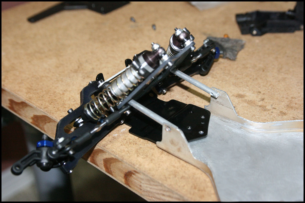

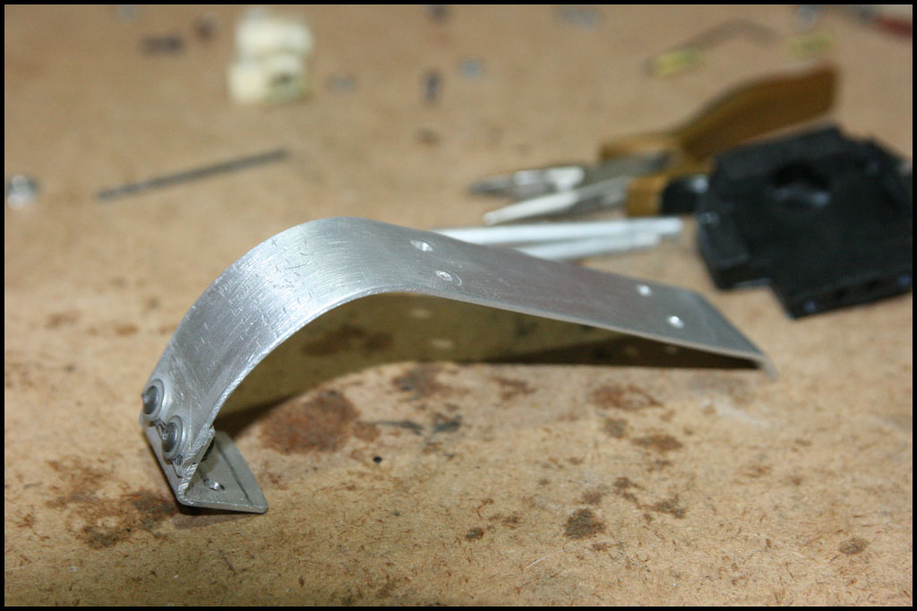

This is sort of what I had in mind. I wanted to cut down the sides (not shown in illustration) and then use them as my "connectors". I was going to use that as-seen-on-tv stuff Alumaloy to "weld" everything together. HOWEVER, as good as it works for aluminum repair it just wasn't working like I'd hoped. I've used it before for fixing aluminum in one spot...but when doing multiple, or larger spots it just doesn't work great...it's basically soldier...once heated back up it re-melts. Back to the drawing board for something less cool. I wasn't up for taking it to someone for tig welding and I knew my mig welder would work but it would have been more work than it was worth.
(a cnc milled version out of billet was over $1000 - so that was out too! haha)

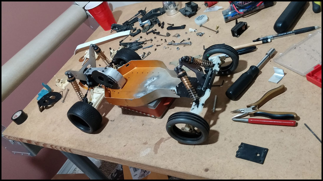

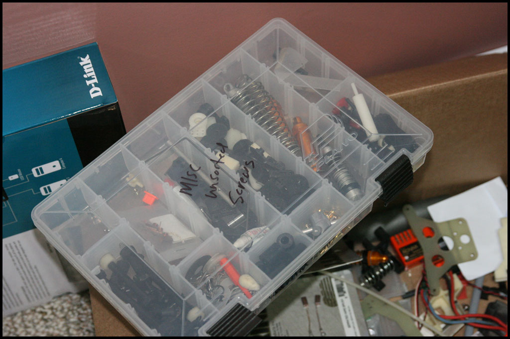

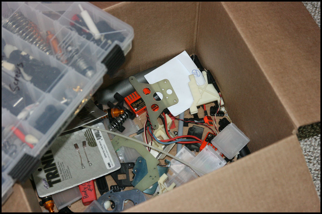

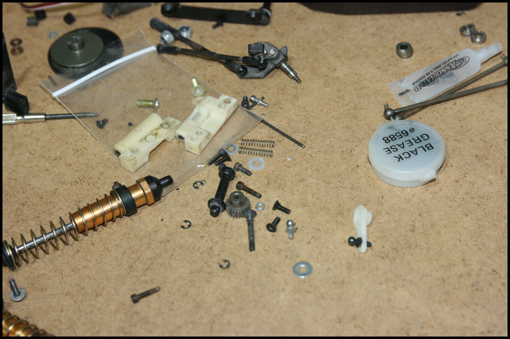

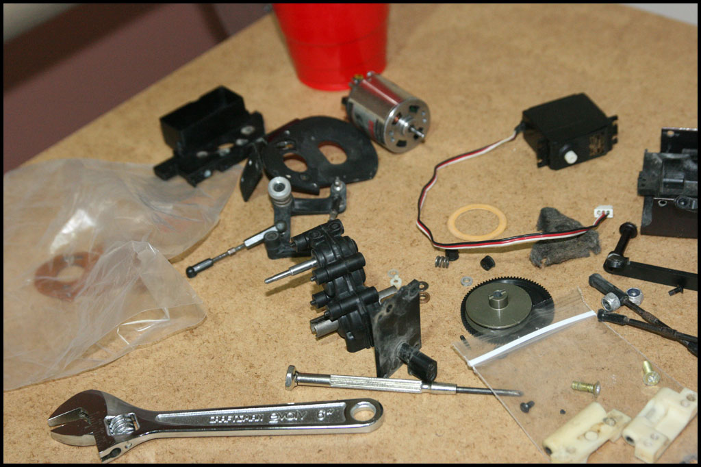

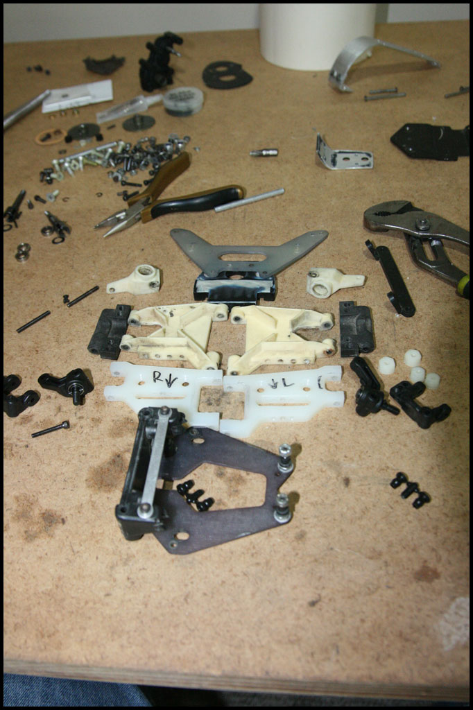

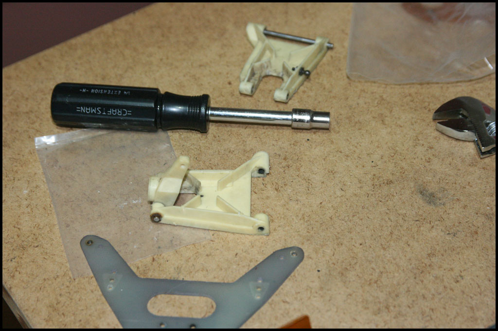

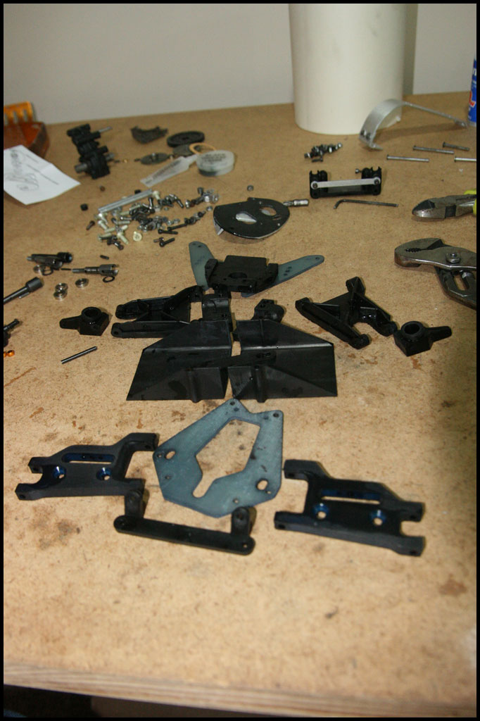

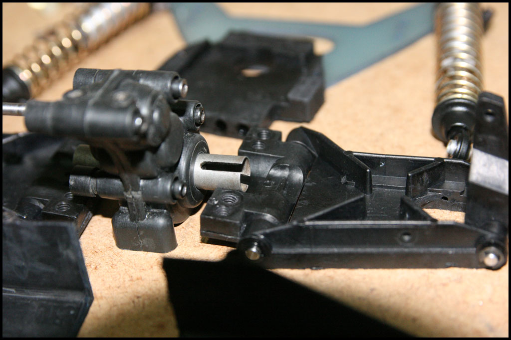

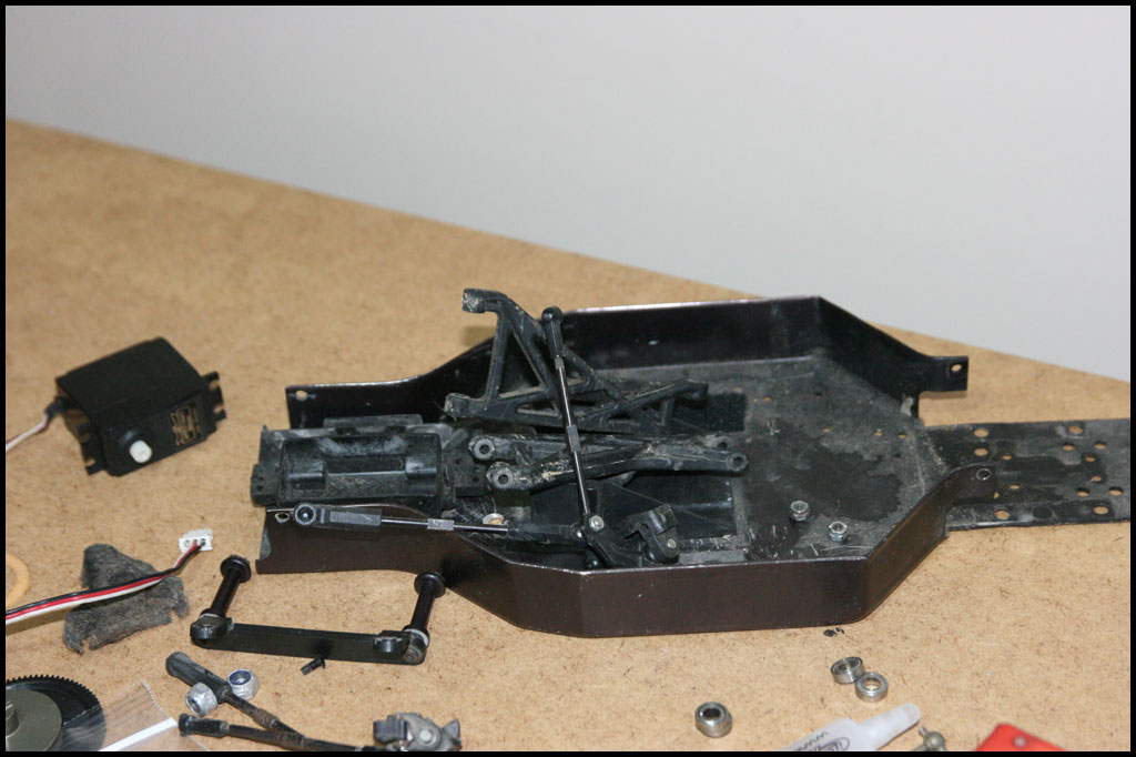

Here are some pics of sorting through parts...

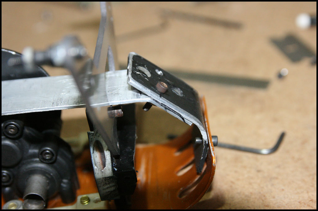

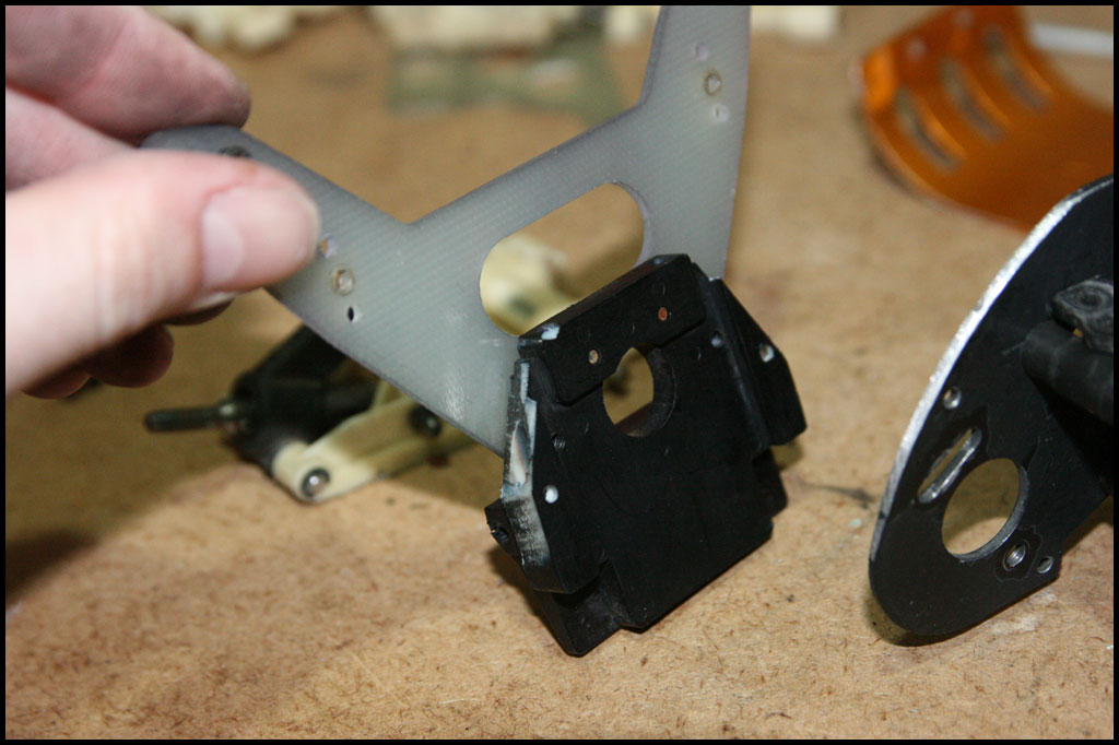

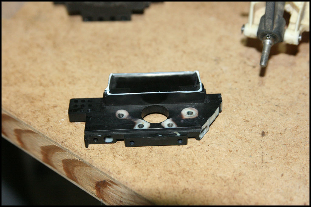

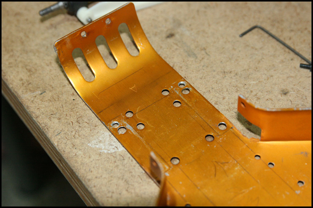

Starting to mod bulkhead...

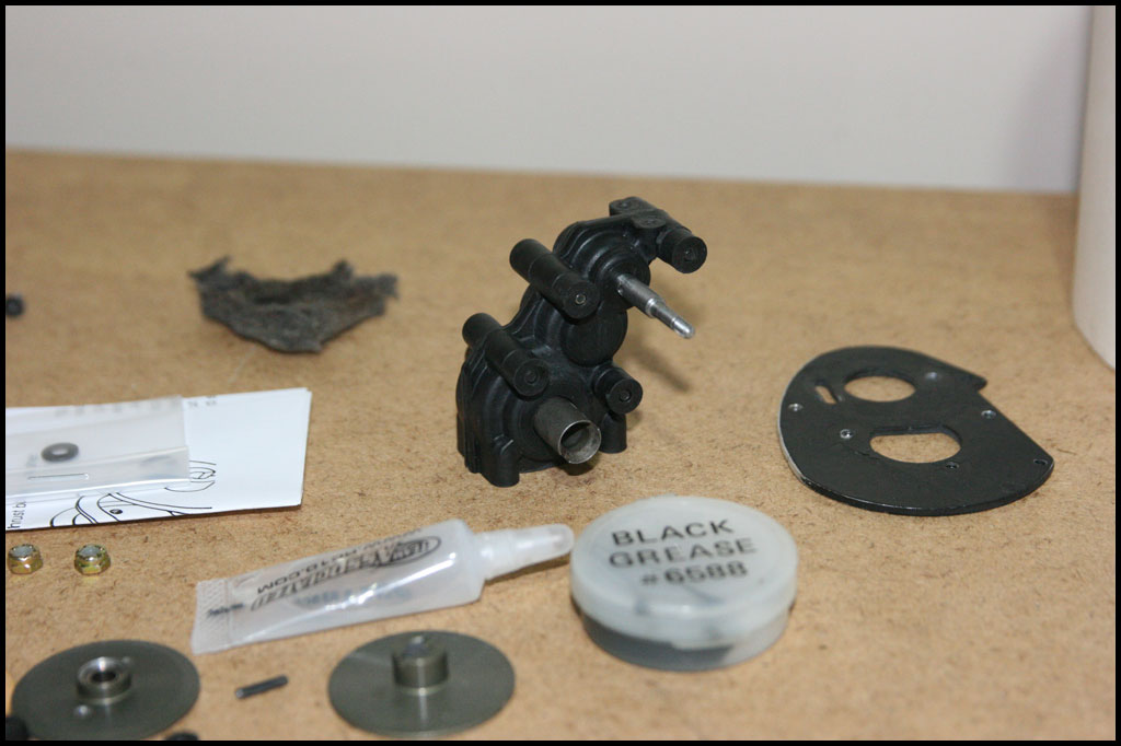

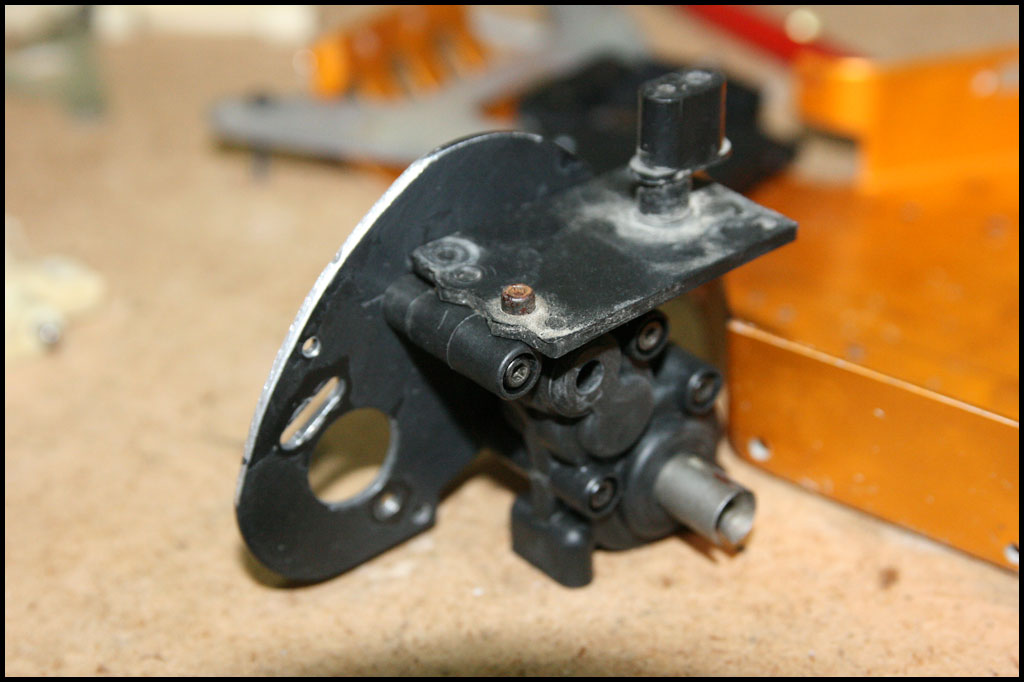

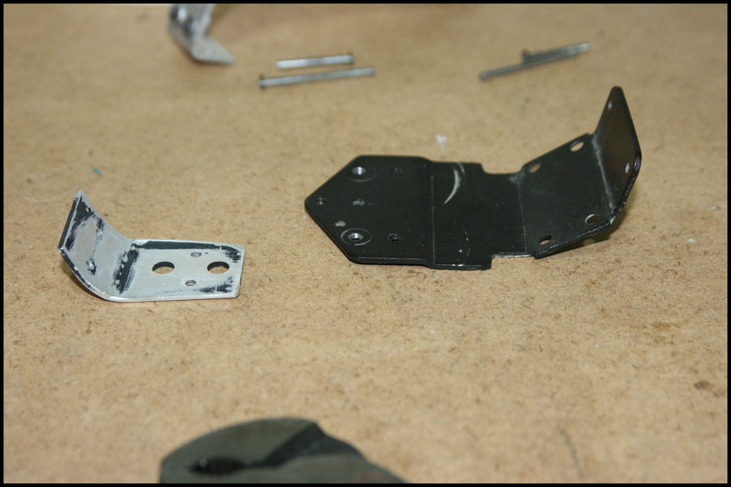

Modded motor plate on the stealth...

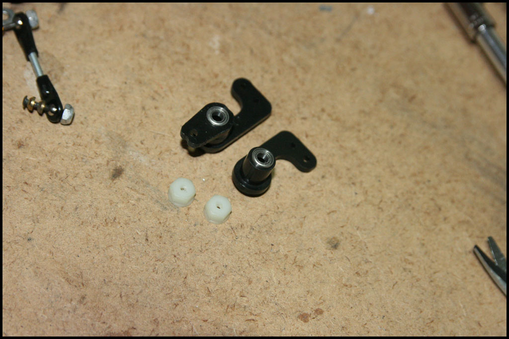

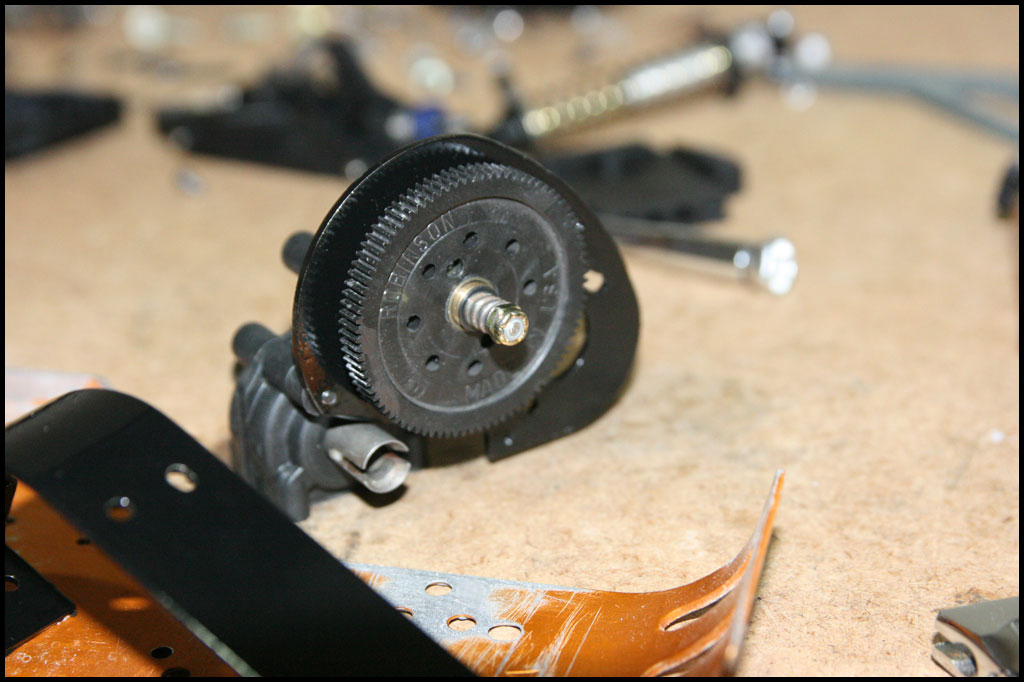

This is a set of Kyosho bellcranks with 5/32 x 5/16 bearings. Worked perfectly but broke after a small crash...ended up with a set of NixConcepts bellcranks.
Bearings loaded up

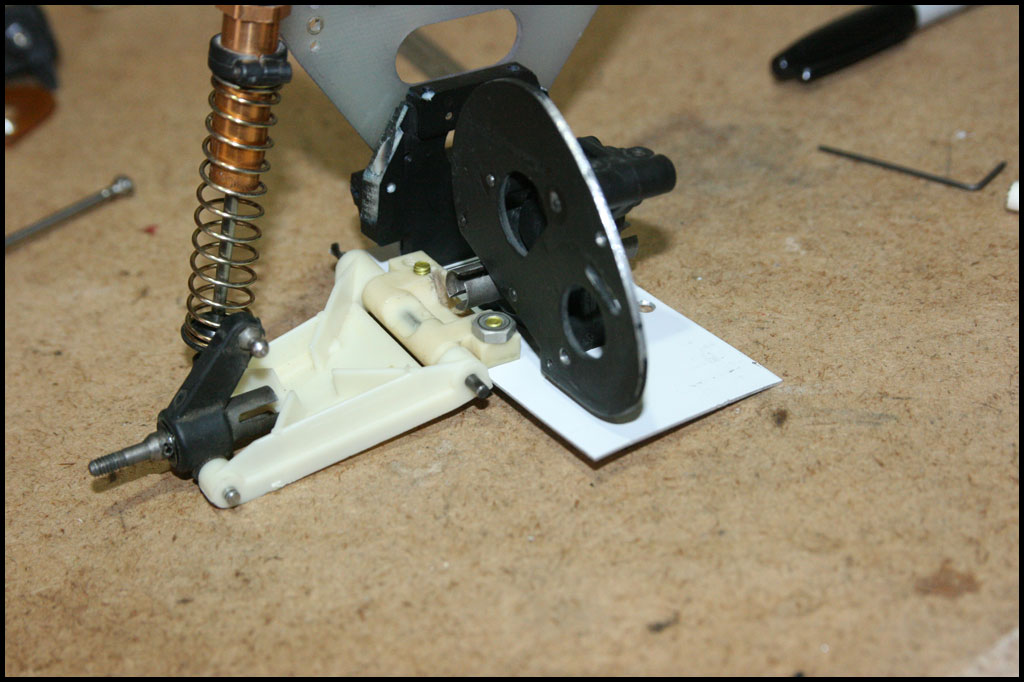

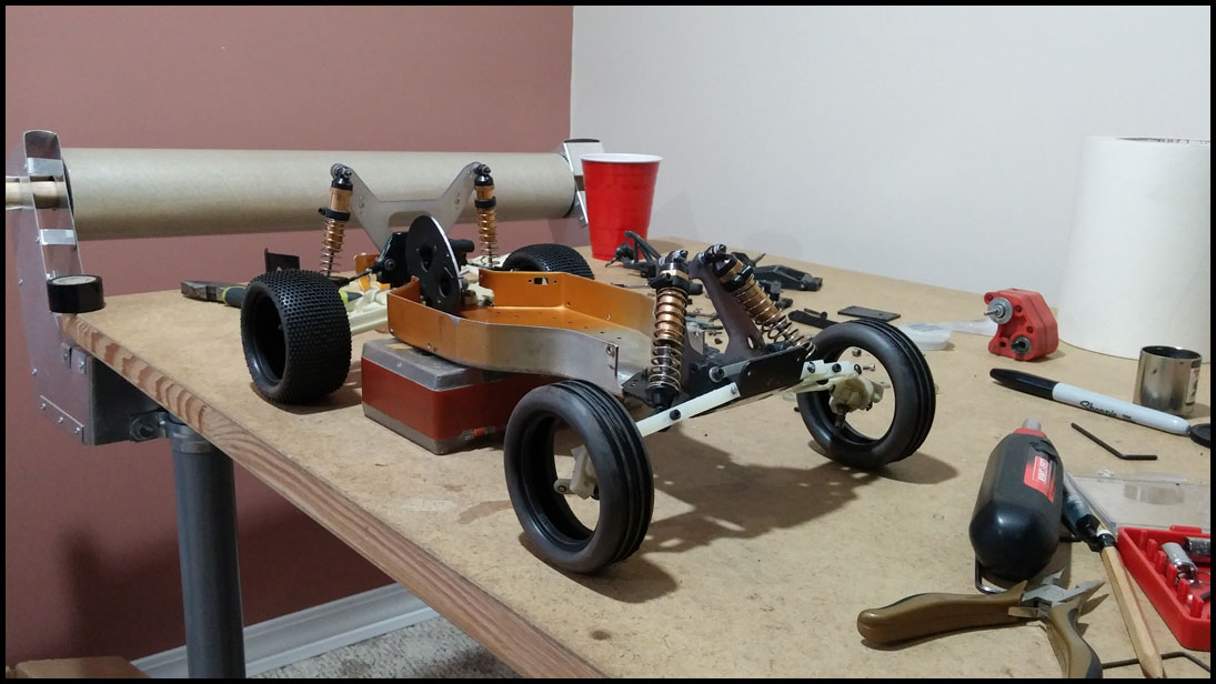

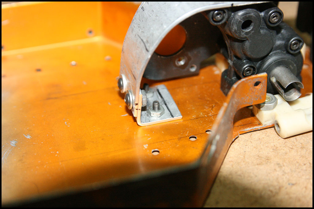

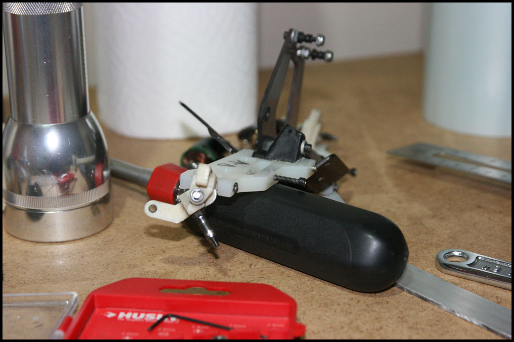

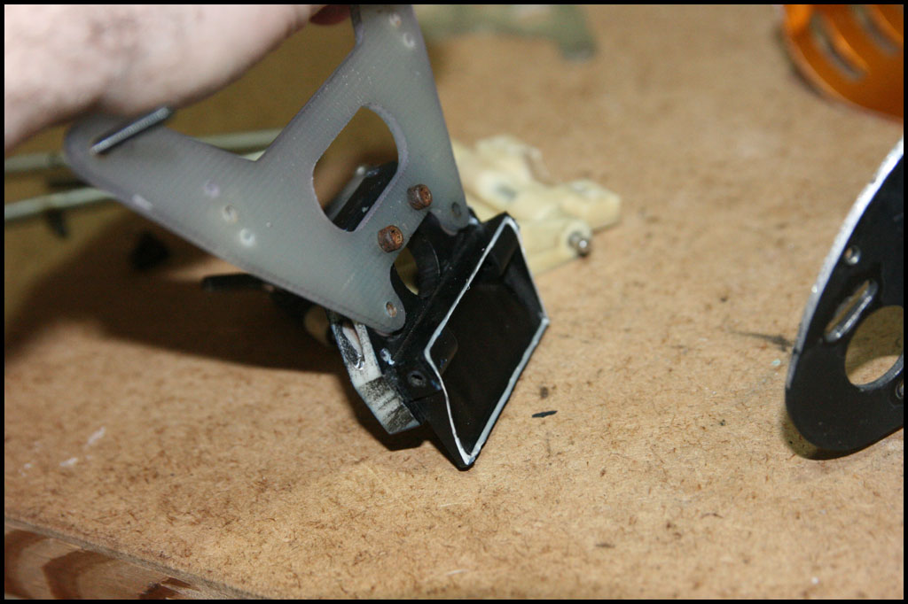

Mocking up how I'm going to mount the trans on some scrap metal...

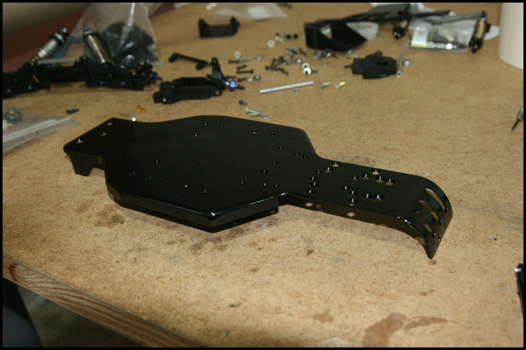

Laying things out on the chassis...It's an A stamp which is what I wanted...(luckily I had that B stamp pictured above too - more on that later...

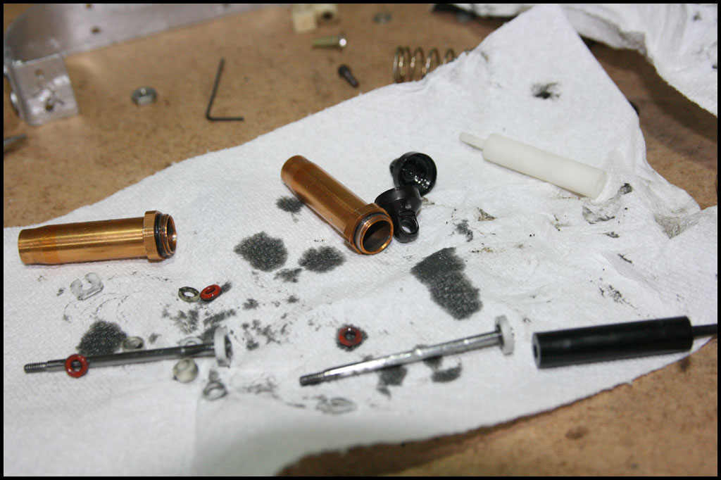

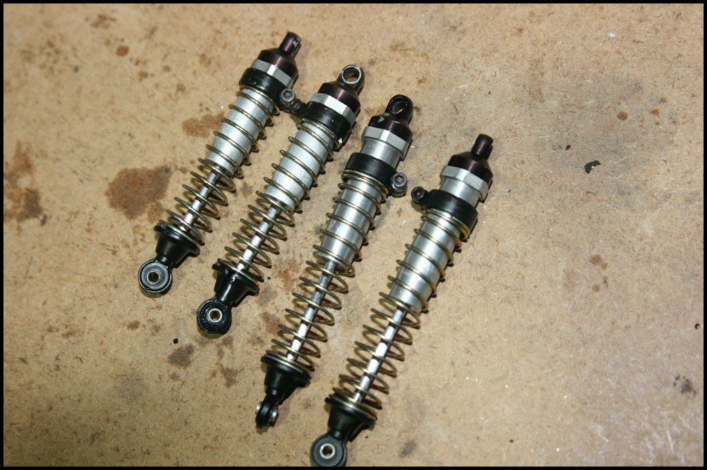

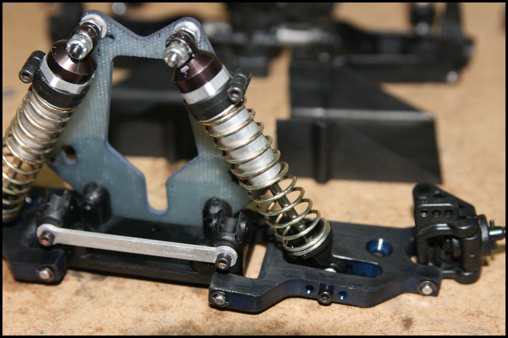

Rebuilding T shocks

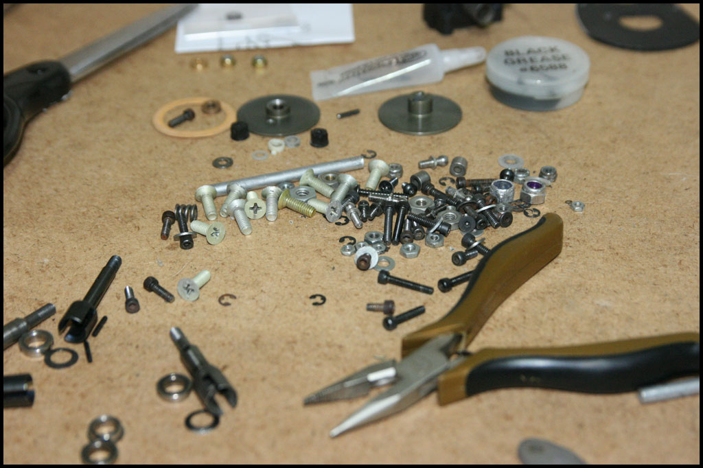

Various hardware being sorted...

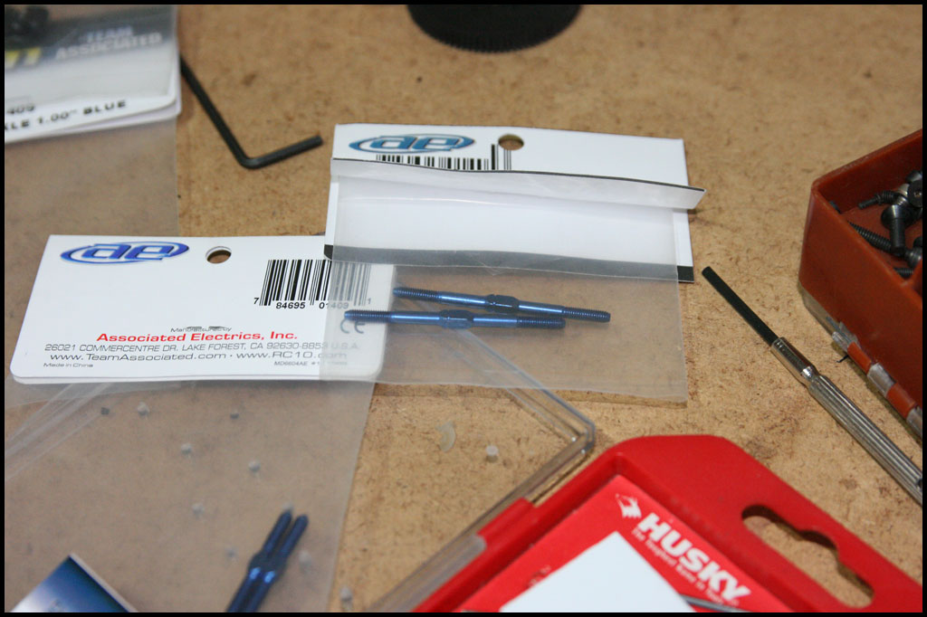

Some new stuff...Bumper, bearings, turnbuckles and rod ends...

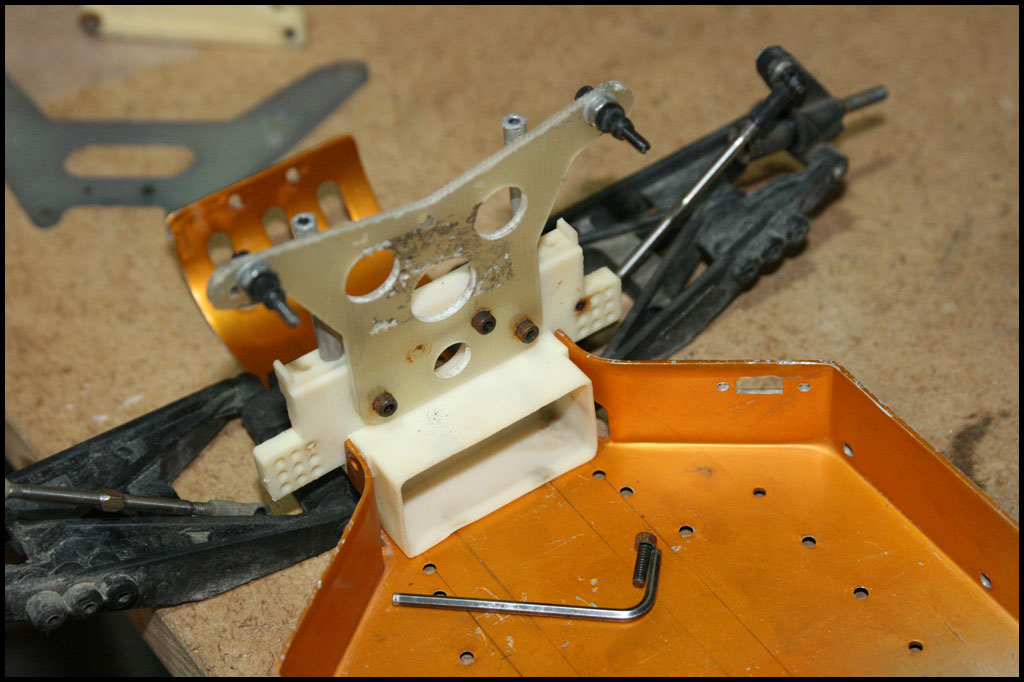

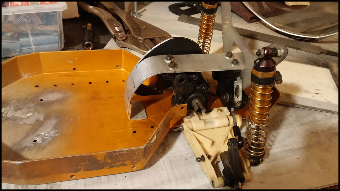

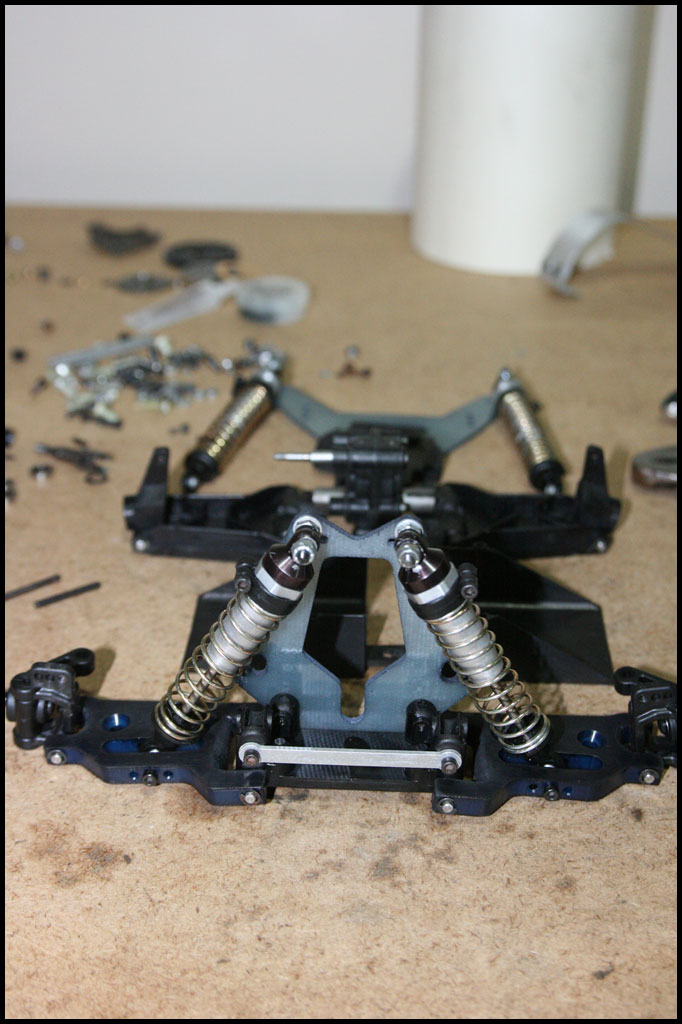

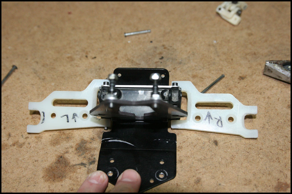

Got everything layed out and starting to mock-up

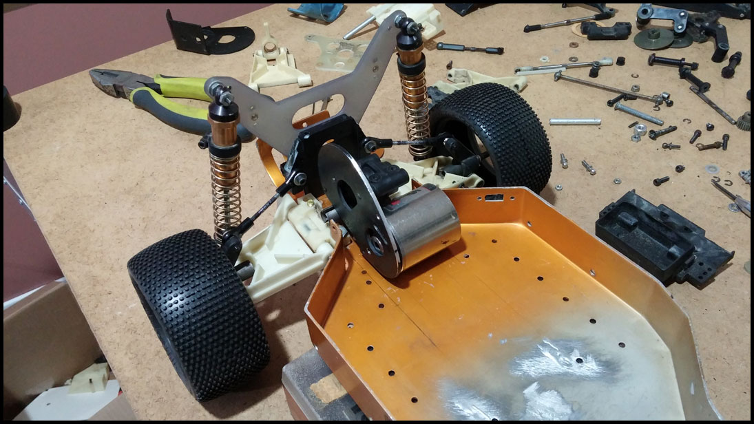

I think this was initial setup before starting to make the chassis brace. Before knowing stock arms weren't gonna work because I only had the tires! lol

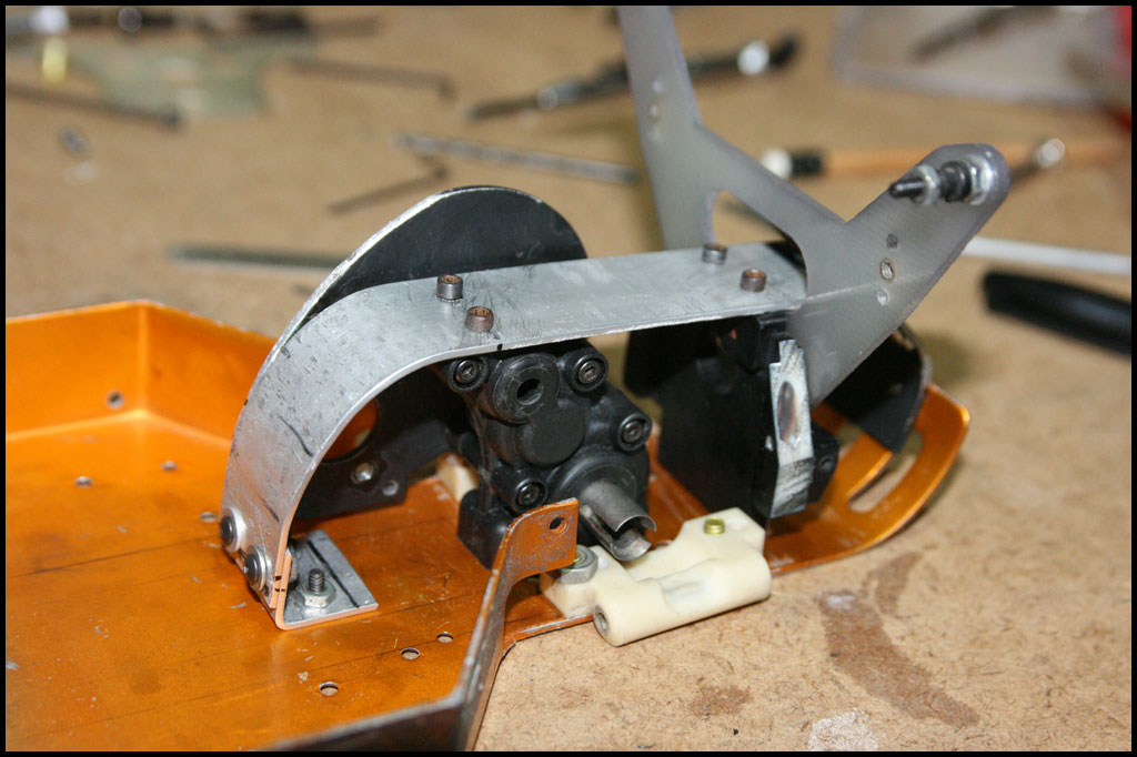

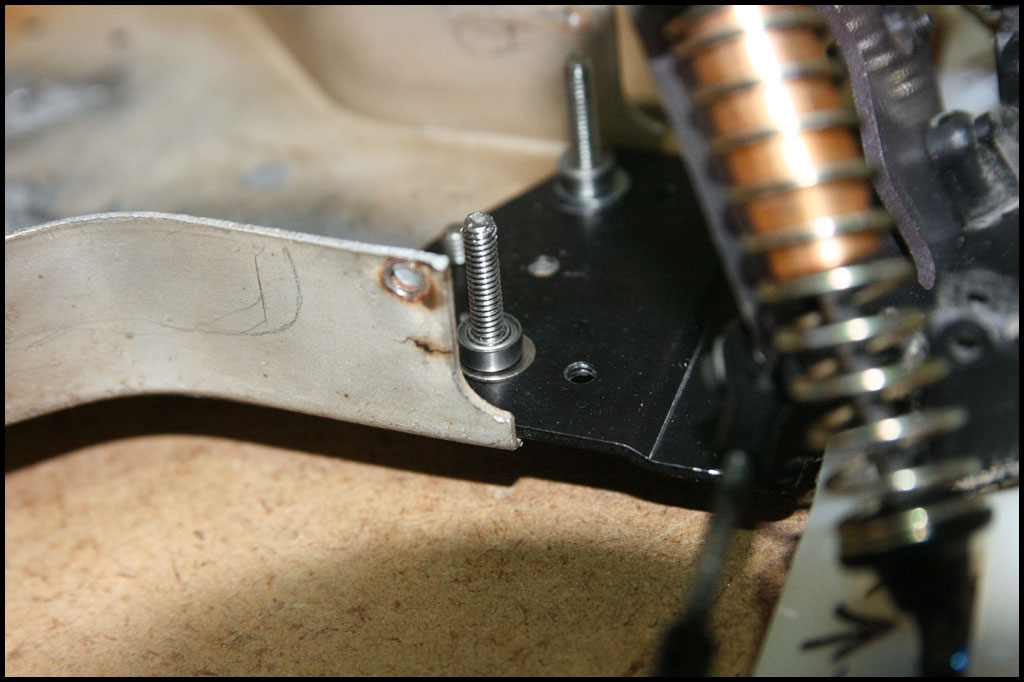

Then the brace set in place (it's 2 pieces)
Then everything drilled and mounted...
My brace goes all the way to the back of the car mounting to the curve of the chassis sort of like the stock motor plate does...
Mocking up with a T rear tower because I wanted the brace to go all the way to the back. I ended up setting the rest of the rar up with everything from a T after realizing the stock arms weren't going to work with the B4 hex wheels I got. It's not as bad as I thought with the B4 wheels cause they sit in real far but it's still a bit wide for my taste. I got a custom T inspired rear tower made and some 3d printed arms to bring everything back in. Additionally, the dogbones are a bit short so finding the right length dogbone is the challenge (still haven't resolved that). I initially shimmed them for first drive but it ain't right. lol
mid chassis, trans, bulkhead and rear chassis all tied together.

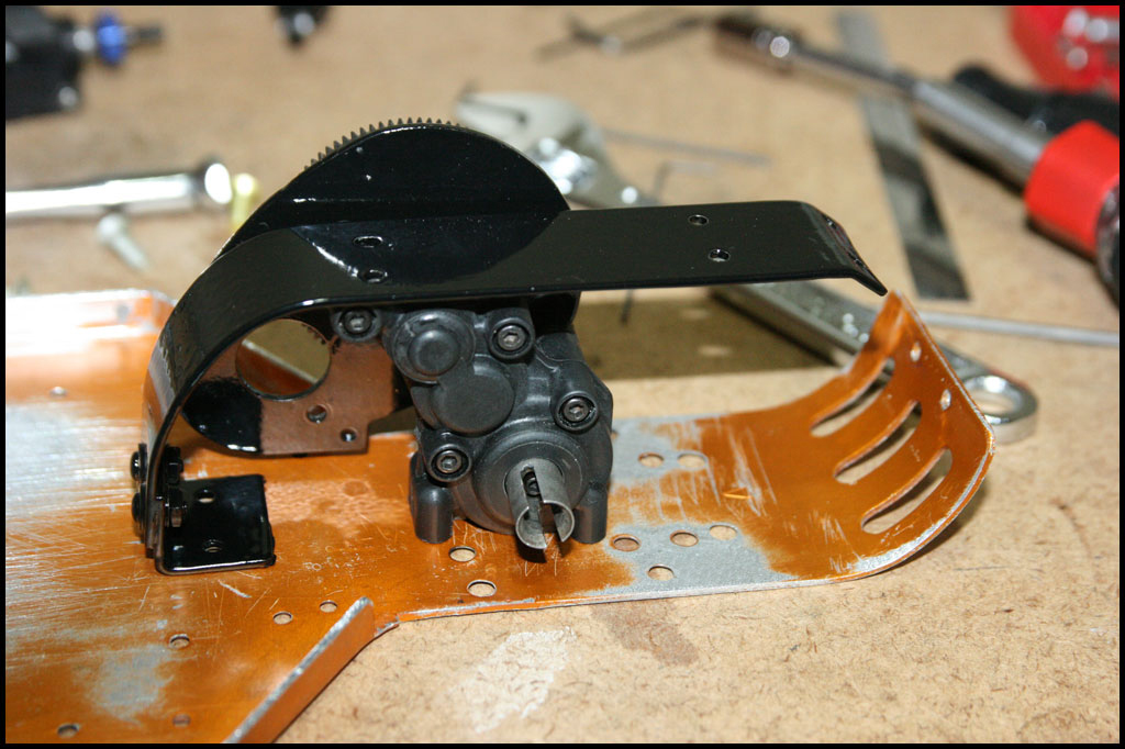

Final shape of the brace before powdercoating. After seeing the awesome brace for the NIXM I might tackle doing up a 3d printed version to fit my setup...but we'll see.
You'll also notice how far the trans is forward...as a high speed runner I'm trying to minimize the tendency to wheelie. I've also mounted the rear tower far rearward because I wanted to mount the shocks facing forward like the modern AE buggies.

Brace powder coated

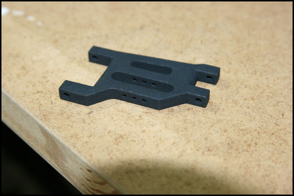

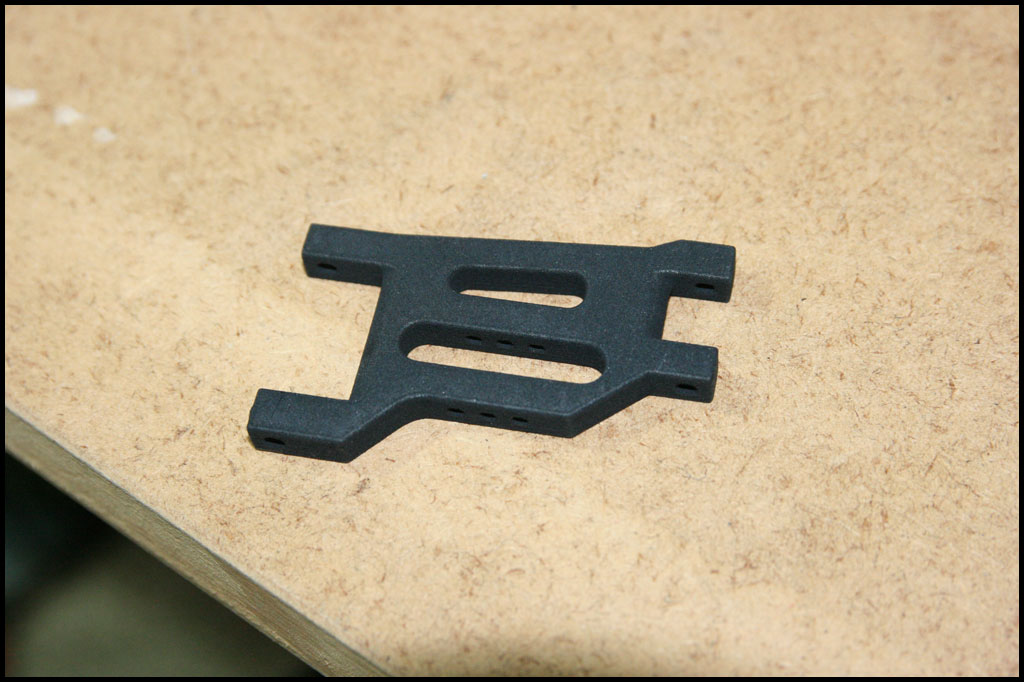

Front end together...(with the klein arms)
My 3d printed front arms. Modeled after the Klein versions...a little nicer looking though...
