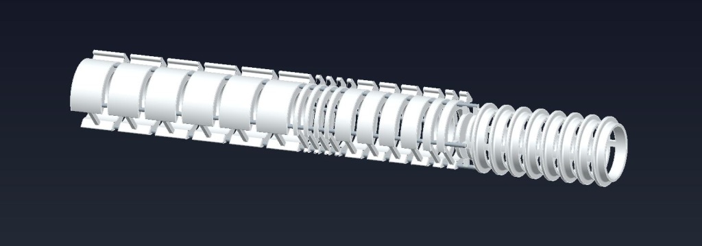

my guess would be that as the plastic cools, it contracts, so the open 'C' of the clips all arranged in order moves around quite a bit as it's being layed down, leading to shifting of the parts, making them skew. might need sprue to close the 'c's keeping everything from changing dimensions. It could also be that the stresses generated are cracking the existing sprue.

Niki wrote:Shapeways informed me they have problems printing "Shock Prep Set". Print success rate is now less than 80%.
I did not get informed what exactly is the problem. Those who ordered this set, can you identify that for me?
Maybe sprue is too weak and parts will get loose and lost? I'm going to pile these parts in a different way and update shapeways item soon...
Current version looks like this:
Hiya Niki
in my collar set the inner c part had to be cut clean off and the print made mine almost one piece.

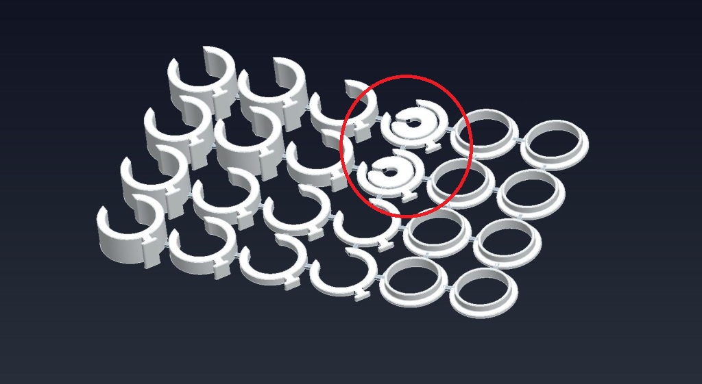

New version available now... should be better for printing, cleaning and polishing.

I should probably go through all part sets with sprue design involved and make them even stronger. It would minimize the risk of loosing parts in Shapeways polishing and handling process. I quess we would see less delays in production.
......Shapeways seems to have now new design guidelines for parts and sprues. It means a lot of work for me.
I think I'm not going to offer small parts polished and/or dyed in colors anymore. Big parts like arms are easy to get through polishing process.
I will make a list here which items are OK:
-NIX63651 (new stronger sprue, updated 2014-11-24)
-NIX91-Steering Blocks SLS (new sprue, updated 2014-11-24, only white and black available, not polished)
-NIX91-Steering SLS (new sprue, updated 2014-11-24, only white and black available, not polished)
-Stealth Shock Prep Set SLS (no sprue, all parts are in a loop, updated 2014-11-24)
