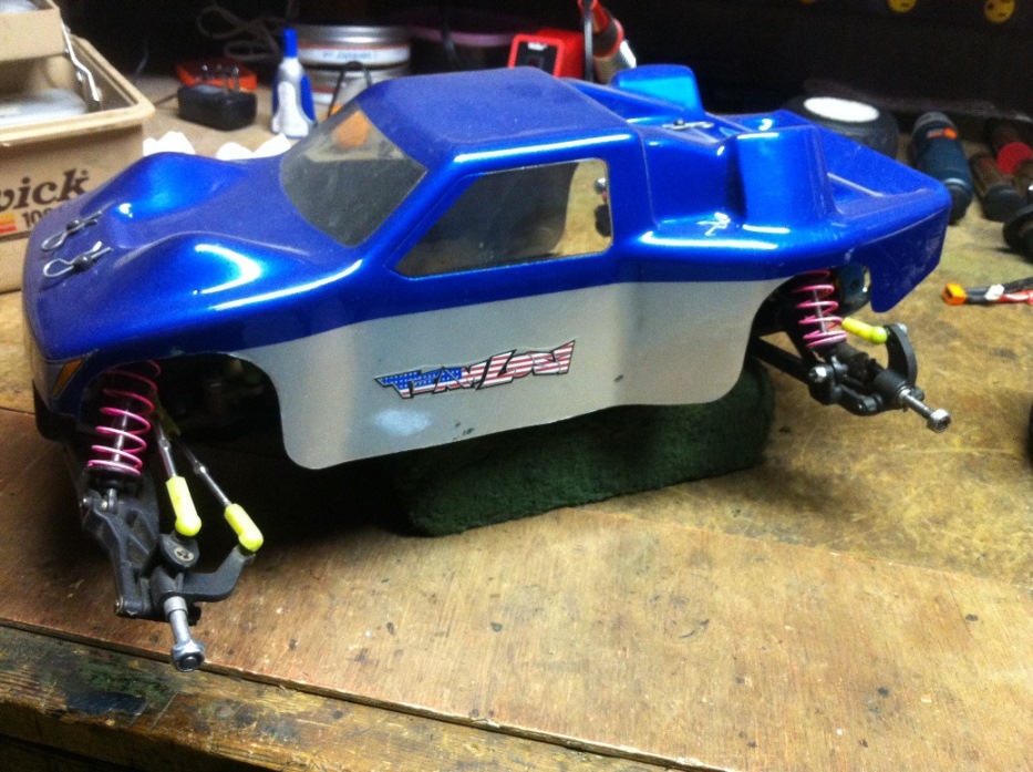

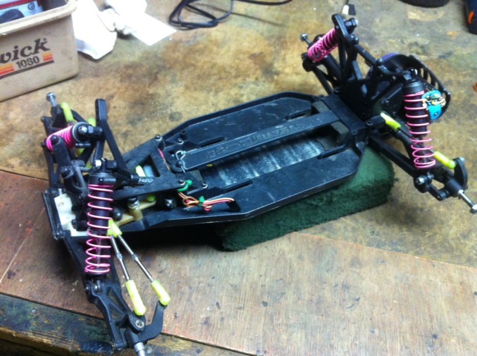

A few local RC clubs/businesses are putting on our 4th annual RC swap meet this weekend and for the first time, we are going to have a scale crawling expo and a carpet off road track set up for racing. I have raced carpet oval and I have raced off road. Never really at the same time. I'm thinking of racing in the 2wd open buggy with a Jrx2 or XXcr and open stadium truck with a JrxT-LXT hybrid or a XXT Sport. It will really boil down to which vehicles I feel more comfortable with on the track. I have my tire choices sorted, but my question is: what is a recommended setup for carpet off road? Is heavier shock oil necessary compared to dirt? How low should the ride height be? Should camber be set to 0? I know a lot of it will depend on the track and each vehicle will require its own tuning, but I need a starting point and I'm thinking heavier shock oil, lowered ride height and 0 camber. Also, I know I will need added weight up front. Thanks for any input, and here are a couple pics of the XXT Sport for attention.
