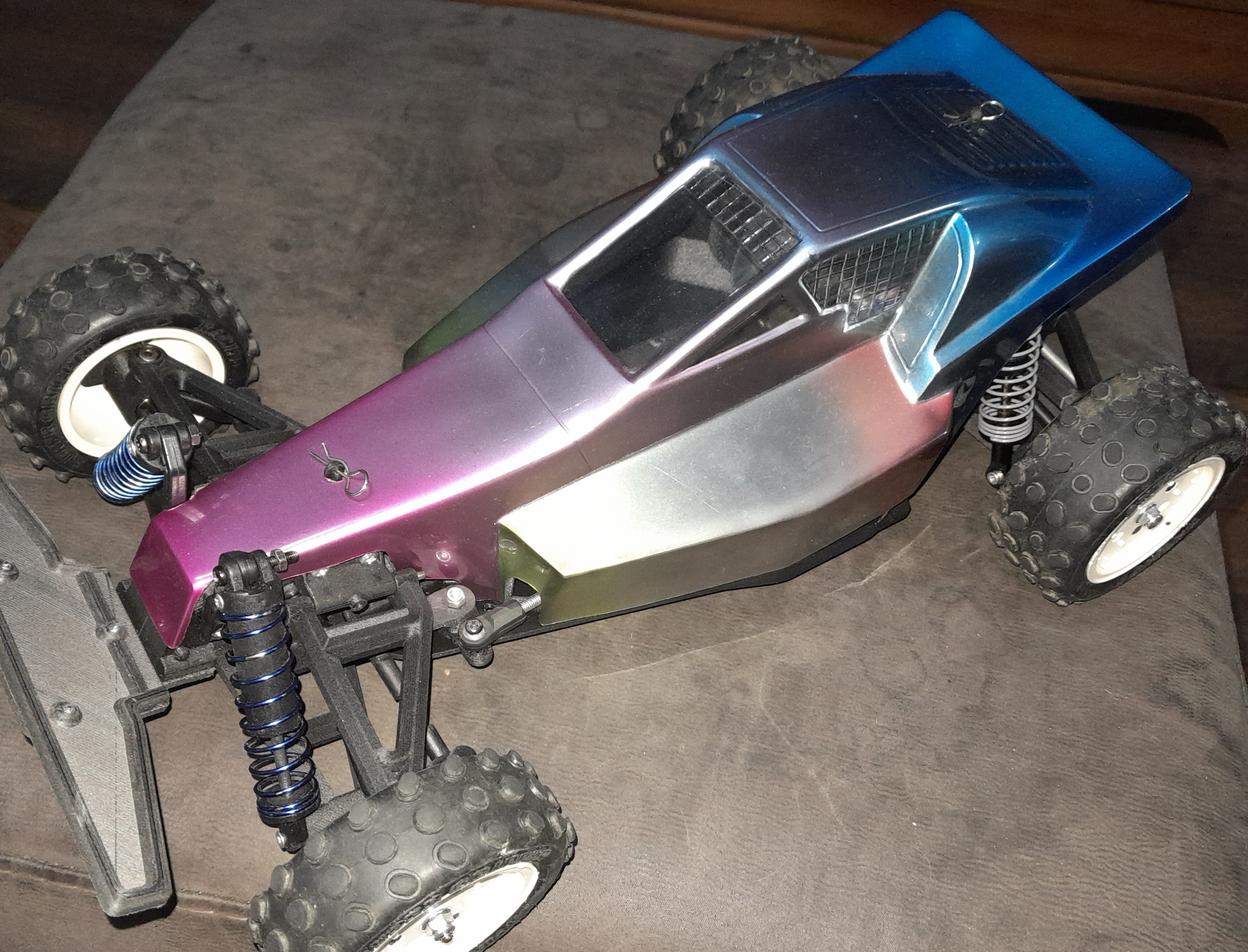

The Mini Mustang is coming along .

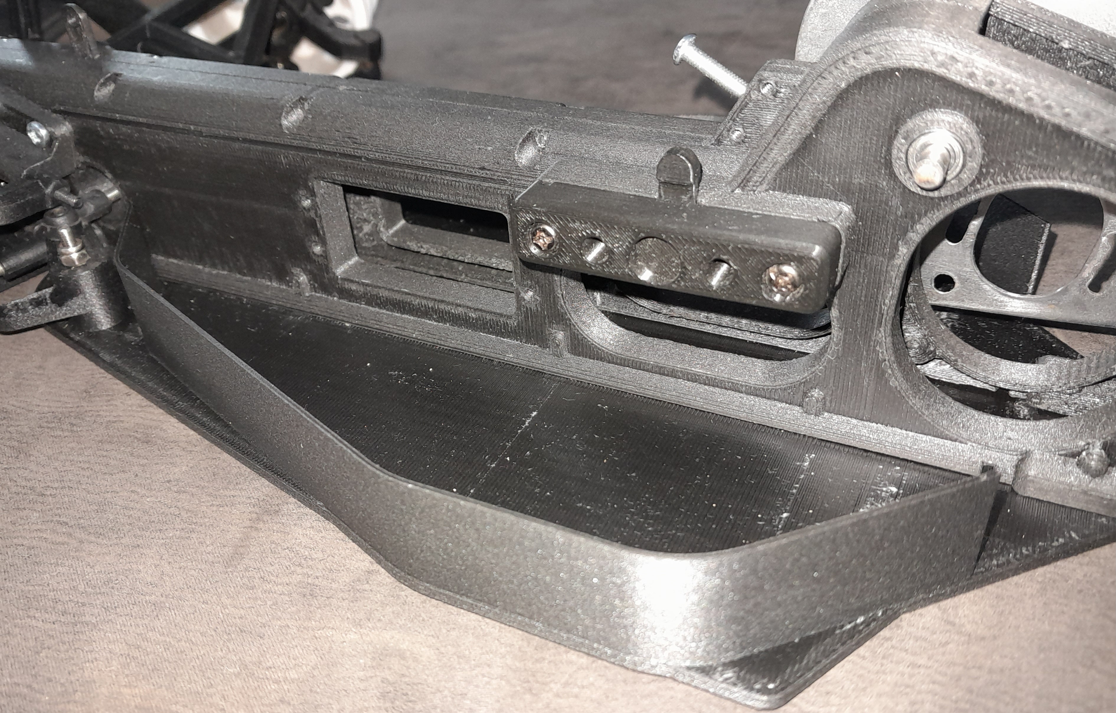

Drew up the steering components and chassis plate for the Mini Mustang , I combined the chassis plate with the under tray that's usually a lexan part, printed in PA6 CF Nylon for the steering and the plate in PETG CF.
The chassis plate once fitted makes the whole thing very rigid. After printing I added cutouts in the under guard sides for battery and steering rod as I'd missed them on this version , easy enough to cut out as you would in the lexan version.If a jobs not worth doing then its certainly not worth doing well.

This Mini Mustang is just about done , modified to use Hotshot diff bevel gears , dogbones and axles .
Servo and motor are fitted just need to fit an RX and ESC and it's test drive time, I'm not sure if the suspension arms will hold up in home printed PA6 CF Nylon, where the inner arms meet the suspension pins they are quite skinny , the original material is very tough and flexible , nearest material I could print them in would be Polypropylene and I've never used it , by all accounts Polypropylene only really likes to stick to Polypropylene ....
- Posts: 3878
- Location: Guildford UK
- Has thanked: 2300 times
- Been thanked: 2002 times
Re: Dadio's 3D Printing Stuff
Took the printed Mini Mustang for a drive today , disappointingly the Hotshot diffs don't like being under tension from the belt , with enough belt tension not to slip it virtually locks the diffs I'm thinking of ways to solve this , its down to the different out drive designs , the genuine diffs have a sleeved screw holding the outdrivres together but the Hotshot only has a loose pin to keep it centred , I'm sure I can solve it for myself but it's a bust for making an easy conversion part for other people .
