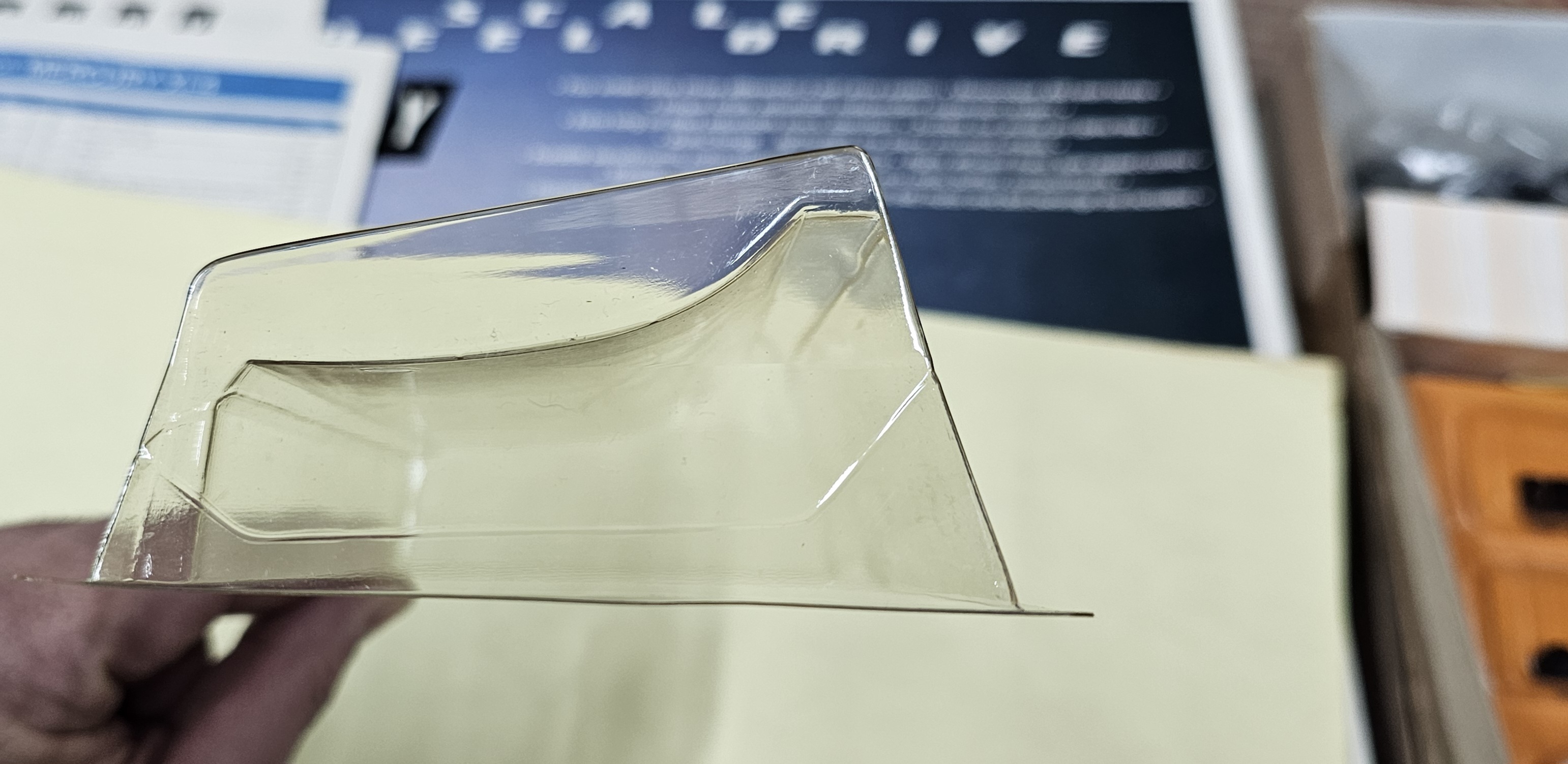

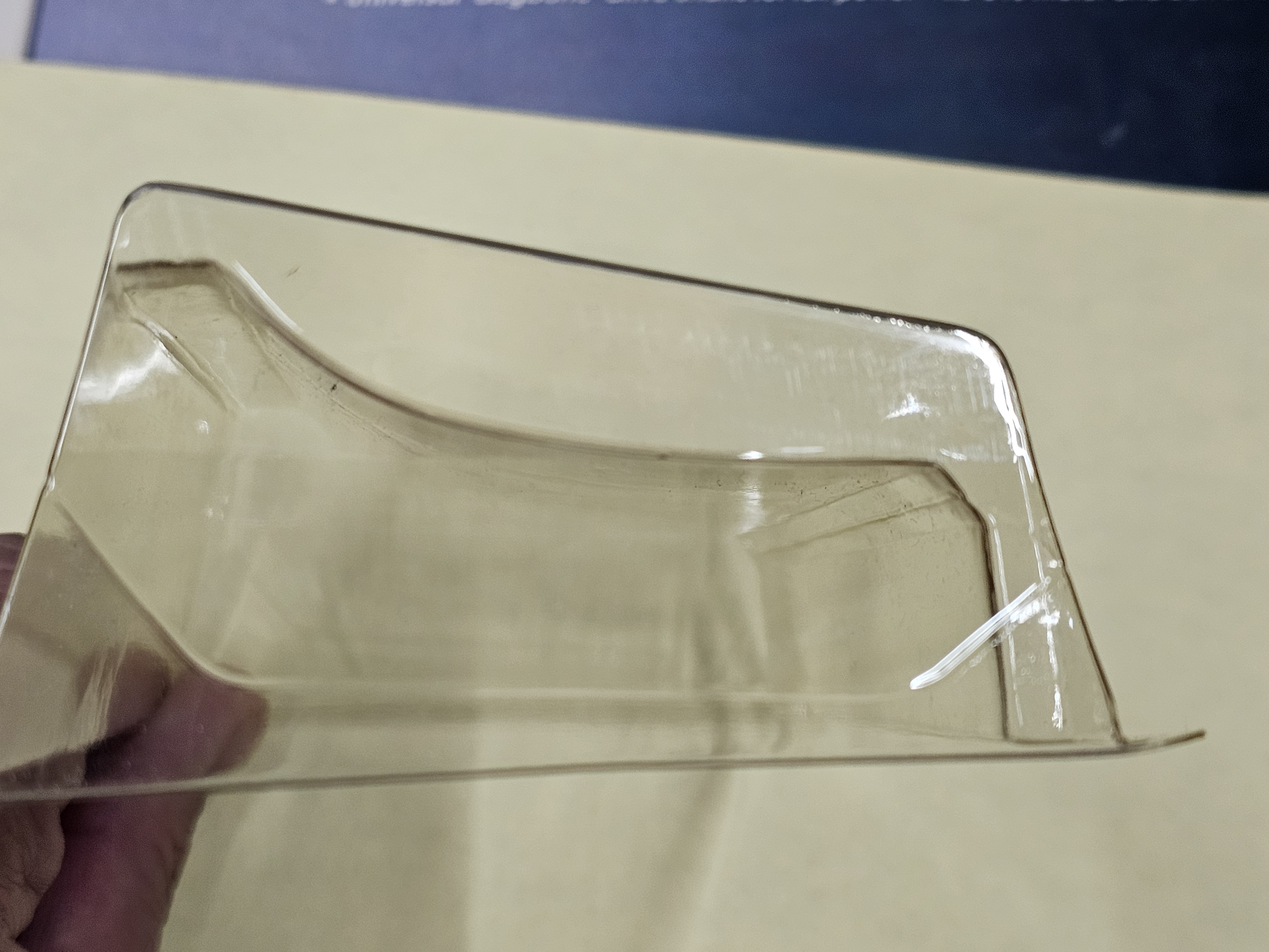

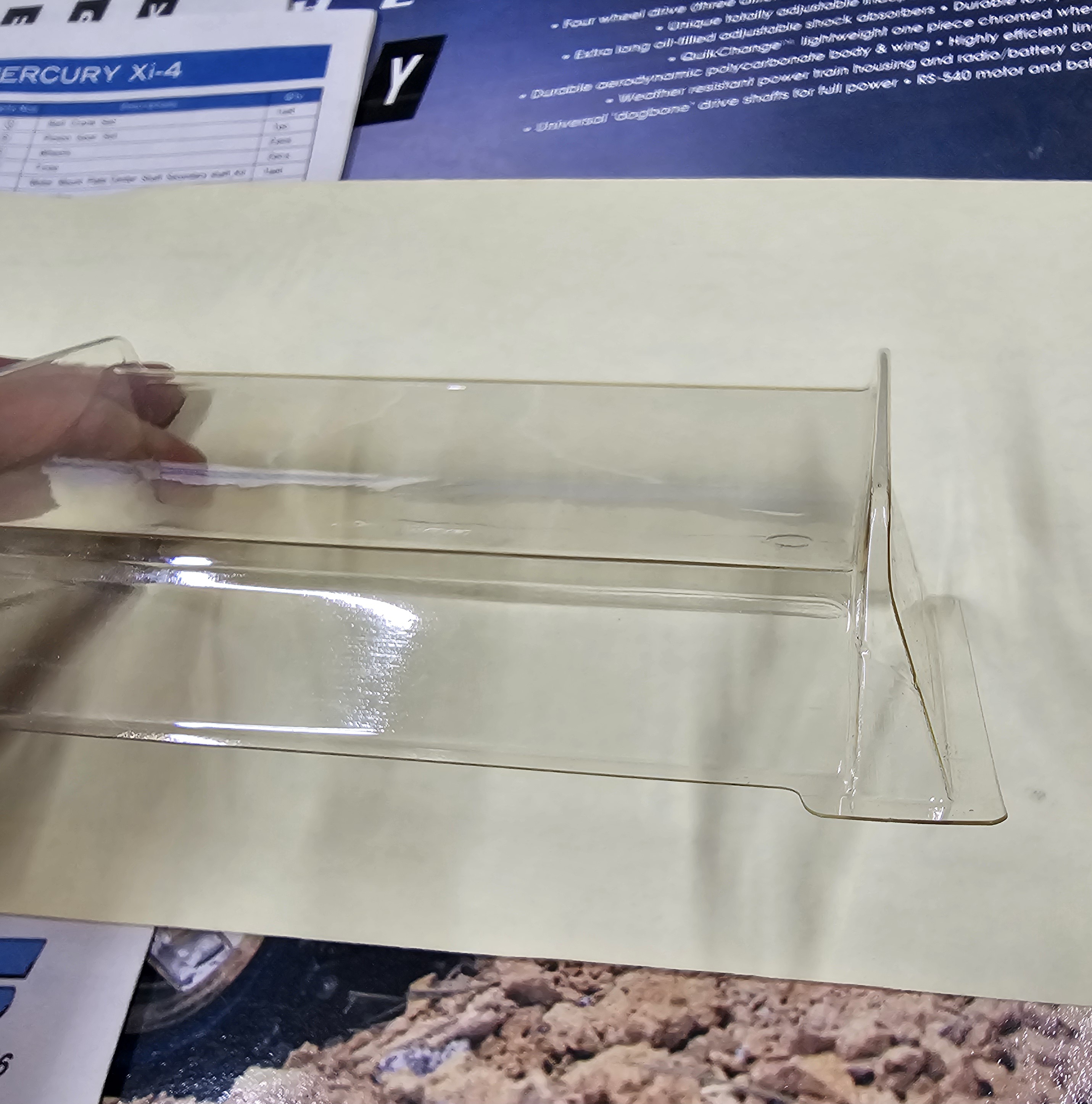

I also first thought the wing end plates were bent from storage as well, as you can see on my original wing here
But it shows the bends in the sides in the manual
I guess I'll have to change the wing, or to make a second one, with the angles. The fact is that car was sold under Mugen, Academy, Ryuz and Graupner. I've not seen much of Academy and Ryuz pictures, but it seems that the Ryuz one had a different body, a metal undertray (and no lateral decks), and potentially a different wing from what I saw. And I'm affirmative I saw some Mercury with no angled sides.
The fact is as well, manual don't necessarily gets updated when change in production occurs for a reason or another (I have seen some examples of that in some other cars, where there is clealy at least 2 different versions within the same brand and there was no update of the manual between V1 and V2 - although the changes were there and clearly visible although not impacting the build). And here, while there was four versions of this car, I always only saw the Graupner manual online... Not that important anyway, as change wise this is quite easy to deal with in CAD...

Not sure if this helps. Very hard to photograph and get that line. Mine is the World Engines version (Academy)

Following @terry.sc and @GoMachV indications, I modified the wing...
