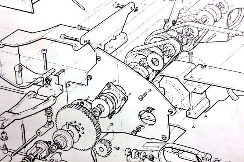

Anybody got a diagram or photos they could share of this arrangement? Never seen one before and it sounds intriguing.

DennisM
Posts: 2403
Location: Denmark
Has thanked: 30 times
Been thanked: 64 times
Re: CAT XL
Post by DennisM »
Here´s a picture of Paul´s diff from the manual :-)

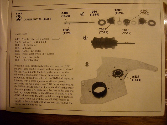

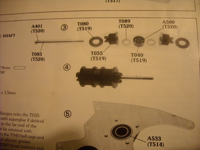

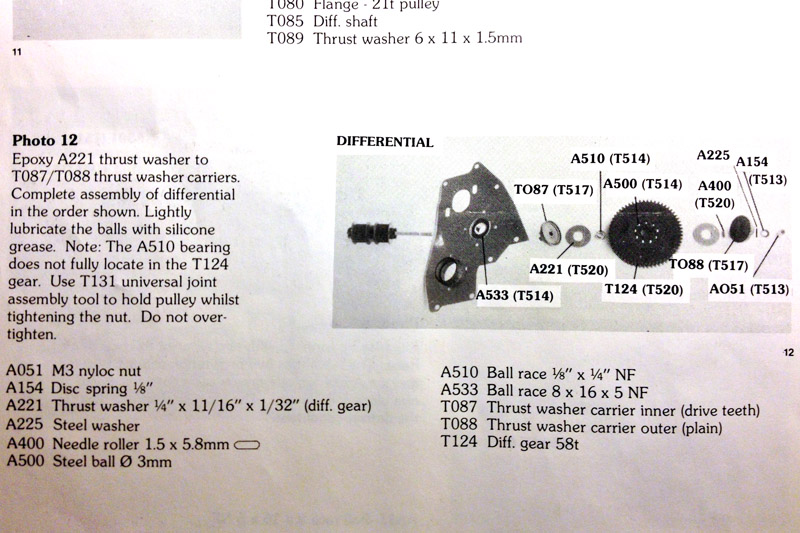

Here are two excerpts from my instruction manual. I will happily scan the whole thing if anyone needs it. Im not sure if it is any different from others, but if you need it, let me know and I can do a pdf.
