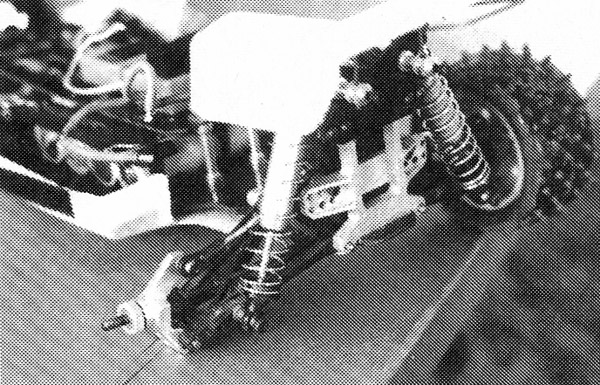

Could it be you made that alu part 'cause that's what's in the single picture of Joel Johnson's proto-type mid motered ultima?
and to correct : brushed moters are sensitive to reversing. First of all you need to physically change the the timing by turning the endbell about 15 ° and secondly you need to true the collector and put fresh brushes on if it's a moter that was run in the normal sense before, and then switch the leads , or turn the endbell 180° on top of the 15°
PS: I like how you used the mid front carriers, steering knuckles and wheels. I never understood why this wasn't a more popular mod in it days.
Thank You Mr Ed !
Yes it is me to blame for destroying a nice block of alu.....I put it up in the mill and 3 hours later it fit My Turbo Ultima Mid.
I did not know mister Joel at the time and never saw any part like this....so i will try to find a pic...or if any body on the excellent
Forum know any thing of this i will be happy.
And thanks for the motor info. I will make this beast fly soon.......2012 VINTAGE OFFROAD NATS - BRCRO - 9/14-9/16 It is not far from where i live.

Just to share what we discussed over PM: I guess the main reason for the aloy part would be to obtain correct caster and toe-in.
I live very far away from NYC, and even further from the event, but I'll read the tread if you make it overthere with this buggy

Mr. ED wrote:Just to share what we discussed over PM: I guess the main reason for the aloy part would be to obtain correct caster and toe-in.
Yes Mr Ed.
My memory is coming back......Ooh what a buzz. Your guess is right...caster and toe-in that's why i made the part.
and Mr Joel's aluminum is different and much nicer.

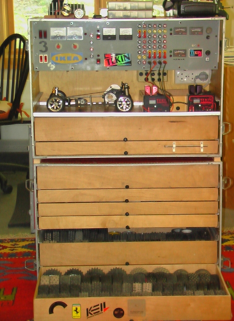

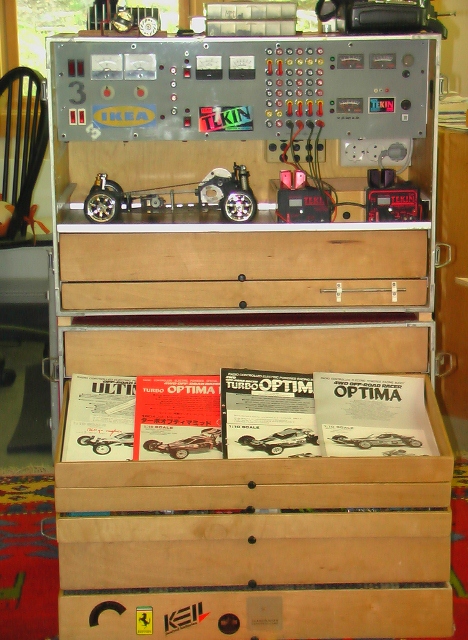

Picture time !
Alien !!!
Alien !!!
Some reading
Some reading
Wheels
Wheels
RedBoxRacer™

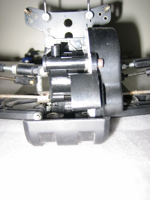

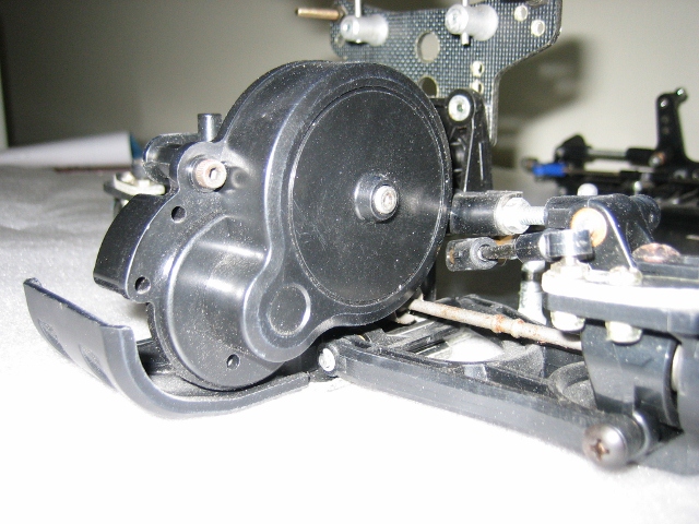

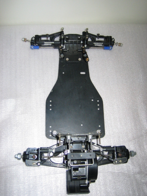

mmm, I need detail shots and a little more info on that top picture.
Which transmission is that?
Bo Wallen
Posts: 170
Joined: Wed Feb 29, 2012 11:54 am
Location: New York City
Re: RedBoxRacing
Post by Bo Wallen »
Mr. ED wrote:mmm, I need detail shots and a little more info on that top picture.
Do you think of the Alien photo ?

j0pp3
Posts: 425
Joined: Tue Apr 17, 2012 10:47 am
Location: Stockholm, Sweden
Re: RedBoxRacing
Post by j0pp3 »
I think I see a Turbo Optima Mid Special! The car that belongs to the red manual 8)
Cheers
Joel
j0pp3
Posts: 425
Re: RedBoxRacing
Post by j0pp3 »
Every red box should at least have one red manual :mrgreen:

Post by Bo Wallen »
j0pp3 wrote:Every red box should at least have one red manual :mrgreen:
RedBoxRacing got TWO !!! do i win ?
I went to the storage unit today.............i need to change the above number.............or ad two Turbo Optima Mid........So i got four red manuals ...and a shit load of wheels Yam yam....
They were hidden in boxes with other stuff like china plates wrong label on the box. It was a good day !
RedBoxRacer™
yes
Is it an astute or ultima actually?

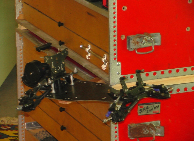

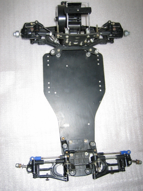

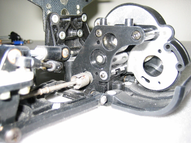

Yes Sir Ed. Your first guess is right, Sharp eye in did. I got hold of another camera so on up on Your request......Picture of the Alien
It might not suit this Kyosho forum to bring it in here. but i dare 8)
Alien

Hcp22
Posts: 1858
Location: Gothenburg Sweden
Has thanked: 33 times
Been thanked: 16 times
Re: RedBoxRacing
Post by Hcp22 »
Bo Wallen wrote:Picture time !
This brings back memories; I have help Bo carry his pit boxes many times! He was known as the guy with the red nuclear plant; at least he needed a direct line to one for power it up. :lol:
