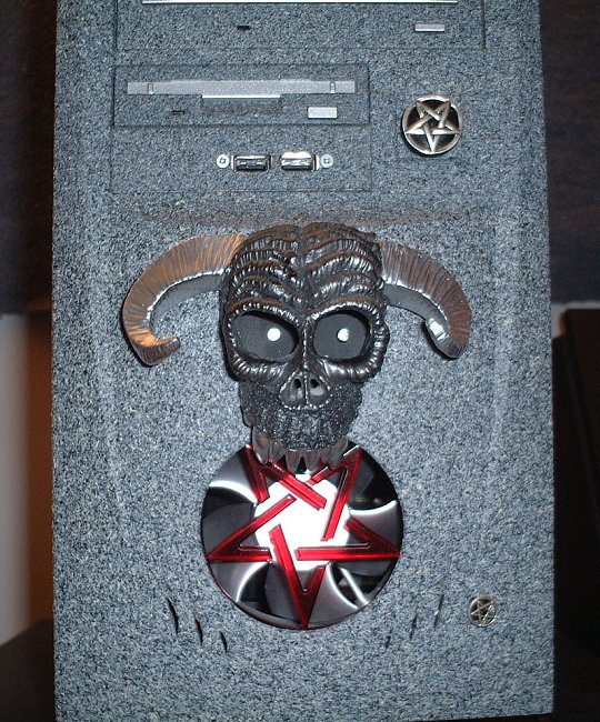

Honestly, I have yet to find a paint that provides a true metallic sheen like chrome or gold/silver foil. None of them end up looking like what you see on the cap. The caps are actually plated by a plater, not painted with the paint inside the can, so they cannot be trusted as true representations of the paint. I tried a Krylon Original Chrome paint in a computer case I modded years ago, and it came out relatively shiny, but nothing like the cap. I'd suggest it would never hold up to actual running conditions, only good for a shelf-queen.
I painted the drive bay doors, horns, teeth & fan with Original Chrome. It has a satiny shine to it, but nothing like the chrome-plated cap.
EDIT: Acetone works to remove most kinds of paint from nylon. I've found Easy-Off works even better. Both of those will attack plastic, though...that's why the acetone ate up your Tamiya parts. But it's safe on nylon.
