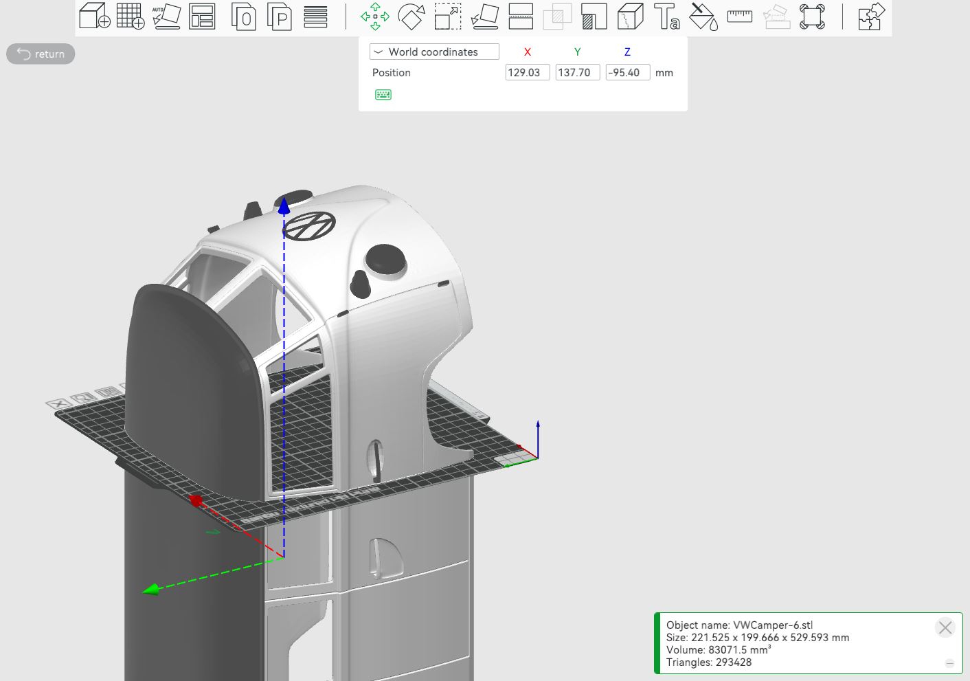

For a large first project, I went too big when I purchased this model, it was designed with a 313mm wheelbase, that's just over a foot in WB alone!
Scaled the WB to 250mm, or just under 10" to get it to fit on the plate.
Problem is, how do you print this?? Check out the amount of support material, it's more than the model :lol:
I tried to print it upside down, but it was a disaster, the rounded off shape of the roof wouldn't hold to the bed. Plus the top is the most important, or obvious feature.
Looks like I need to figure out how to remove the roof section, at the top of the windows, and print the roof in a separate piece.

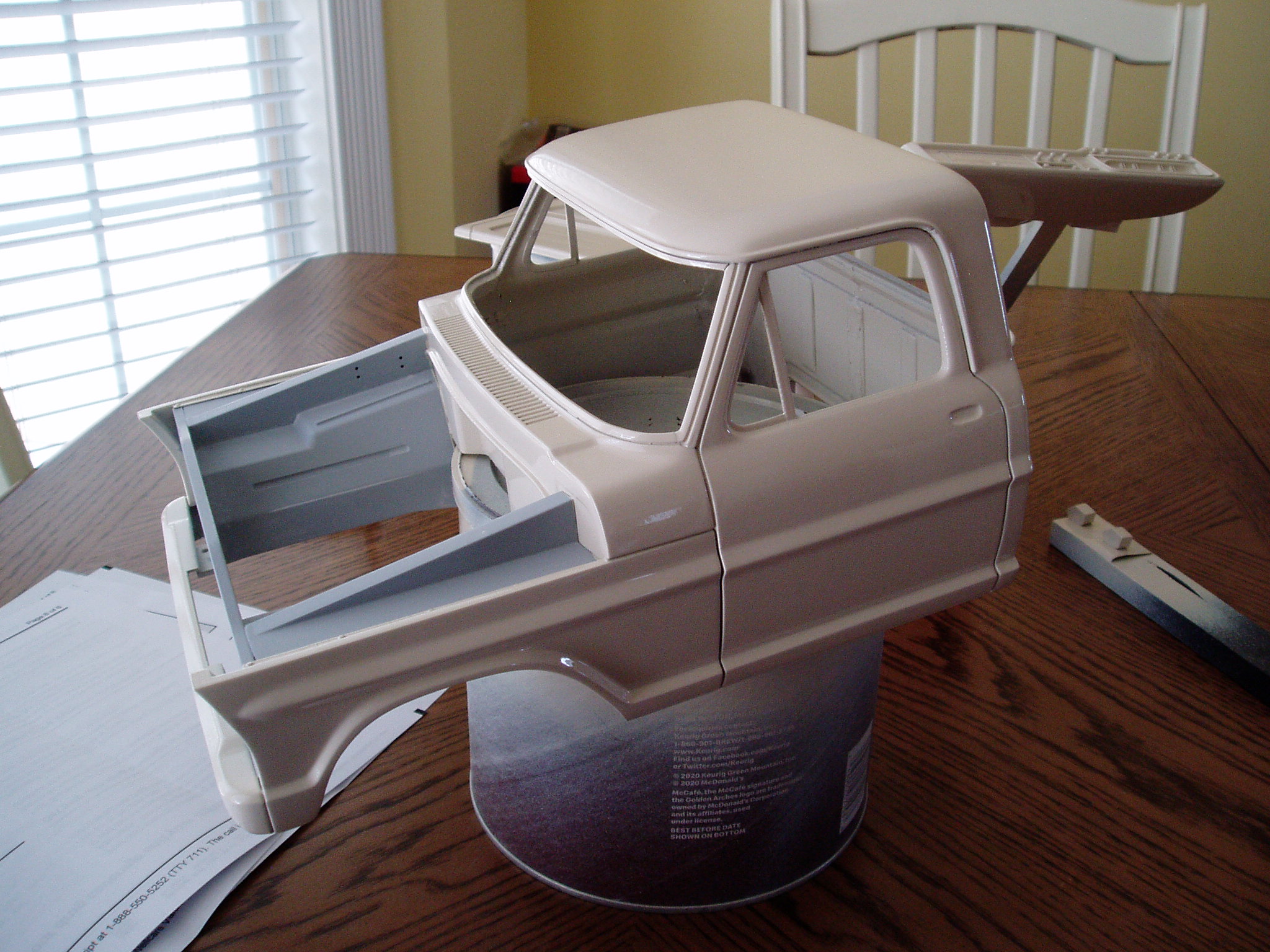

I ran into similar orientation problems with the F-100 and ended up separating it into panels (doors, roof, back, cowl, fenders, etc.) and making custom supports for each part. It's a lot of work but it was the only way I've found to make acceptable prints and reduce filling and sanding to remove layer lines.

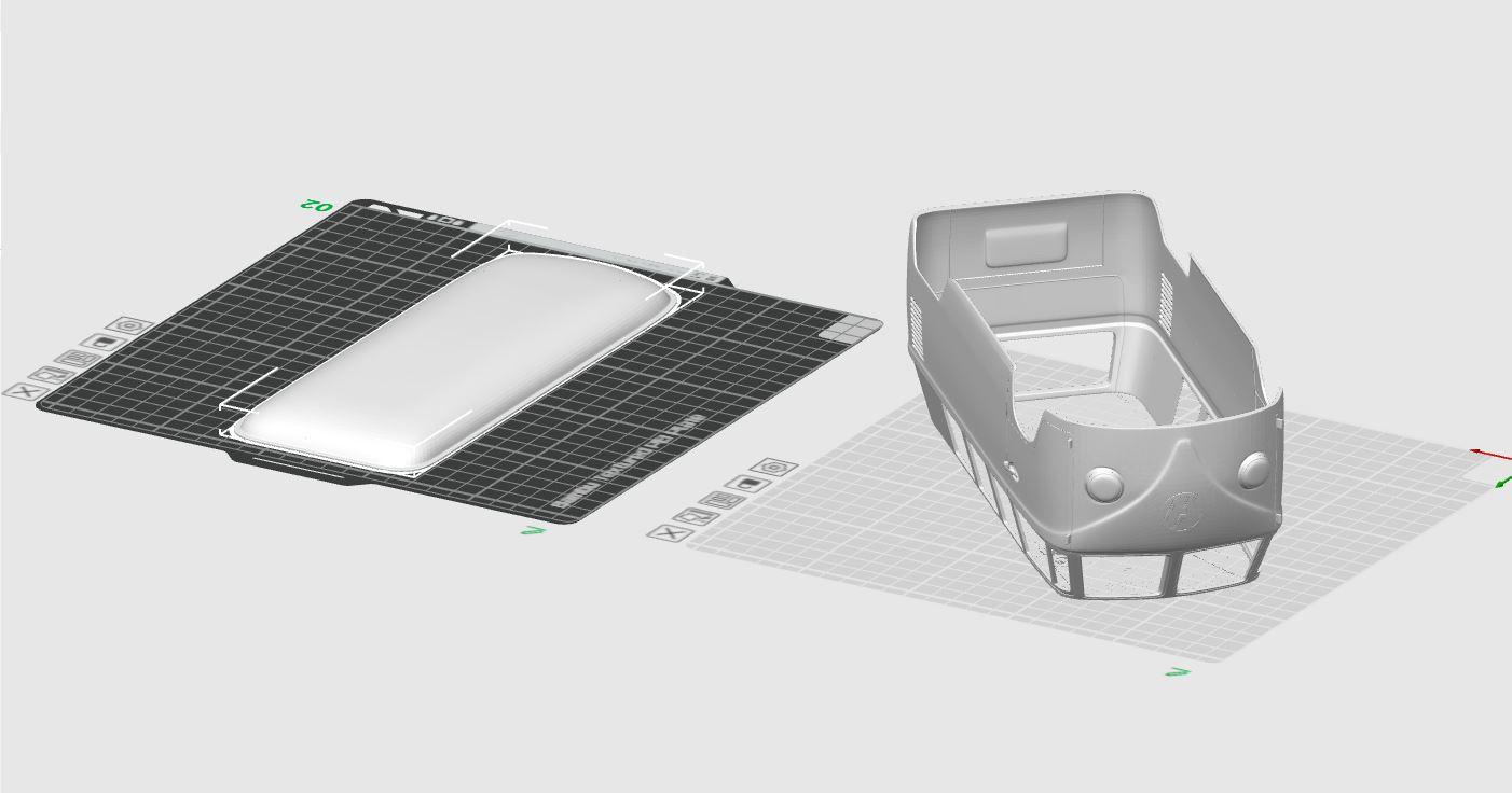

Anyway, you can use the cut features in the slicer to remove the roof however the window frame tops will require supports. Most bridge features that run parallel to the build plate require supports. If they are angled away from the plate (30 degrees or more is best), many times they can be printed without supports.
Another option that will preserve the scale and minimize the need for supports is to orient the model vertically, then print in three sections. Arranging the cuts along the door gaps will help to hide them.
In the example above, I believe the nose will print okay unsupported (or with minimal supports) since it is arched away from the build plate. The inside wall might look a bit messy but it won't be visible in the finished model.
Anyway, I can dissect the model any way you wish.

Looking forward to seeing the F-100 chromed out. This is your model with the scale engine block, that has the DC motor in it?
That's an interesting idea to orient the Bus model vertically like that, and then split it, to keep the original size or scale of the 313mm WB. Nice!
Would also like to figure out how to take the roof off, once the model's Y-axis is set to 250mm, the body could then be printed upside down, or on top of the windows, it's completely flat that way, and can then hide the printing bed marks with the roof.

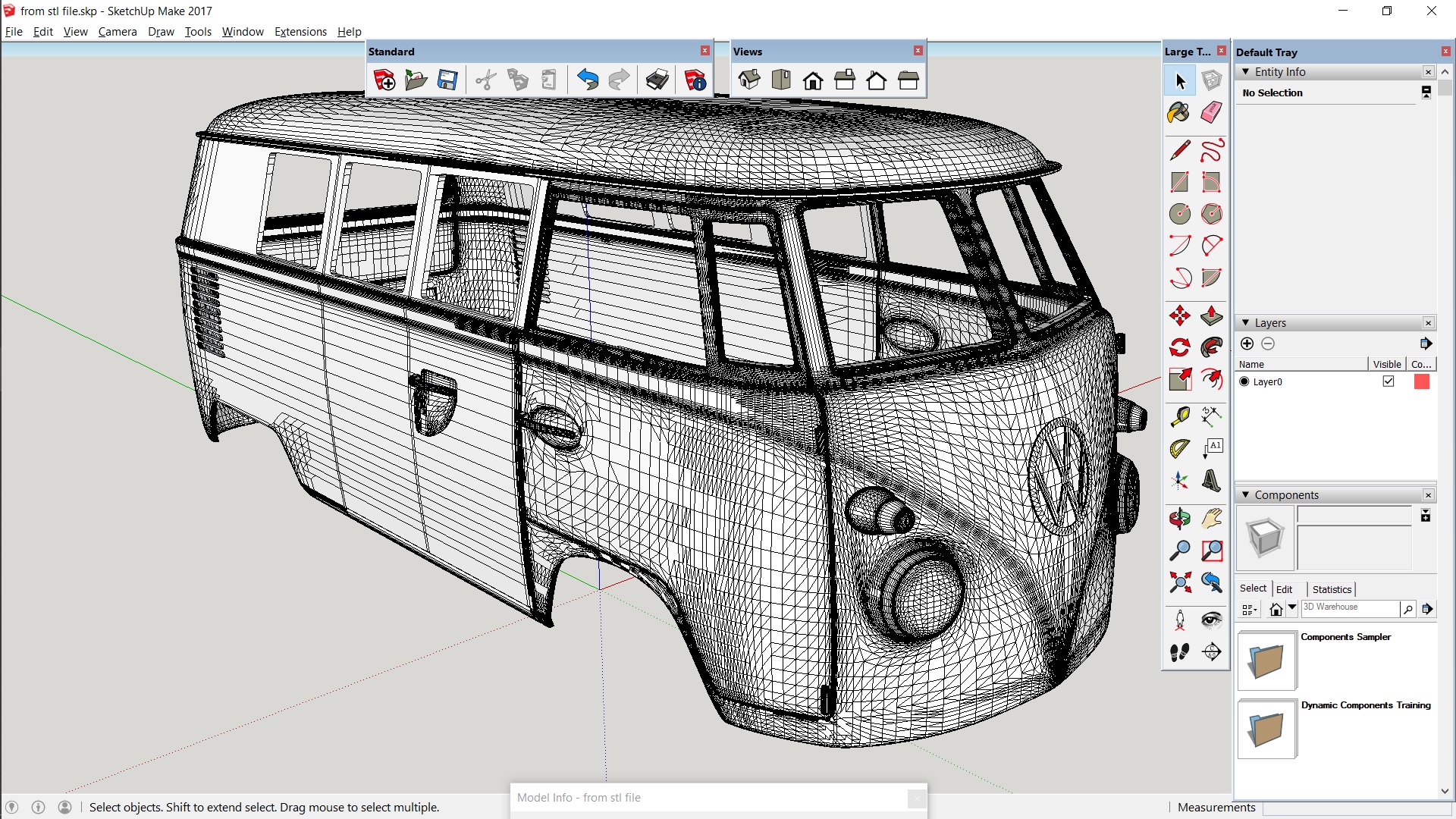

So am I. :D Anyway, yes, the F-100's engine block houses a Tamiya brushed 380 motor, the C6 transmission houses a metal planetary gear set pulled from a stepper motor I found on ebay.
So, I just watched a how-to video and Orca's cut feature definitely will work to remove the top allowing you to print it separately from the rest of the body. That might be the quickest path to a printed VW camper body .
However, I really want to attempt the modifications you've mentioned but I'm having trouble pulling the stl file into my surface modeler; It imports as a mostly open mesh. We might need to depend solely upon the slicer for our cuts and address the mods as post-processes.
... or maybe I just need to upgrade to Fusion 360. :roll:
Nah, that would make my life too easy. :lol:
EDIT: Ah, okay, I got it; The stl was slow to open but I got it. Now, I need to find those bard door reference photos you sent me a while back. :D

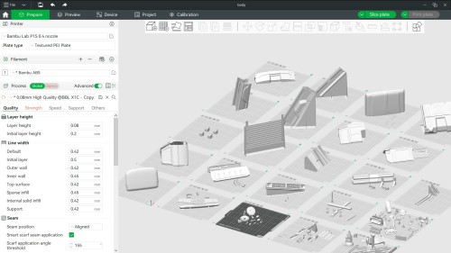

Anyway, I've gone ahead and detached the roof, removed the turn signals and posted the body and roof stl's to the google drive if you want to run a quick test print. Just remember to paint some supports onto the horizontal sections of the window frames and maybe the louvers as well. Otherwise, I think it should print okay.

Nice work! Much thanks, I'll print it now!
I started out with the Cut line set like this, to remove the roof, took 2 seconds to set it and forget it, pressed Perform Cut:
What just happened???
It cut the band that joins the roof to the body, and somehow removed the lights and all accessories, by itself?!
When things like this happen, I always wonder how hard it would've been to set out to do exactly that 8)
