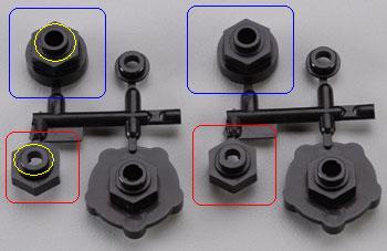

For all of you who can live with hex wheel adapters here's what I use for modern 2.2" rims:
THESE HPI Adapters
The "red" ones are a direct fit to the 1/4" axles, BUT you have to sand down or cut off the part circled yellow (for buggy rims and non HPI truck rims)
If you combine the "blue" ones meant for Losi with the 3/16" axles you also gain about 4.2mm of offset per side which is a bit more than 5/32".
I hope this helps some of you guys.
