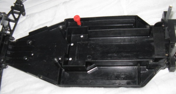

This SE is the first pre-XX molded chassis Losi I've owned. I dig the wee cap on the antenna post!
Sounds like I definitely have an SE chassis. :D

yes that is a Se chassis. I have a set of yellow wheels and a Junior 2 chassis? we can talk about if you want?
