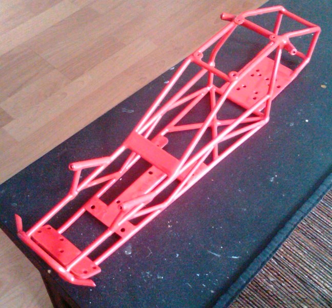

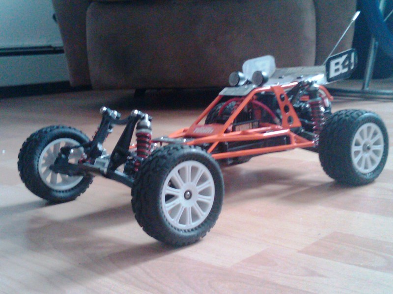

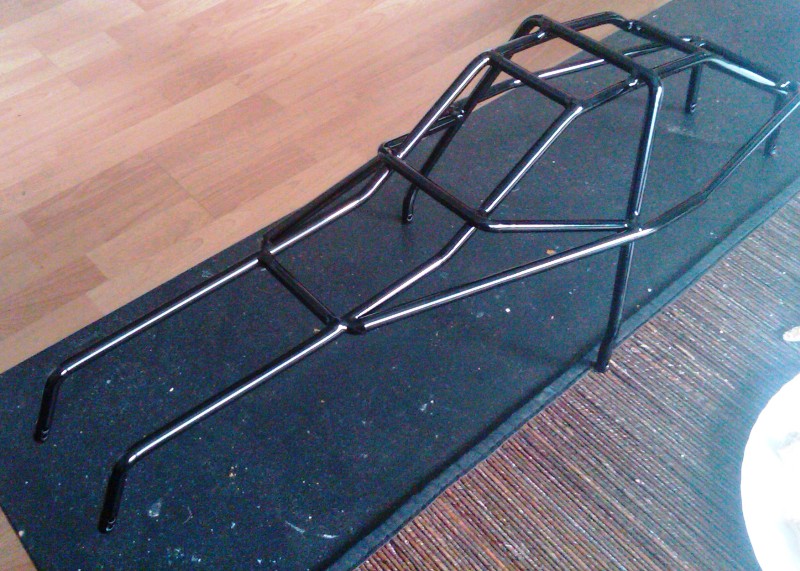

How are you hardening the tubes?mikedealer wrote:cage is made from 3/16" steel tube, better know as stainless steel brake line. its light, and once hardened, very strong.

Kyosho Fan wrote:How are you hardening the tubes?mikedealer wrote:cage is made from 3/16" steel tube, better know as stainless steel brake line. its light, and once hardened, very strong.
by quenching them, process of heating them red hot, and quenching in water, then heating them again to a non red hot state but very hot, and quenching them in water again.. makes the metal very hot.
there are TONS of processes out there for this, like heating in over for 12 hours etc etc.. but this works well for me.

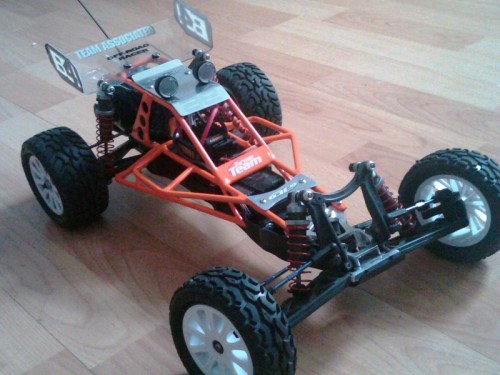

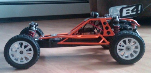

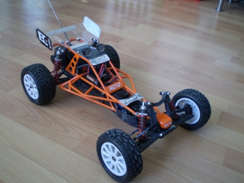

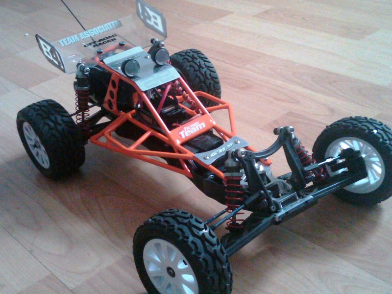

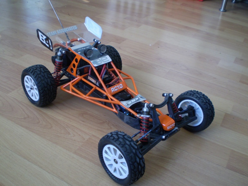

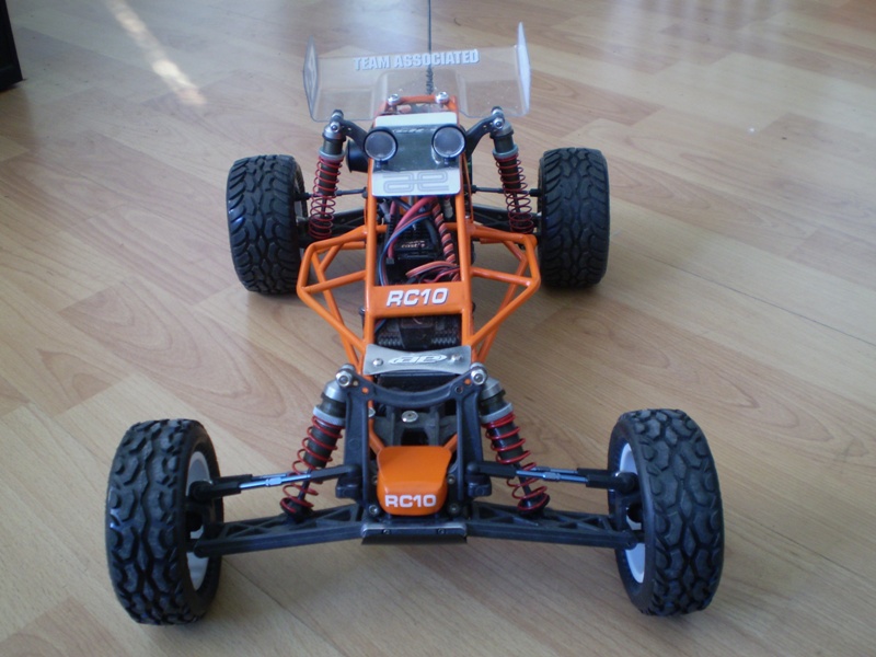

thanks, i know they are minor, but wanted to share pics.. next is some action pics hopefully lol

just got powdercoated chassis's back, this was one of them, other 2 were a circuit 20 kyosho and a custom rc10 i plan to sell on ebay
nothing really new on it except the new cage... need to figure out some new gearing since it wheelies on full throttle and it has a mamba brushless with a 3s lipo.. gonna run the hell outta this one this year.
