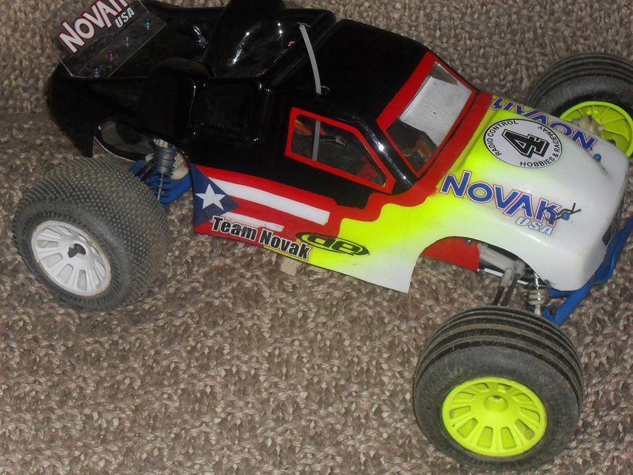

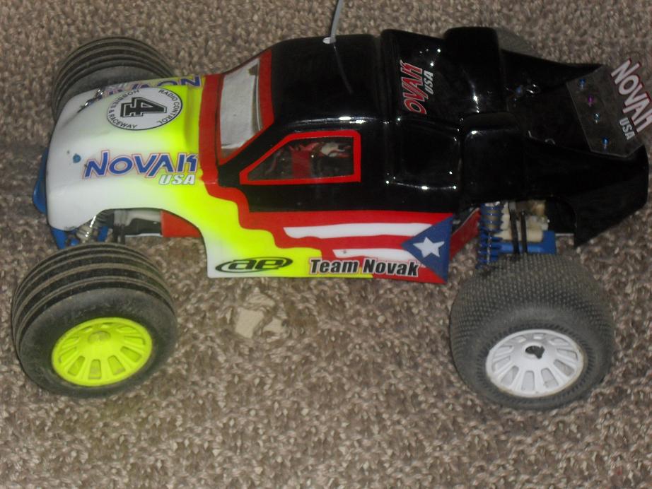

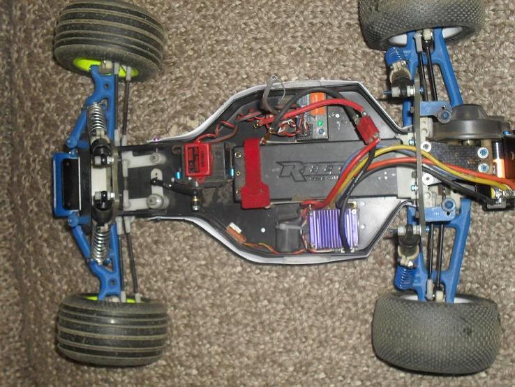

Here's my 10T and the Set up I used for the VONATs
RC10T:
Novak Ballistic 17.5 motor -- 84t spur w/ 29t pinion
Reedy 5000mah 35C Lipo
Novak GTB BL ESC
JC Double Dee tires (rear)
Proline Edge (front)
JC Rulux Wheels
AE quick change conversion
Airtronics Servo
Airtronics M8 w/ DSM
RPM arms, body Mound and bumper
RC10T2 Body
Suspension:
30wt oil (front)/ 35wt oil (rear)
Silver Sprins front/ Blue rears.
Pics:
RC10T:
Novak GTB BL ESC
JC Rulux Wheels
Airtronics Servo
RC10T2 Body
Suspension:
Pics:
- Posts: 1116
- Joined: Tue Feb 05, 2008 6:37 pm
- Location: Donkin, Nova Scotia, Canada
- Has thanked: 7 times
- Been thanked: 42 times
- Posts: 1047
- Joined: Mon Jun 30, 2008 3:17 am
- Location: East Haven, Connecticut
- Has thanked: 19 times
- Been thanked: 29 times
Re: 09 VONATs RC10T -- Set Up...
Camber:
-1.5 Degrees all around
Toe in:
0 toe in.
Shocks Position:
Front: First hole on the arm, middle hole on the shock tower
Rear: Outside hole on the arm, inside hole on the shock tower
Pistons:
#1 Pistons on all 4 shocks, should've gone with two, but ehh, it worked the way it was...
Toe in:
0 toe in.
Shocks Position:
Pistons:

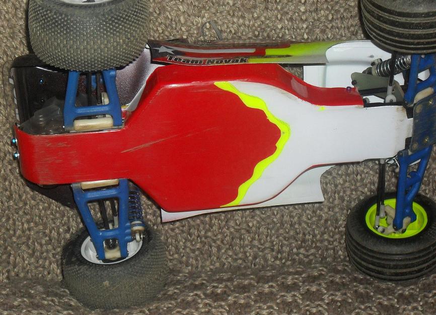

a&l made them back in the day but stopped making them many years ago. but as luck has it a member here is currently making them. ROH73 is his screen name here.xanadu wrote:Who made the chassis undertray? I have never seen one like that.

Yup ROH73 is selling them, they fit real good, I did mine in like 15 minutes, but if I had taken my time it would have come out a lot nicer.
I ran 5 qualifiers and a main and it held like a champ, very strong and durable.
