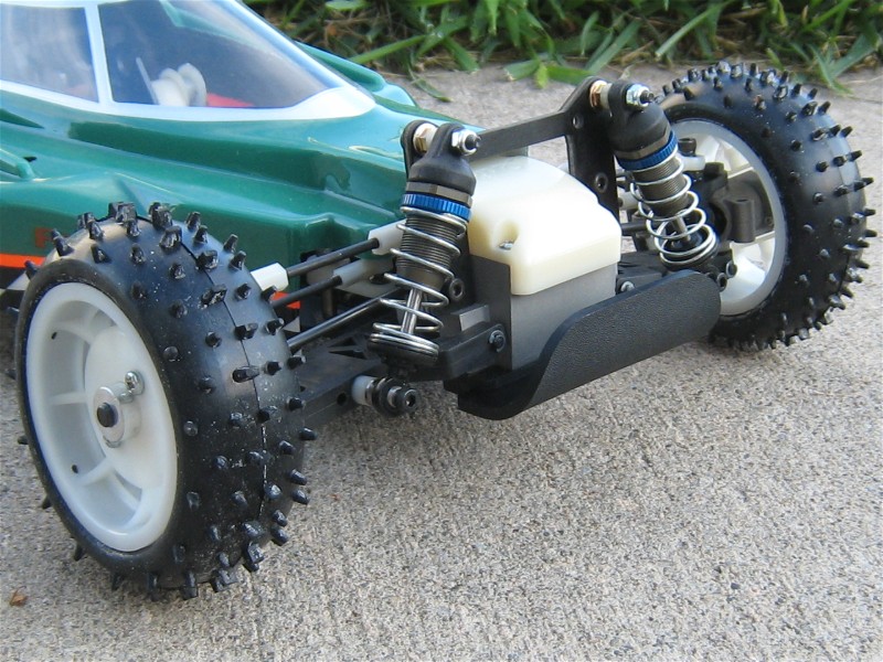

for ease of adjustment, i used the threaded shocks on mine. the rears are standard threaded 1.02 front truck shocks, but on the front, i used tc3 threaded shocks. they're a .56 body, you just have to swap out the .35 shafts for .56's.
karnivool
Posts: 295
Re: 870c shocks ?
Post by karnivool »
gee that looks nice, love that green colour very much. ill consider that, to be honest i try and stick with period gear, just cant get my head around mod stuff on old cars.
