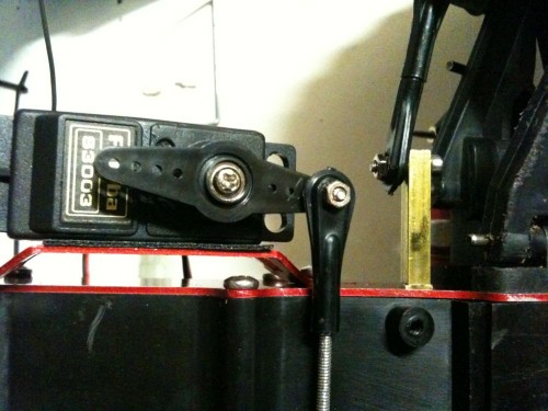

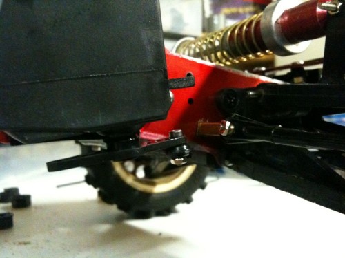

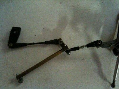

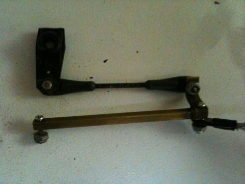

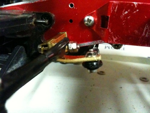

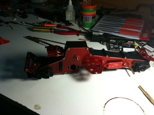

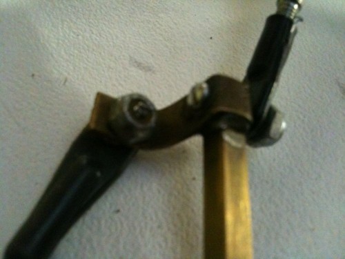

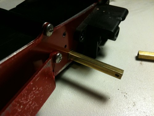

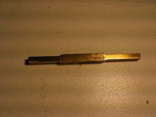

Here are some steering mod pics.
Some are from Bormac's Mugen and the others from mine.
As Bormac says the outer tube goes between the chassis plates as a locator
The middle tube fits into drilled and filed square holes in the chassis plates
and the inner tube slides side to side as the - rack?
I have yet to make the connector arm and threaded rods

Nice photos.
Are those made of brass? Would it deform under function??
- besty22
- Posts: 347
- Joined: Tue Sep 02, 2008 8:21 am
- Location: Central Coast NSW Australia
Re: Mugen bulldog steering modification??
They are all brass tubes which fit inside one another.
The outer tube is 7/32 brass. I don't think it will deform but I made a spare set anyway.

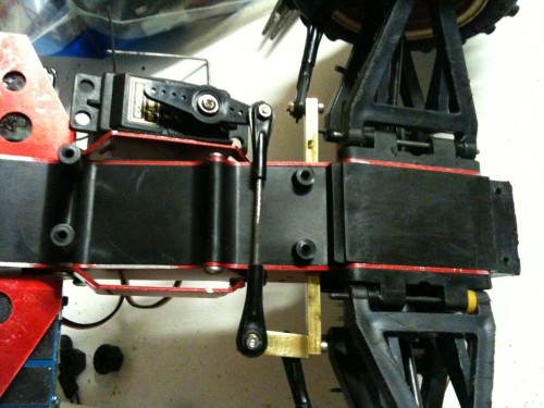

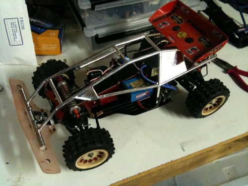

Hi I have finally finished my bulldog steering mod and the rest of the car. Just got to paint a driver.
Here's some pics. Enjoy
