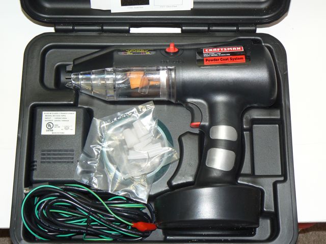

Do not know if this has been posted before. I had been looking at these for some time - for my bike. but thought some of you might like these:
Craftsman powder coating system: http://dealspl.us/craftsman_powder_coat_system_model_17288_at_sears_com_102273
They can be found cheap on the Evil - Bay.
