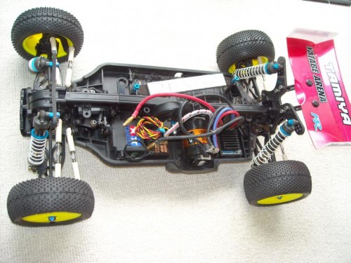

Anything you need to know about this car just ask me.

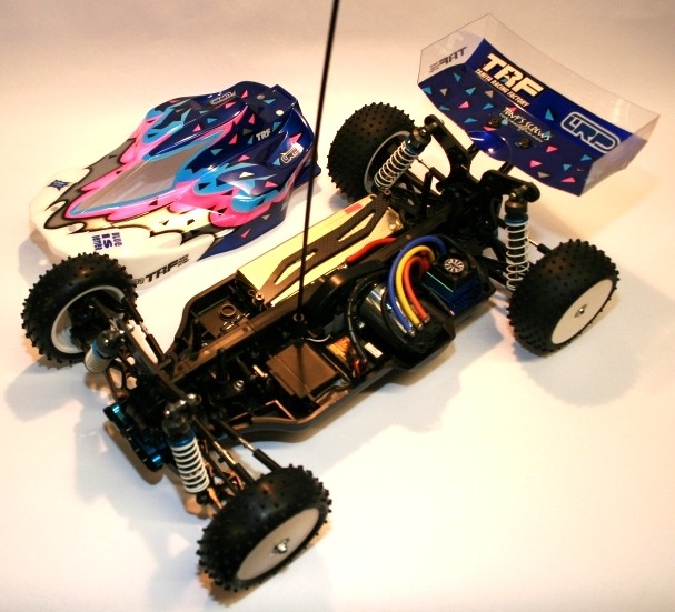

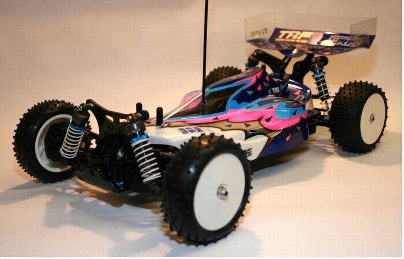

This one's mine, I raced it all last year, a great performer and tough as nails with the right bits fitted. I chose it as I wanted to run my LiPo stick pack otherwise I would have bought a 501.
Tony’s Screw Kit
54028 TRF Buggy Aeration Damper F / R
53709 Flourine Coated suspension balls F / R
51286 TRF501X differential joint set F / R
54118 DB01 Assembly WO Universal Shaft (Front)
54119 DB01 Assembly WO Universal Shaft (Rear)
51090 4 pack of 950 bearings for steering
53884 Option PT TA05 Carbon Battery Holder
54061 Double Slipper Clutch
JDRDB301 3mm Black Ceramic Differential Ball Set F / R
3 Racing DB01-04 Aluminium Front Suspension Mounts
3 Racing DB01-06 Aluminium Rear Suspension Mounts
3 Racing DB01-02/LB Front Shock Mount (pictured)
Atomic Carbon Front Shock Mount (now fitted not pictured)
Atomic Carbon Rear Shock Mount

yeah it is a very hard car, the period I used it,I just broke two parts...
I have aprox the options fitted as you.
Nice car!

I used to run one, with most of the options on the list above (std slipper rather than the double slipper).
Although I had the 3 racing alloy outdrives in the front diff with the 501 diff halves in the rear.
Strong cars, ideal if you want a competitive car that takes stick lipos.
I would stay clear of the 3 racing shock towers, they would be stronger if they were made from cheese!
Get the Atomic Carbon towers as the rear is taller to allow you to run the aeration dampers without fitting limiters as the standard tower is too short (the atomic tower has two sets of holes to allow all dampers to fit)
I would go for the DB01MS as that has most of the hop ups as standard, you can then use the setups for the 511.
