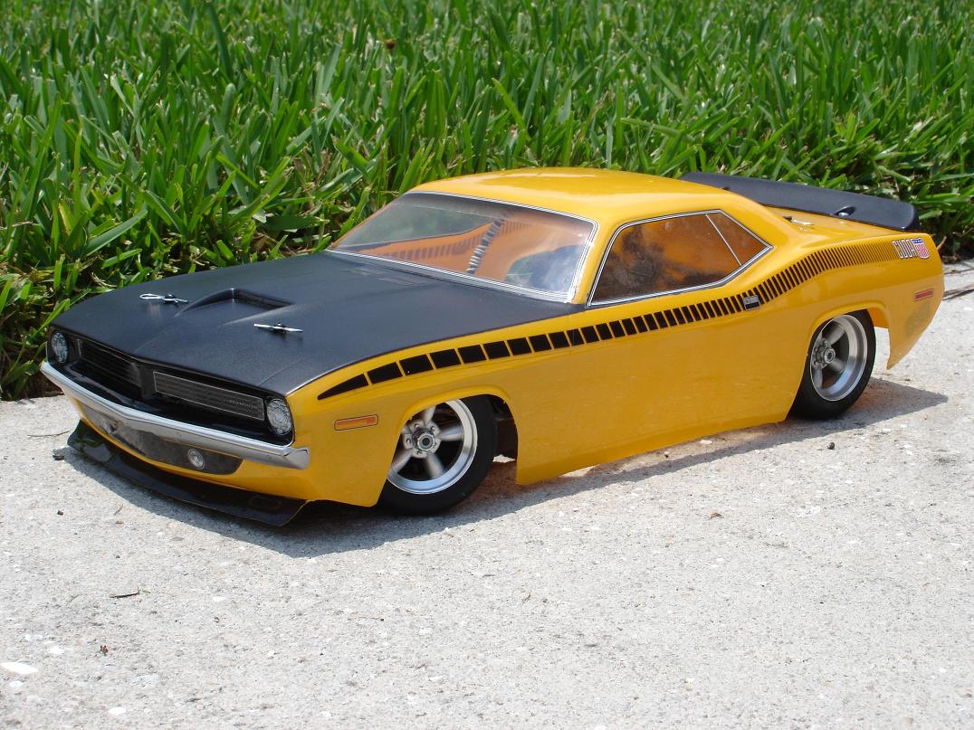

I masked and painted mine on the inside first, then painted the hood on the outside. That way, if it scratched, it wouldn't be too noticeable.
