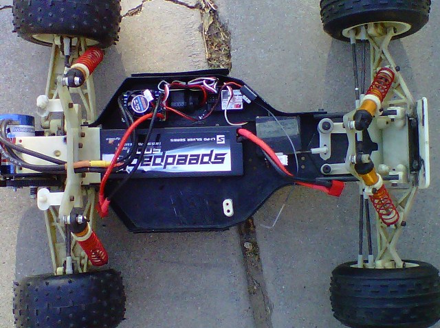

well here it is...havent ran it yet
will run this weekend

sorry...here is the pic

i spoke with team associated and they stated that the old style stealth tranny is good about up to 4900kv
after running this weekend, thats about all the truck can handle. After 2 runs on a 2s the tires that you see above are now completely bald....haha
time for a good set of street and dirt tires.
This thing is really fun. It was nice to see it running again after about 20 years sitting in the garage.
