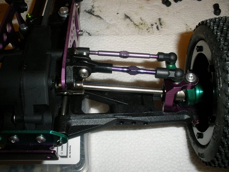

Front Camber Situation
I had an issue with too much positive camber on the front. The long control arm set I purchased came with its own C-carriers. I wanted to use these nice alloy purple ones (GPM #KF4019), however. They fit just fine and were otherwise an easy swap-in upgrade. I discovered that the design of the alloy C-carriers incorporated an angled region that acted as a camber block. Unfortunately the control arms prevented this region from moving within the outer notches of the arms to give me the slight negative camber I was looking for.
It was solved by doing a bit of grinding of the inner, upper edge of the foremost "notch". Fortunately, very little material had to be removed, so it shouldn't negatively affect the arm's structural integrity that much. The pics show where I had to Dremel a bit of the arms to allow the alloy carriers to rotate enough to resolve the camber situation.
The front swing shafts used are Kyosho 62.5mm units, the same length as the stock Optima dogbones. I had to switch the axles though, I wasn't getting enough axle thread to mount the front wheels. I believe I swapped the axles from LA258 60.5mm CVDs (which have 3 grooves in the axles) onto the bones of LA245 62.5mm CVDs (which have 2 grooves/shorter axles). The 62.5mm bones with the longer LA258 axles was perfect.

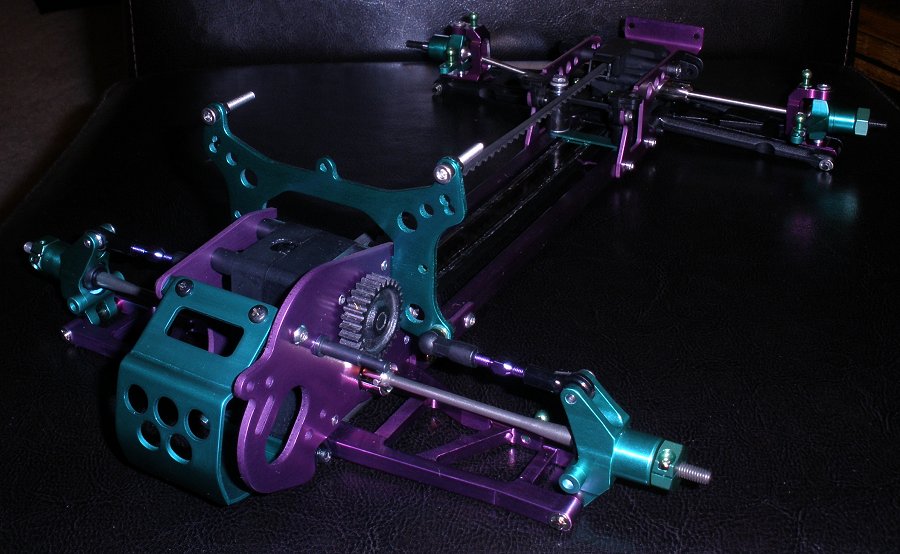

Rear Suspension Done
I got a lot accomplished this afternoon! With the front end tweaking done, it was time to focus on the rear.
As mentioned before, the rear arms are el-cheapo $6 #DF2056 GPM arms (originally blue and were de-anodized, polished, and re-anodized purple.) They're almost exactly 5mm longer from pin-to-pin than stock Optima arms, which is great. I wanted to widen the track a bit to make a more stable ride. I found that 65.5mm Lazer universals were a tad too short, though; fortunately in anticipation of that possibility, I also purchased 68mm units, they were a perfect fit. I had to grind their flanges down like I described earlier with the 65.5mm joints.
The turnbuckles I used for the rear camber & stabilizer links are all 29mm titanium HPI #93464. The purple stab ball set is HPI #72302 with 4.8mm Delrin ball-ends. I used the top mounting hole in the rear Turbo Optima shock tower to mount the ball studs for the camber links so that they'd be more parallel with the arms & U-joints.
Rear stabilizer installed; had to drill & tap my own holes in the GPM arms for 3mm-threaded 4.8mm ball studs.
