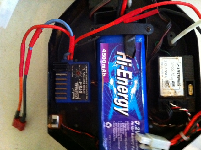

can you shoot a pic of that DTX-4 esc? I have been looking for one for a while and the pic would help me in my search!

Here is the ESC and thanks for the info!
Is this the brushed motor you would recommend? Do you think I should go 19 or 17 turns for more speed? Would a I loose to much torque?

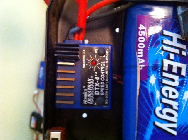

Here is a better Picture. Sorry!

is it me or that dtx4 screams NOVAK ???

[quote="Lonestar"]is it me or that dtx4 screams NOVAK ???
Yes, it does, Novak Tempfet T-4

Thanks!! ( now to find one :lol: ) I thoughtit was the 410M5 rebadged, it was my first ESC as we were outfitting my 10t as cheaply ( still had the Trinity MaxZilla pack and the Slot machine though!!)

When Novak changed out to the M series (M1C, M5, etc), Duratrax re badged the now old Novak T4 under their name as a budget esc! My guess is Novak had a bunch of T4 circuit boards that they would not be able to sell otherwise!

yeah, I could be way off base, but I sort of remember seeing a review of that esc in RCCA, with reference that is was a Novak rebadge. Maybe I'm dreaming it, or this mundane detail has been sitting in my brain for many years.

I'm sure of the rebadge, I was just mistaken over the model- my internal board said Novak-

interesting info - funny how an esc layout can be so representative of a brand, as soon as I saw this thing I was like "NOVAK GEAR" 8)
