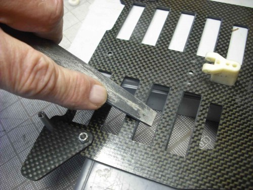

Does this count?

Yea! Battery slots are a BIOTCH!

you're kiddin' right???Lowgear wrote:Why is that done? I never remember anyone doing that in the 90's when I raced pan cars.

I remember guys with 10l fiberglass cars not doing it, but with the graphite being a decent conductor and sharp edges it would destroy battery shrink wrap in 1-2 runsLowgear wrote:Why is that done? I never remember anyone doing that in the 90's when I raced pan cars.

I forgot about that too. That was a PITA!
I thought it was so that the cells sat further in to lower the c/g. Although I guess it would definitely save the shrink wrap too.

Ah I see, that makes sense. I'm lucky I never had that problem. Maybe because my packs were always held together with glass tape and prayers.
An RC10L is the only R/C with a graphite chassis, and battery slots I've ever run which is why I wasn't aware of the need to do that.
