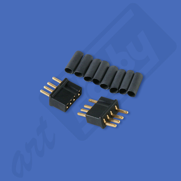

that servo wire definitely isnt stock novak. they always used braided red/white/black, not yellow. since the car is a shelfer only, the tamiya plugs dont hurt it at all, but a nice set of old 4 pin deans (black are older than the red) would be period correct (at least that is what I used in the late 80s). if you do find 2 sets of 4 pin deans, use one set on the motor to esc and one set on the esc to battery.
:edit: the 4 pin deans are still available :)

1. Thanks for the tips guys... you keep saying the wires aren't orginal, but I just opened the T-4 speedo new in the package myself. It had never been touched, heat sinks never even pressed on... 100% brand spakin new. Either way, how do I get the receiver wire over to the receiver if i don't go across the top? Extension and go in front of the battery hold-down? Of if i flip the speedo, should I just run the receiver wire under the battery between the cells?
2. Where can i get the black 4 pin deans? I remember running those way back in the day, but they were red.
