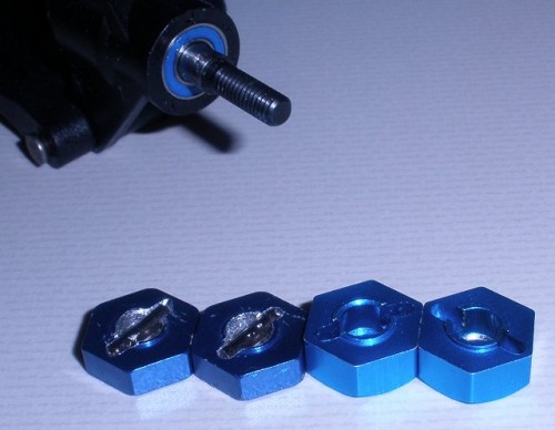

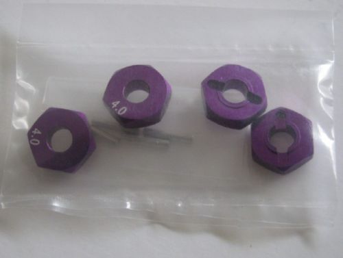

Thin 12mm hexes found!
I managed to source some very thin hexes. I've seen thinner ones--Kyosho makes some that are only 3mm or so thick, but those use a tapered-hole, friction-fit. Pretty much all the hexes I'd seen that use cross-pins, and have a 5mm inside hole/4mm outside hole, are at least 5mm thick or more....until I discovered these:
http://www.ebay.ca/itm/250910875379?ssPageName=STRK:MEWAX:IT&_trksid=p3984.m1423.l2649
These hexes are only 4mm thick, and the raised central portion to offset from the bearings is lower than all the others I have, only being 0.3mm high...so the total hex width is only 4.3mm. It may seem like a minute difference but 1mm of threads is a good extra turn or two for an M4 nut to bite onto.
Golden Horizons makes thin 12mm hexes for the 1/16 E-Revo, but those required modding to fit normal 2mm cross-pins, as the recesses for cross-pins are too narrow & short. I had to widen & lengthen the recesses and file the length down of some 2mm cross-pins to get those GH hexes to work. With these hexes, no modding is required, they work fine with standard cross-pins and are at least 1mm thinner than any other hexes that use cross-pins. And bonus: they're available in several colors!
So, if you're in search of thin hexes because your wheels barely thread on enough or you need to narrow your track width a bit, try these out.
