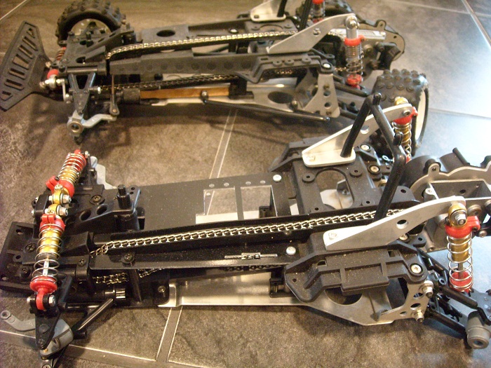

Re: Kyosho Gallop Experts please.!!!!

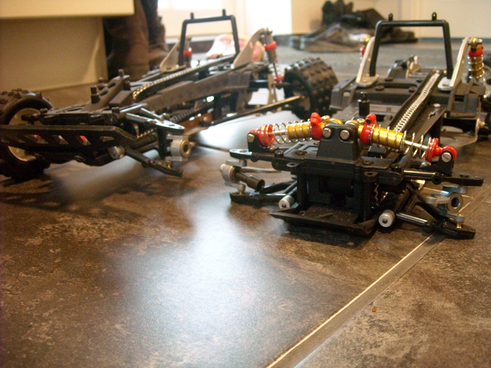

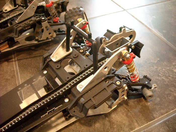

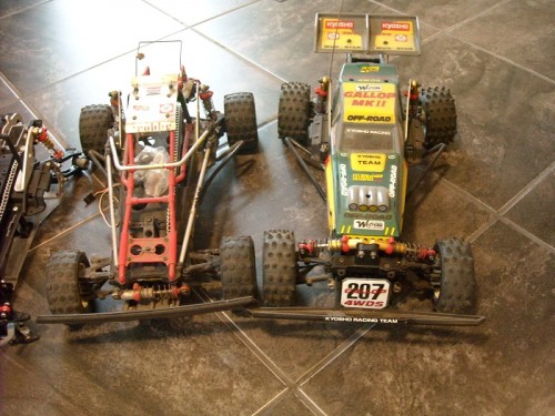

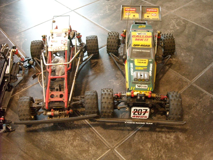

I´m no expert - but thought I would share what I know about the gallop anyway
The Mk I has a single front shock setup with torsion bars,
The front has one way bearings and no differential. Wheelbase is app. 260mm
The Mk II has a gfk radio plate, 2 shocks setup at the front, no torsion bars and has a front differential with normal bearings/bushings.
The rear suspension arms alloy mounts has been changed to enhance the steering with compressed rear shocks. Wheelbase is app. 270mm

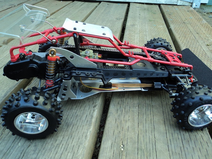

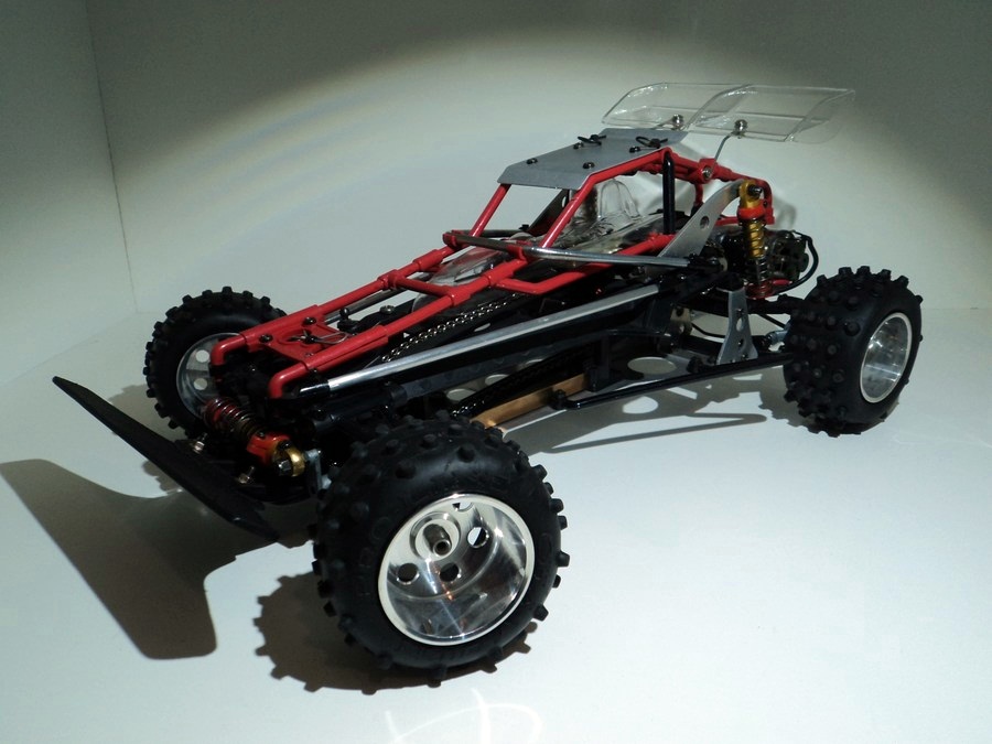

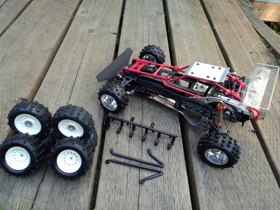

I'm no expert but this seems like a good opportunity to trot out this one I got from highwayracer.
Gary
Very nice Gary.
Love the Torsion Bar set up. All polished up too.
Thanks for sharing .
Mark
Mark
Gary,
That looks really nice with the aluminum wheels. I'm glad to see you were able to find/fabricate the aluminum roll cage parts.
Regards,
Roger
Regards,
Roger
Thanks Roger, I love this car, one of my favorites. Like Rick used to say, they're all my children.
I made the straight bars from the KS tubing as you suggested but I couldn't get a good bend in it for the upper piece so I resorted to using a chunk of brake line I had in the shop. It polished up really nice and was easy to bend with my tubing bender. Came out ok, if not perfect.
Thanks again for the great car!
Gary
