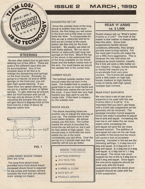

Here is "the official" bumper between chassis and front bulkhead mod scan:

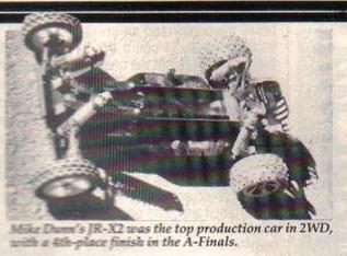

1989 worlds Mike dunns car.JPG (16.71 KiB) Viewed 532 times

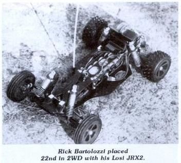

1989 worlds Rick Bartolozzis car.JPG (25.44 KiB) Viewed 532 times

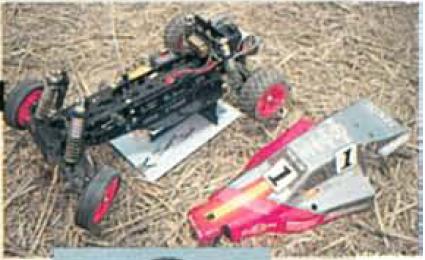

1989 worlds Ron Rosettis car.JPG (25.25 KiB) Viewed 532 times

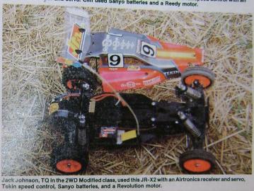

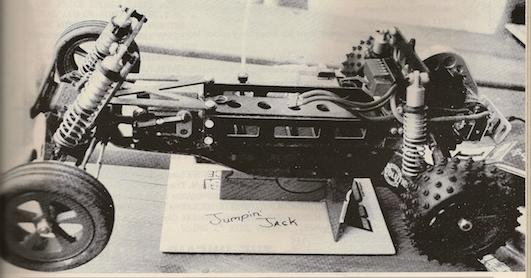

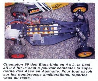

Jacks Jrx2 1.JPG (26.3 KiB) Viewed 532 times
Jacks Jrx2 3.JPG (24.55 KiB) Viewed 532 times
To me all the cars above seems to have 30-degrees kickup in the chassis without the bumper mod.
