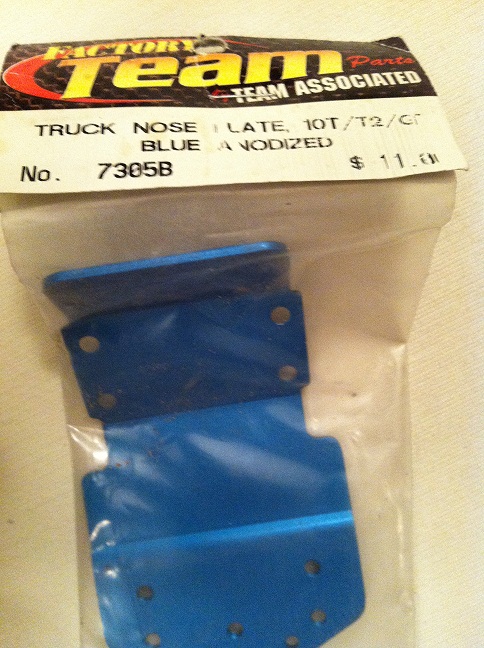

all right a few more pics
and a lil info
this baby is going to be a racer, the only shelf its going to be on is the pit table

This is a great list of what is needed for the klein / bigjeepzz arm conversion composed by PBR Allstar. Since, you spray painted yours, it should be fairly easy to pick up a beat (or new) 10t nose plate and take the same steps you did to spray paint the rc10 nose plate. Or, perhaps cut the orange spray painted nose plate that you have, like Y'ernat Al did in his recently completed beautiful OTBA build here http://www.rc10talk.com/viewtopic.php?f=35&t=24390 and touch up as needed. Or, I'm sure there are 10 other ways 10 other members could think up :lol:
jb
PBR Allstar wrote:Okay, this I think is a pretty comprehensive list of how to do the Klein arm conversion. if anyone else has anything to ad post it up!
http://dynotech-racing.com/partDetail.php?RefNum=2700 Rear X2
http://dynotech-racing.com/partDetail.php?RefNum=2701 Front X2
http://www.avidrc.com/product/?c=0&p=102 Rear hub bearings x4
http://www.avidrc.com/product/?c=9&p=48 Front wheel bearings x4
http://www3.towerhobbies.com/cgi-bin/wti0001p?&I=LXEU81 RPM GT Carriers 70272
http://www3.towerhobbies.com/cgi-bin/wti0001p?&I=LXSYV7 Associated Rear CVA Kit B44
http://www3.towerhobbies.com/cgi-bin/wti0001p?&I=LXEAH8&P=Z Associated wheel spacers
http://www3.towerhobbies.com/cgi-bin/wti0001p?&I=LXKYT2&P=7 Associated wide front axles
http://www3.towerhobbies.com/cgi-bin/wti0001p?&I=LXEAK8&P=SM Associated rear wheels
http://www3.towerhobbies.com/cgi-bin/wti0001p?&I=LXEAK7&P=SM Associated front wheels
http://www3.towerhobbies.com/cgi-bin/wti0001p?&I=LX2914&P=7 Associated truck bulkhead
http://www3.towerhobbies.com/cgi-bin/wti0001p?&I=LX2964&P=SM Associated shock tower
http://www3.towerhobbies.com/cgi-bin/wti0001p?&I=LX2585&P=SM Associated 1.02 shocks
http://www3.towerhobbies.com/cgi-bin/wti0001p?&I=LXBVF8&P=7 Associated front springs
http://www3.towerhobbies.com/cgi-bin/wti0001p?&I=LX2929&P=M Associated truck nose tubes
(these need to be shortened and redrilled for the correct wheelbase)
http://www3.towerhobbies.com/cgi-bin/wti0001p?&I=LXTHT3&P=7 Dubro turnbuckles (x3 these need to be cut to length but is the cheap way to go, also good to use to determine length if you want to use titanium in the future
You will also need a truck front nose plate, these are no longer in production but are easy to find in the BST section or aftermarket ones are very plentiful on ebay like this one: http://cgi.ebay.com/Aluminum-Alloy-Front-Nose-Plate-Bumper-Fits-RC10GT-RC10_W0QQitemZ190311126494QQcmdZViewItemQQptZLH_DefaultDomain_0?hash=item2c4f6d55de
There are other ways around it, but that is a pretty comprehensive parts list, it can be done pretty cheap (realatively speaking) if you get parts and help from members here, and scour ebay. If you want the slammed body look with the cut down chassis then you need to make your own rear shock tower or find a 10T rear tower which is no longer available from associated, but are still easy to find on ebay.
The assembly is very straight forward, Like mentioned above, you need to cut the nose tubes and redrill them so they work with the nose plate in the short wheelbase position, if you opt not to do this it will still work but the steering geometry will not be correct. It's good to have a dremel on hand as a couple parts may need a small tune up to fit perfectly, it's also a good idea to have a .126" chucking ream on hand to ensure a perfect fit of your hinge pins, those can be found at mcmaster carr for cheap http://www.mcmaster.com/#3087a31/=57tbxg hope this all helps those wanting to do the conversion!

but in all honesty why do you have to run a trk plate could some one explain this
thx farmer

the arms are way longer than stock, so a narrow front end is needed. they were designed using the truck front plate/bulkhead/shock tower.

i got one of theses
does someone want to save this minty in package, for a good used one and some parts on the list maybe?
man but i really dont like the look of a 10t front tower

I have a NIP Associated lime green truck nose I'll trade you. It can be the stem for the pumkin :P

lol we are trying to save the nip
i cant belive that no one wants a nip 10t nose
ok all leave it up for offer for a lil bit longer

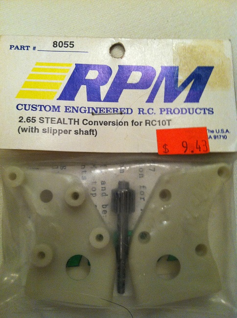

heres a question
im thinking on useing this rpm case but i want to use a b4 top shaft and v2 slipper
will it work?
also do you really need the felt gasket for the stealth ?
