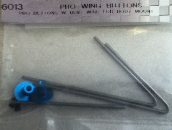

Ok, I need some help figuring out what Trinity Wing Button kits numbered 6013 are intended for 6012. I can't find any reference material for them.
The 6013 seems like it would work for things as long as you bent the wire more. But it must have been intended for something specific because it says "for body mount". What the heck does that mean? What body would you mount it to?

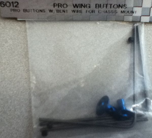

The 6012 kit seems fairly straight forward, and says chassis mount. I guess 6013 really is the one I am stumped on.
Here are some terrible picts for reference.

Top one you mount to rear body by two other wing button mounts then attach to wing with the blue buttons.
Bottom one mounts to the rear pod on pancar by alloy wing standoffs that screw onto rear pod topplate then put wing wire into standoffs and tighten the set screw.Don

Ahhh, pan car. Never thought about pan car. I forgot about running pan cars with those big wings. I was trying it on my XX and it seemed fine for the chassis mount one. I knew there was a Kinwald version of this kit and this wasn't it. The Kinwald has a couple extra bends in the wire.
