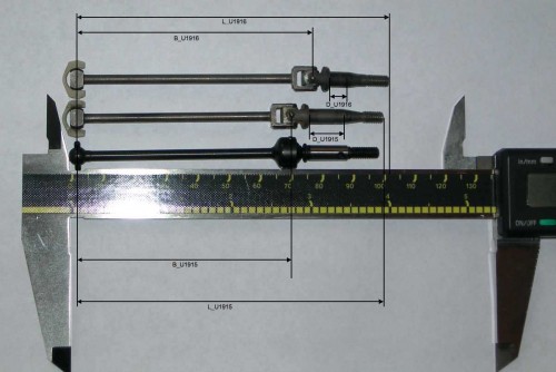

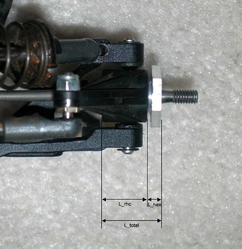

Hello,
I am trying to put together an off the shelf swing shaft (aka driveshaft) replacement for an older Schumacher CAT '98 and have found that Kyosho part LA231 has the appropriate pin-to-pin dogbone length (68mm) but the axle is too short for the rear hub carrier I am trying to fit. Upon searching through the forum, it seems that the different Kyosho swing shafts (e.g. LA231, LA245, UM510, and UM522) are all interchangeable but I am not certain. Therefore, I would appreciate it if anyone can answer any of the following questions.
1. If you are using a hex (e.g. LAW30) and a driveshaft (or axle) other than LA231 (e.g. LA245, UM510-02, or UM522-02), could you please post the corresponding dimensions for L_rhc and L_hex in the picture below?
2. Are the pins of the swing shafts at the diff outdrive side removable?
3. Are all of the above swing shafts and axles interchangeable (e.g. LA231 can be used with LA522-02)?

It's indeed 1 mm per ring. I have a bunch of Kyosho CVDs and all of them have either 2 or 3 rings. I haven't seen less or more...at least yet.

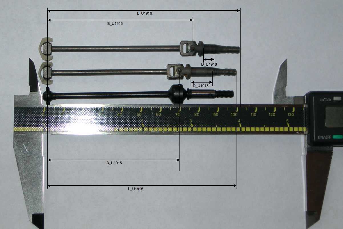

Thank you for verifying the length difference per ring. Attached is a picture of LA-231 next to the driveshaft I am looking to replace (U1915). For LA-231 the spacing between the bearing face to the beginning of the pin hole is approximately 10mm. Can you verify the corresponding spacing for either the two or three ring version?
Also the dimensions corresponding to L_rhc and L_hex in the picture included in my first posting, would be appreciated if anyone can provide them.

Okay, here's what I can add:
The axle with 2 grooves is approx. 12.3 mm from bearing face to CENTER of the crosspin hole. I don't have a 3-groove axle available for measurement, I think it's installed on Barney...but I would assume it's 13.3mm from bearing face to center of crosspin hole, as it's 1 mm longer than the 2-groover.
I have a bunch of cheap but nice 3Racing CVDs for the Lazer, the axle end is functionally identical to the far more expensive Kyosho ones, and the dogbone end comes in various lengths: 65.5, 68 and 73mm. The axle measurement from bearing face to center of the crosspin hole on all of those is the same, about 10.75 mm. These 3Racing ones I'm talking about look exactly like the bottom CVD in your picture.
All Optima CVDs should have 62.5mm dogbone ends as the Optima dogbones were 62.5mm long.

Hello Coelacanth,Coelacanth wrote:Okay, here's what I can add:
Thank you for the measurement. It was helpful and allowed me to further narrow the options. Also appreciate the 3Racing recommendation.
