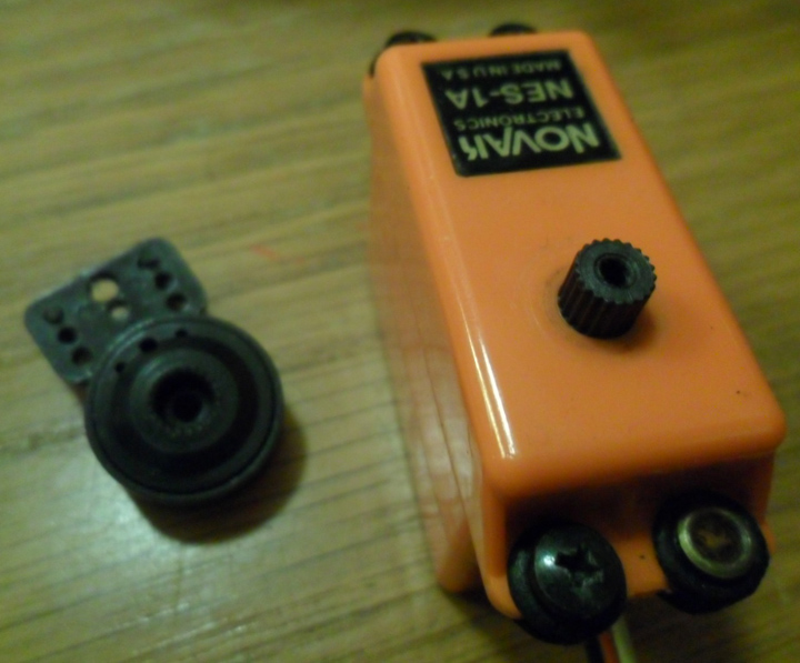

I would like to use a vintage Novak servo on an RC12i. Does anyone know what size sevo saver fits the Novak?
Thanks Limestang

It should be the square drive one like early futaba, kraft, etc iirc

search kimbrough. novak batam servo's had square drive, 1a etc onwards were spline

Ya beat me to it!
Novak NES1 shafts are splined and don't fit futaba splines (as they are smaller). The packaging says they cross-fit with a "Kraft 33n"..
Kimbrough no.112. Looks like they still make 'em:
http://kimbroughracingproducts.com/store/index.php?dispatch=categories.view&category_id=205
