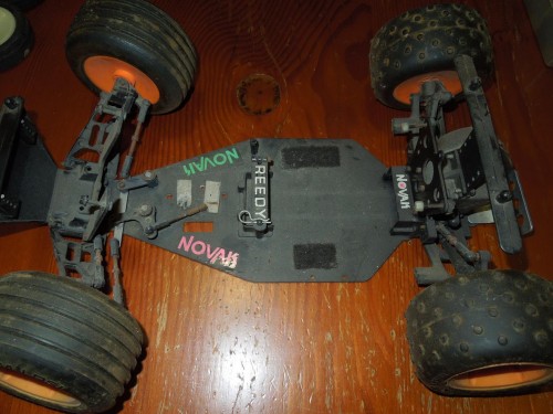

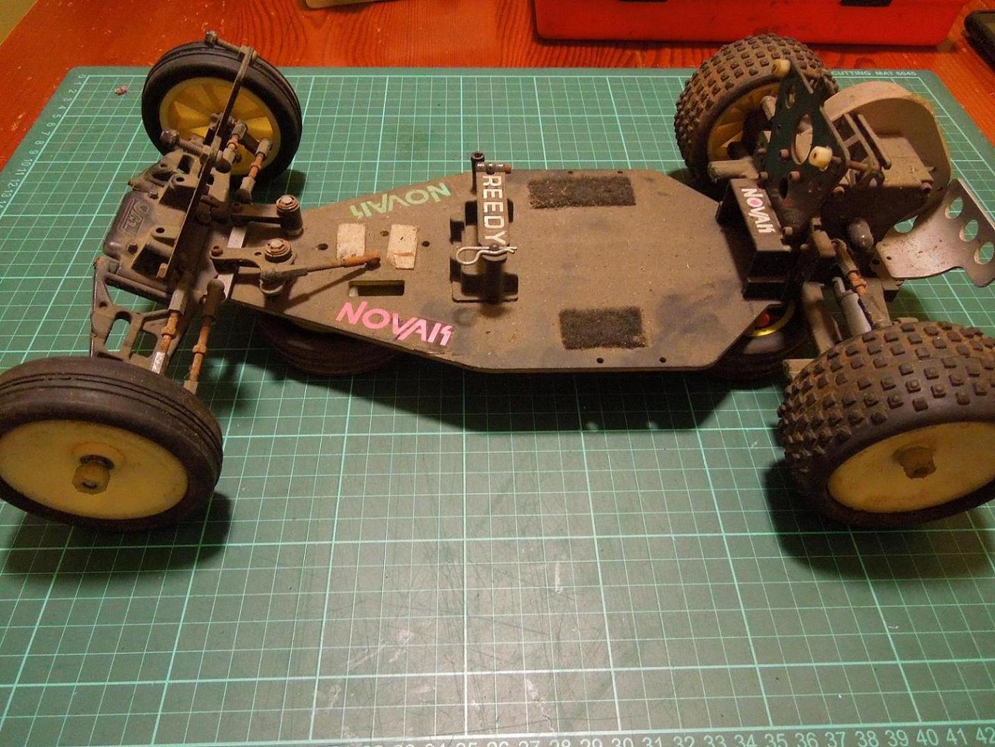

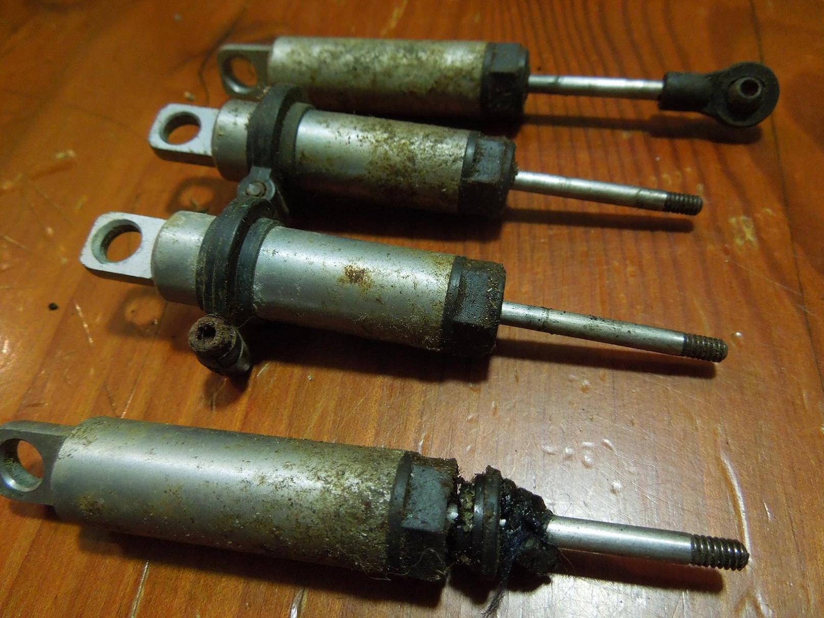

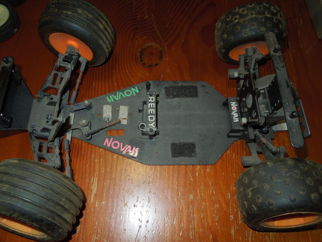

Here's some pics.
Do you think i could run these as they are?
As it looked when I took it out of the garage.

it's probably worth it to change the shock shafts.

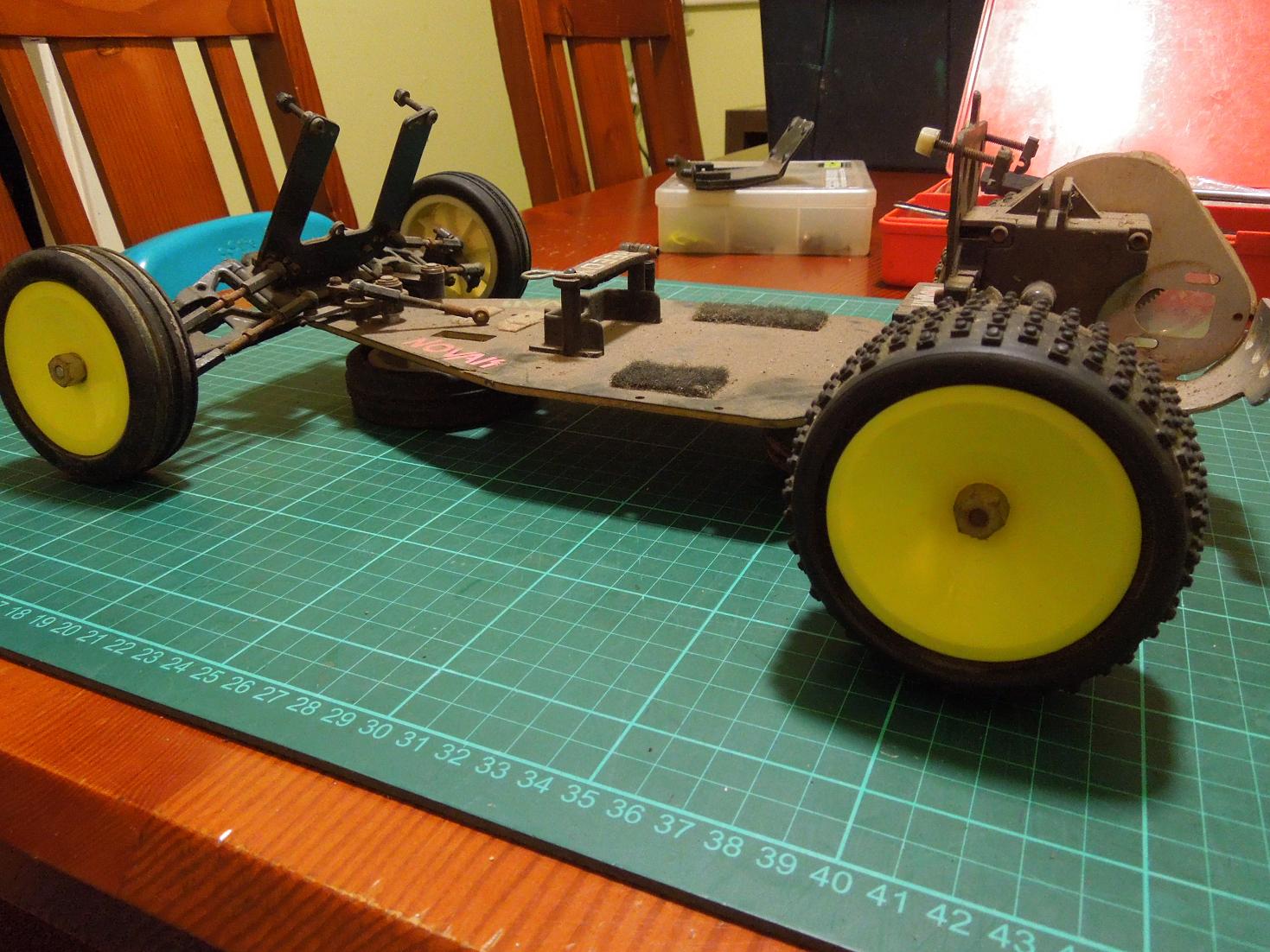

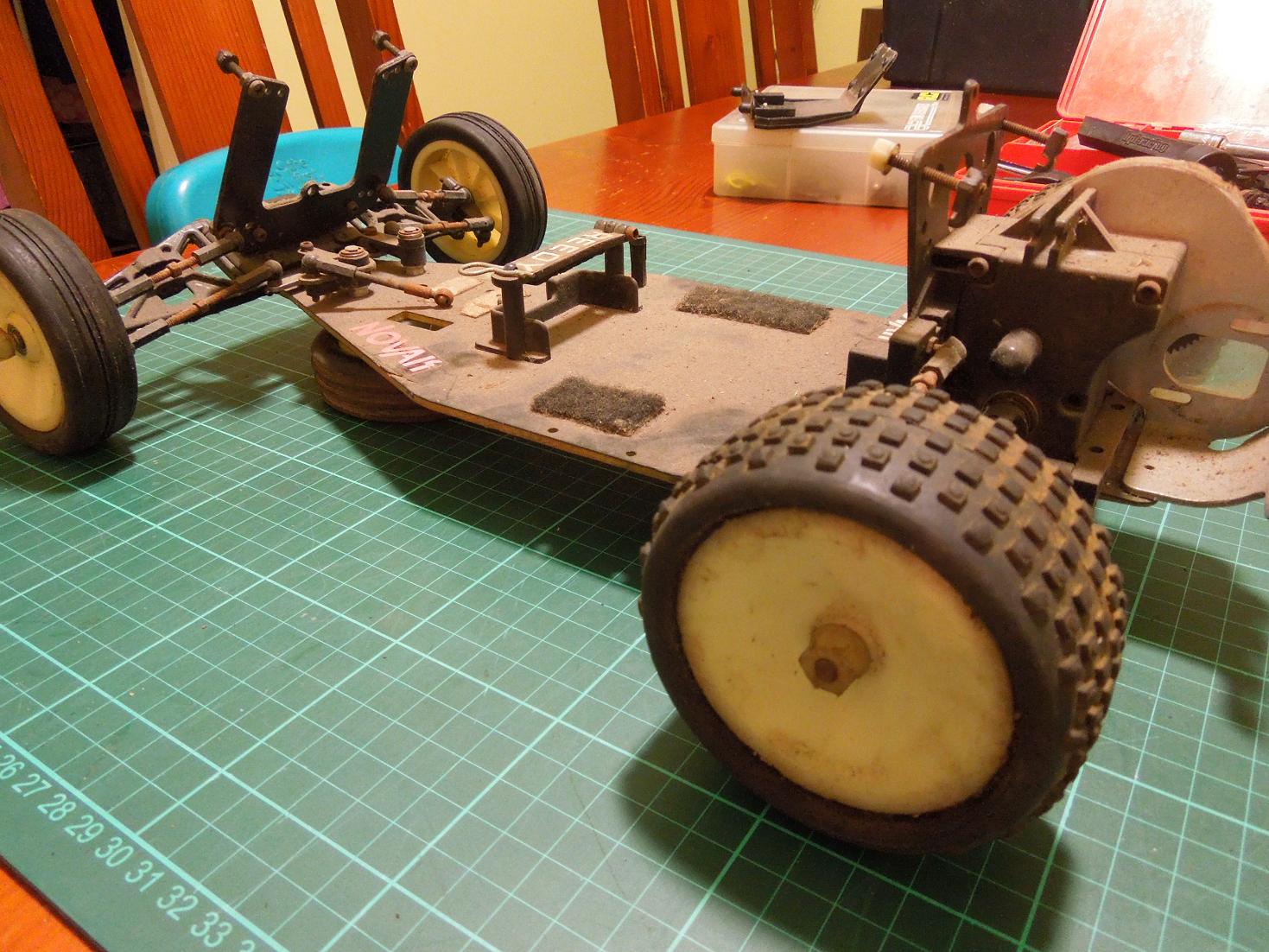

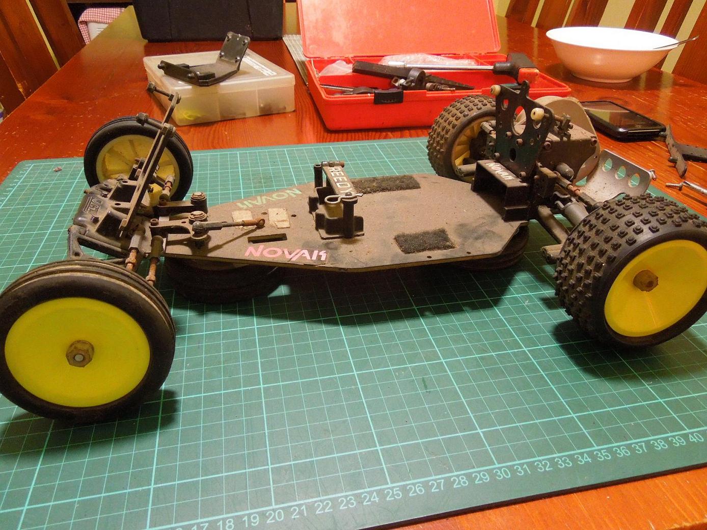

More pics with buggy wheels.
I like these yellow B2/3 wheels but they take the rear width out to 260mm.
How much better does it look as a buggy?
Trinity 2.2's
Trinity 2.2's

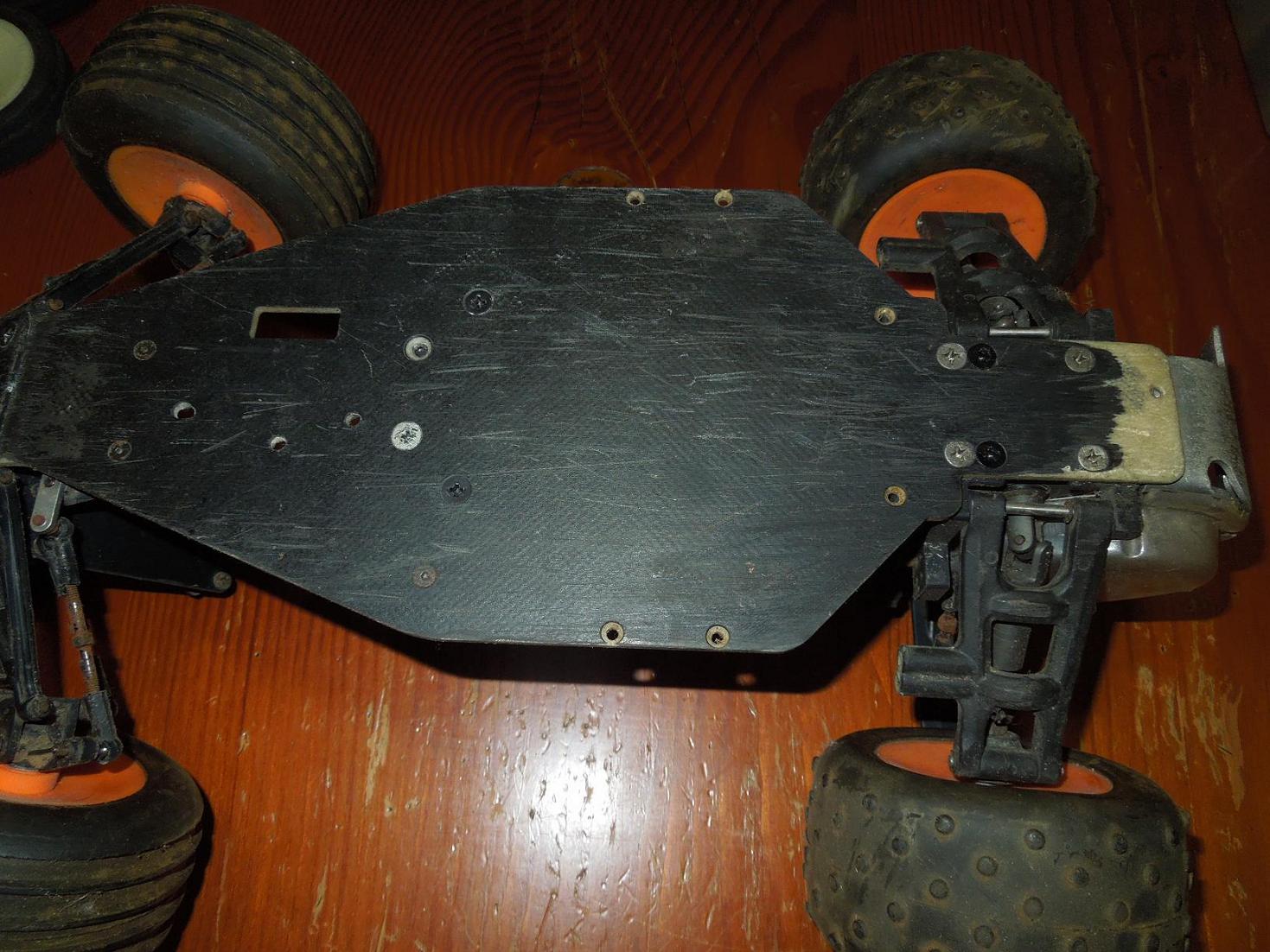

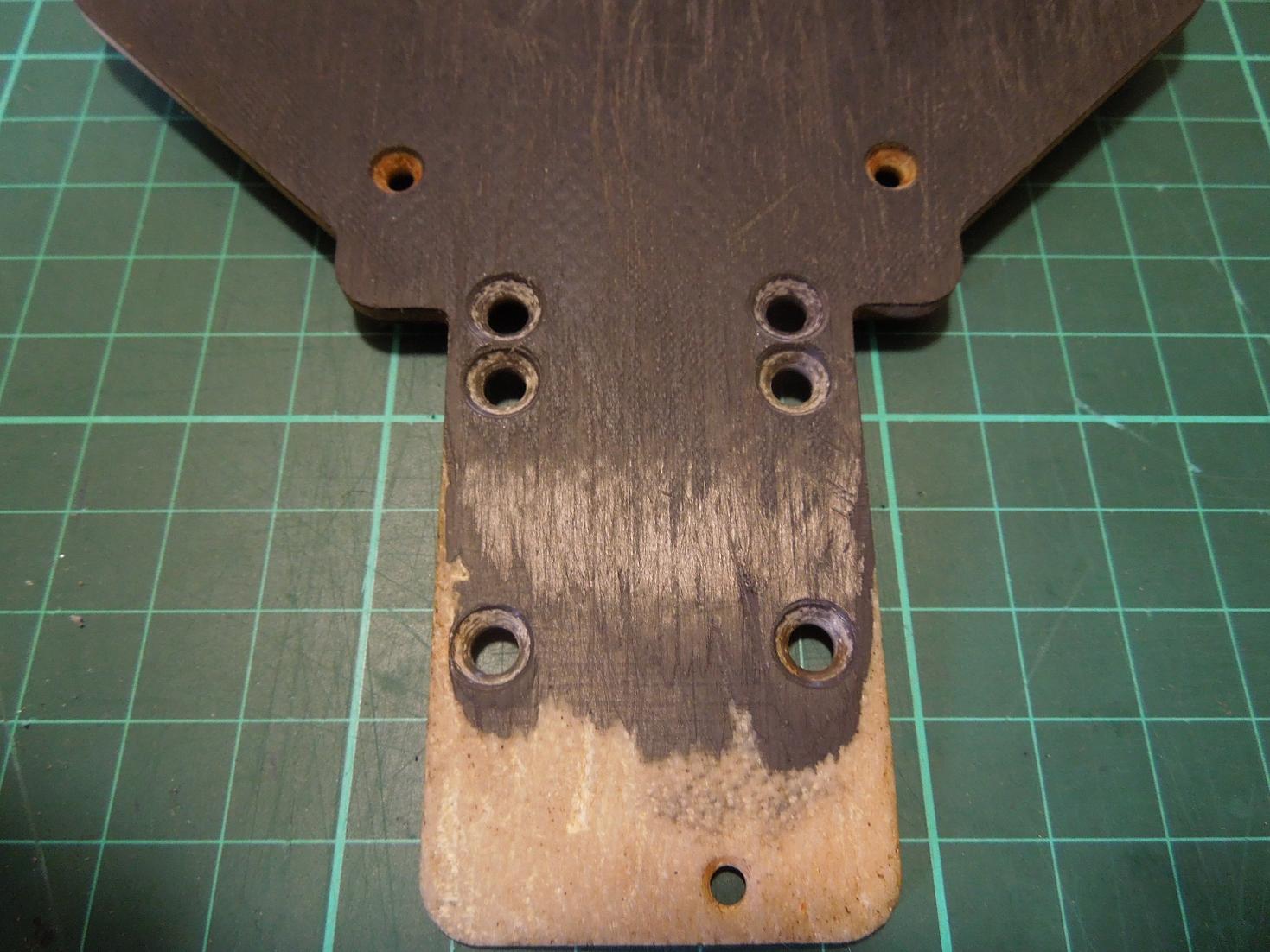

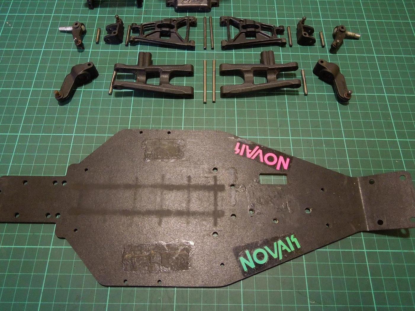

I took advantage of the wet weather to do a little bit on this today. Please excuse the poor quality of my photography.
The rear end of the chassis looks like my old Santa Cruz skateboard.  I have seen some successful graphite chassis repairs by some master craftsmen on the forum so I will probably try and beef this up before I hit the track again...
Top surface is not too bad.  I managed to get most of the residue left by the velcro and CA glue.  I will see what I can do with it when I fix the under side.  Do you think it's worth the effort to make it pretty if I'm going to run it?

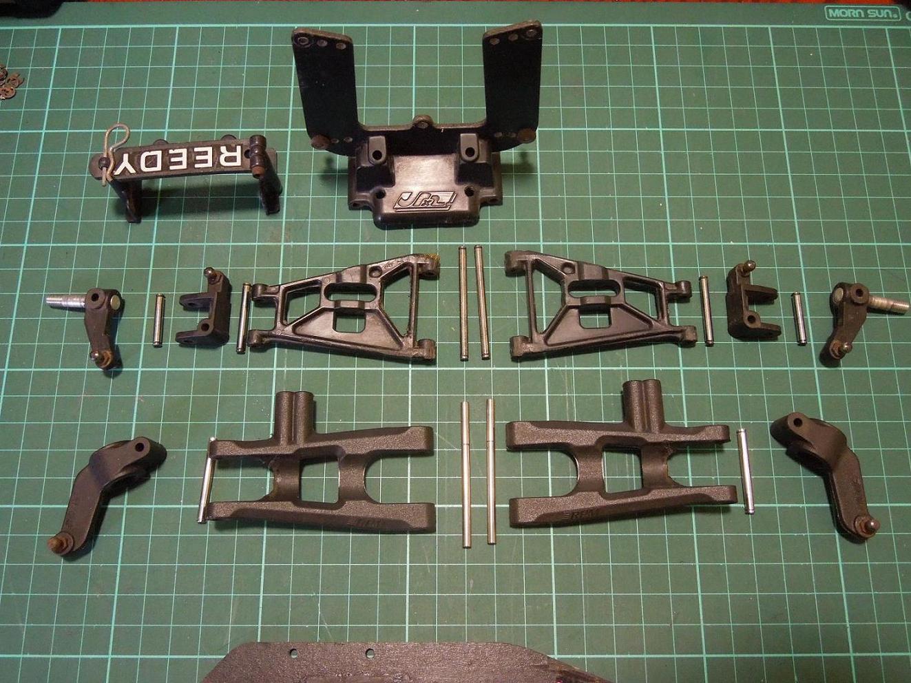

Bits and pieces will get a bit more of a clean prior to reassembly.  I might get either some RPM front arms to match the rear or otherwise some Losi Swept arms.  Any recommendations?

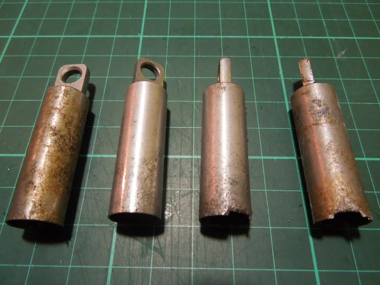

RIP shock bodies...I'm getting some XX ones soon.
