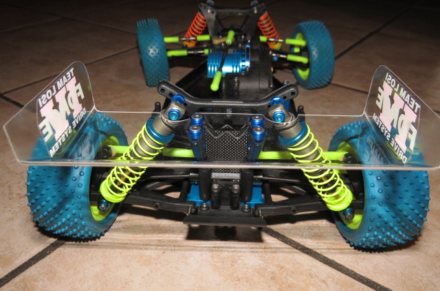

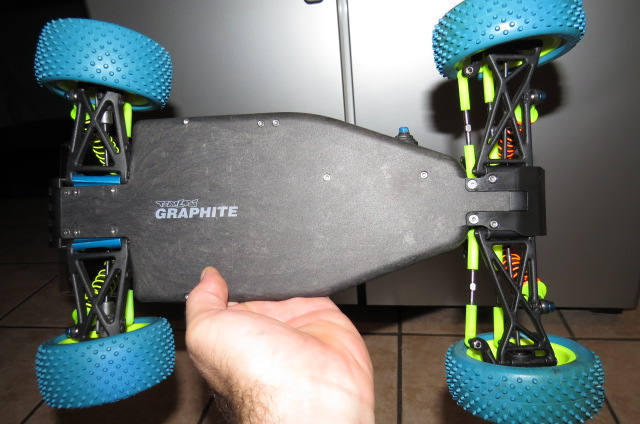

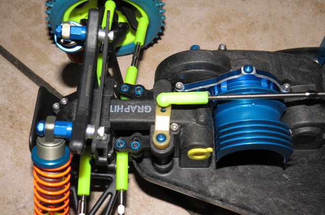

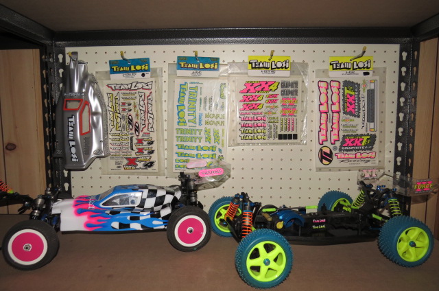

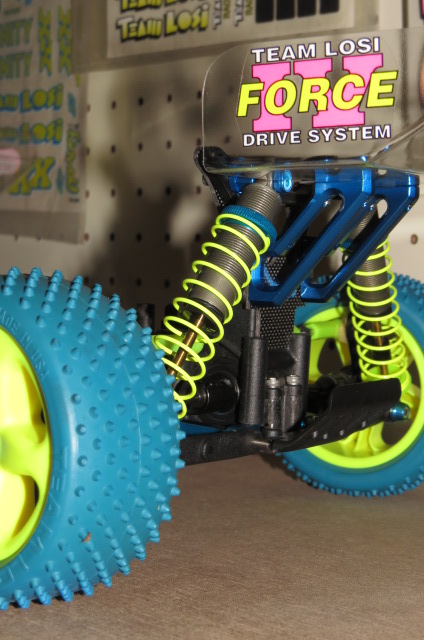

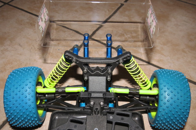

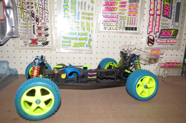

I have neglected to post for a while - but have still been slowly building a couple buggy's - 1 for the shelf (xx4) a work in progress and a XX runner for my son .
Here's a few pic's of the XX4
Big thanks to JK !!!
Cheers
Cheers

pretty darn sweet! I'd say even if it was a shelfer, score another set of regular tires for her, and put those blue ones in a bag in the dark when not drooling over them. I think the sunlight makes them turn yellow-green after a while. At the very least some kind of tire treatment with UV protection.

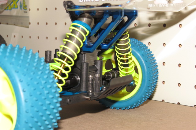

Woah! Thats a whole lotta blue and yellow!! Looks real nice though, well done. I see you cut up a Trinity rear pivot, looks like a good job from the pics - can you see any of the cuts once mounted?
Love the non-cg chassis also - I gotta get me one of those for mine!

that looks nice, Is that a CF sandwich on the shock towers??
Re: Cra$h's XX & XX4 Build's
Yes cf sandwich , penguin kit on 1st gen towers.
Yes Jam - bit of a blue and yellow fest - was thinking of white spokes with red francis nuts and ball end colour change . The pivot was easy to do and lots of painters tape was used for protection - no visible signs of mod when mounted .
Can't bring myself to hide it in a closet - to good for that and for the sake of $50 - i'll drool.
I'm chewing the fat atm with a mate to sell it - he has quite a substantial collection of high end new built's - WCS , MIP RC10 , Predator , PB , Samarui etc etc - all stored in climate controlled cabinets .
Definitely the best place for it imo
Cheers

Is it just the camera's perspective in 2 of those pics or is that some serious rear toe-in?

looks like 3 degree carriers & 3 degree hubs!!

Looks pigeon-toed.
2deg pivot block - bit of camera deception going .
Coelacanth - lets see your's - i've shown you mine - ( is that a mounty thing )

You guys are correct, that Trinity block is providing 3 degrees of inboard toe-in and then there is a further 3.5 in those hubs - Crash, you need to use CR hubs that do not have any toe in.JK Racing wrote:looks like 3 degree carriers & 3 degree hubs!!
