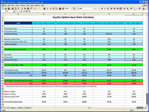

I found some useful RC gear ratio/rollout ratio calculators and even a speed estimator on this website:
http://www.scriptasylum.com/rc_speed/rollout_ratio.html
When I enter 3.0 as my internal gear ratio and my other knowns (3.425" tire diameter, 11T pinion, 41T spur), I got a rollout ratio of 0.96--which is apparently almost perfect (1.0 being ideal).
I re-calculated with the smaller 2.52" tire diameter, blanked the pinion box, the resulting pinion calculation was 14.92...so my half-assed guess using percentage of height difference was pretty close. A 16T pinion gives a rollout ratio of 1.03.
I'm unsure how the 3.0:1 internal gear ratio is calculated, though. The terminology for the different names of gears tends to vary from site to site. My understanding is the "spur gear" is the one that meshes with the motor pinion. This I believe is also referred to as the "center gear". But how exactly is the internal ratio calculated? My diff ring gear is 37T, the number of teeth of the chain-side of the diff is 18T. 37/18 = 2.056...?? Does the final pinion gear inside the gearbox that meshes with the diff ring gear factor into the equation (it's 19T)?

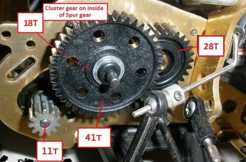

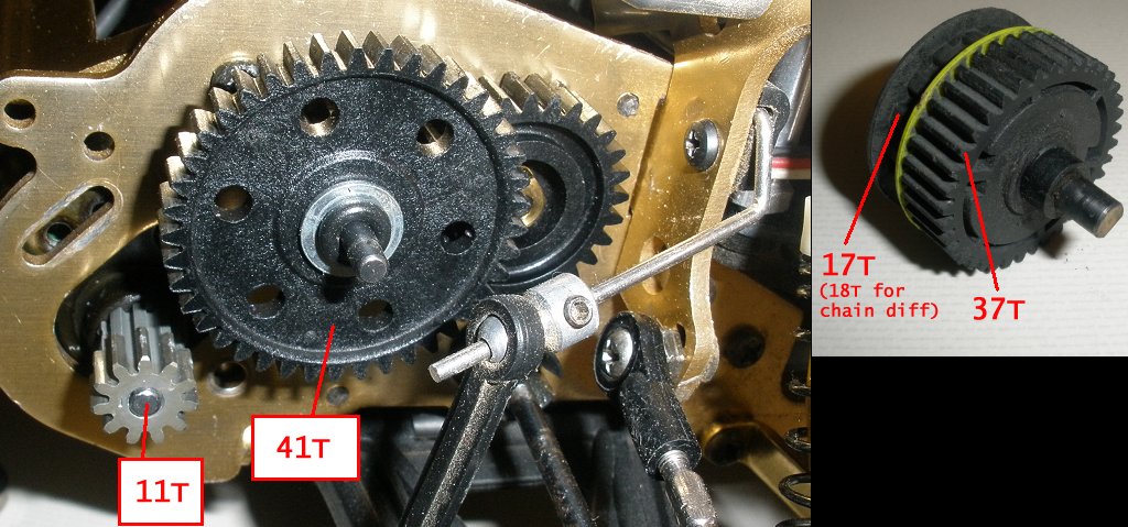

This is an old topic but the question was never answered as to how the Optima 3.03 internal gear ratio is calculated. I've since figured it out and will update this topic in case anybody else has the same question. Here's the math:
Gearbox gear ratio = 37T diff gear / 19T final pinion = 1.555
External gear ratio = 28T counter or limiter gear / 18T cluster* gear = 1.947
*The smaller gear on the inside of the stock Optima spur gear is the cluster gear, which meshes with the counter gear; a.k.a. the limiter gear if it's a Turbo Optima.
1.555 x 1.947 = 3.03 (rounded up from 3.0276)
The Optima was sold with 12T and 15T pinion gears. Final gear ratios (as shown right on the Optima box) are as follows:
(Spur gear / Pinion gear) x 3.03
12T pinion: 41 / 12 = 3.42 x 3.03 = 10.35
15T pinion: 41 / 15 = 2.73 x 3.03 = 8.28
Those 2 numbers match what's printed on the Optima box. Updated my image for clarification. (Note that the pic shows an 11T pinion, not the stock 12T or 15T.)

Sure, but what gear, exactly? Does it have sprockets for a chain?marlo wrote:A few years ago, while I was doing a scrap run, looking in other people garbage. I found a box full of RC parts. That gear you have pictured ( for the chain drive ) was in there. I'm looking at it right now, I had now idea what it was for. I just put it in my junk box. If you want it you can have it.

If you mean the diff gear with the yellow plastic ring in the middle, that would be a diff for an Optima Mid--sure, if you don't have a use for it, I'll take it. Just let me know what the shipping costs and I'll reimburse you. PM me and we'll take it from there. Thanks!marlo wrote:It kooks just like the gear you showed with that green spacer, would the tooth count be marked some where.

Anybody here have the stock Optima Mid internal gears and can update me on exactly how many teeth they have? I'd appreciate that, and update my spreadsheet I've been working on the past few days.
