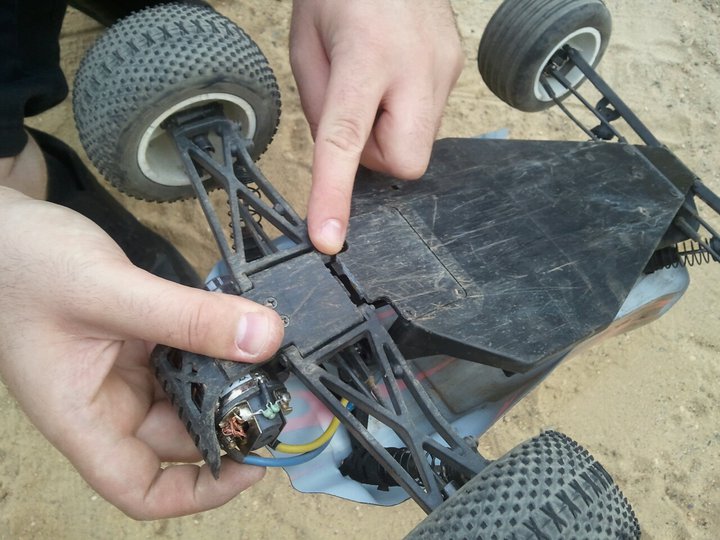

all in all great deal and a great start in the hobby with the least amount of cost. sad part was cause the truck was so cheap and i saw my buddy bash the heck out of t3s i went very rough on the truck. first thing to bust was the rear mounts/rear chassis section. many other parts like top shaft ,slipper, pinion gear, and motor went bad. so i figured worst case id take the bearings out to put in another rc10 only to find out they put a off beat sized bearing in the center/idler gear(pretty sure idler gear and top shaft use same size bearing on t3). left them bearings in, replaced the rest with bushings. then gave the truck to a guy i worked with to get him started in the hobby. so fun truck to play around with,and alot better then starting out with a toysrus rc. just not the t3 we know kinda a sheep in wolfs clothing :lol:

That looks like the Thunder Tiger truck. I always wondered if the Thunder Tiger metal rear plate and nose plate are the same as the T3 or "cheaper"

TT uses an other plate, it's plastic and won't fit on an RC10. They offer an upgrade metal one, but then you'd also need the Rear Suspension Mount Set (3° Toe/3° Anti-Squat) ASC9267. Other option is to use the Asso rear chassisplate (9241) and Asso motormount (9245). I personally would go for this one!
TT idler gear uses metric bearings and diffrent shaft. rest of the gears is interchangable.

after the rear broke on the mrp/t3 i put on a metal t3 rear. i didnt know it was a different shaft for idle gear too.. yea id stay away from the tt t3 now even if it was a great deal. my thing is i dont like ball diff bashers so no more t3s for me ill stick with my t4s for bashing.
