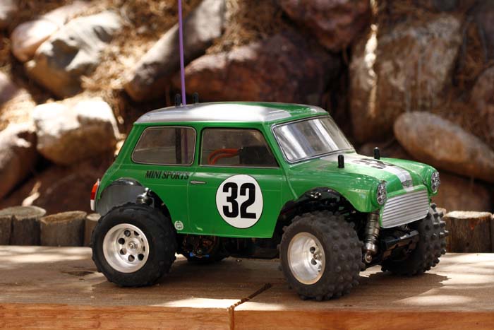

I've had this M-05 based Mini Cooper for a few years. Didn't get much use since there are no smooth flat surfaces close by. What I do have is a large gravel driveway and a great off road area. So I decided to convert the Mini to a MiniClod.
I joined the front halves of 2- M05 front wheel drive sections together for 4 wheel drive & 4 wheel steering. I added the 3Racing locking diffs for better traction in the dirt & sand. I took a few parts off my Clod to get this going. The current set up is 2 Integy 55T motors, Tekin FX esc, C.E. servo, and a 2S lipo. I made the aluminum wheels to fit some old RC 10 knobby tires I had. I retained the 210mm wheel base. This combination worked out great. I figure top speed on the gravel driveway is about 8-10 mph, and will climb pretty much anything with the only shortcoming being the low ground clearance. I have a pair of 1.5 dia. paddle tires, and I'm looking for a second pair for even better traction in the sand and snow.

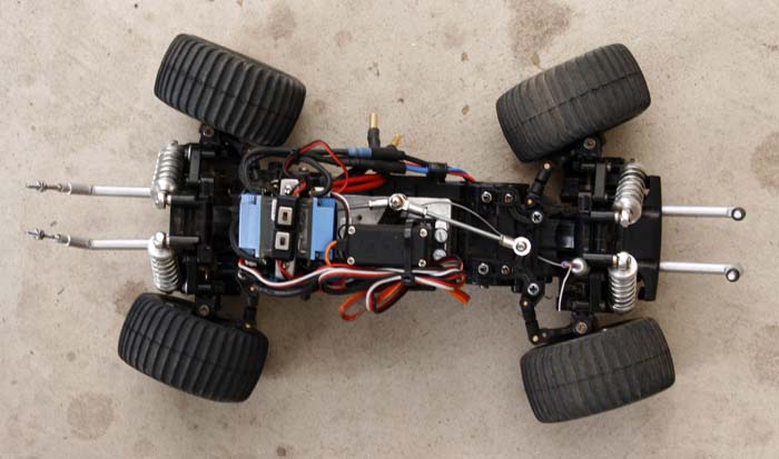

The chassis is held together by a 3/8" thick piece of aluminum on top using the 4 existing mounting holes. A 1/8" thick piece of aluminum on the bottom. 4 long screws hold the bottom piece in place. The screws also keep the battery from sliding around. The battery opening is slightly bigger, so I was able to use a 2S lipo.

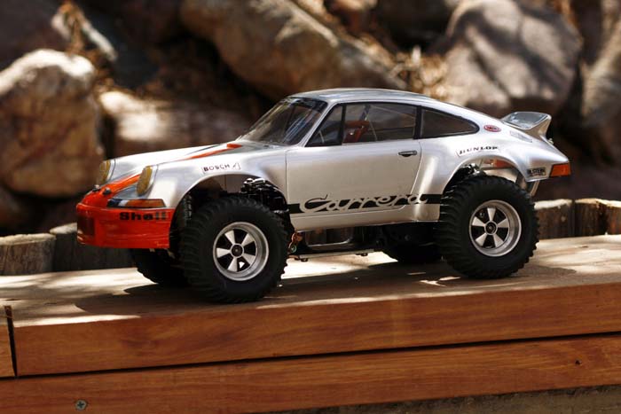

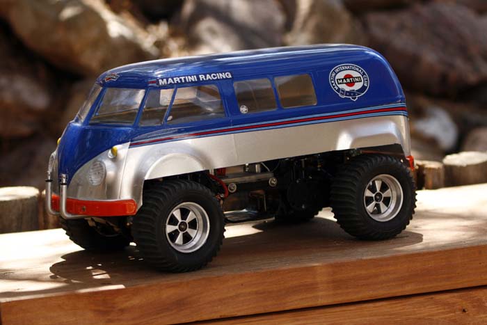

Here are a couple of body options. The Mini body works with the 4ws, the Porsche body needs a little more trimming, and the VW bus body is another option. This one is off my snowcat and just a test fit.

Made a few changes. I switched to a pair of Exceed Rocket 2215 740kv brushless motors for more steering clearance. The motors fit inside the housing and are flush with the body. I went with the smaller cans so the wires would clear. Also using dual 35A esc's, and a 3s lipo. It climbs as well as the Integy 55T brushed motors with less weight.
