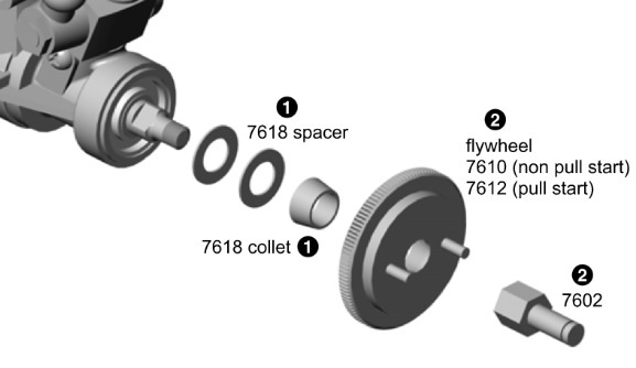

Rc10boi wrote: From a birds eye view, you can see the gears are off to the left very slightly. If I loosen the tranny screws the gears mesh perfectly. Very weird. :|
If I read correctly your issue isn't with the mesh of the teeth it's more the side to side fit of the gears? If so, you can remove or add spacers before the collet to adjust this. I don't remember running any spacers on my gt bitd
