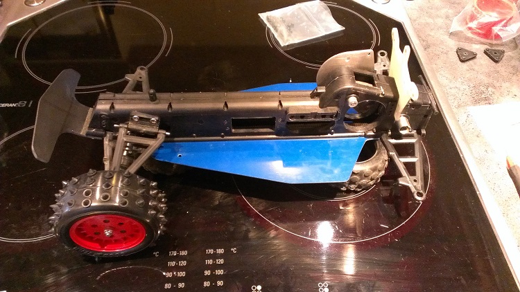

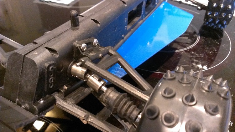

I bought a well used Mini Mustang january this Year. The guy I bought it from has had it from new, and been club racing it for 4 seasons at a local Danish club.
It was in a bit of a rough shape when I got. The chassis was divided at the rear and had a lot of weird hacksaw cuts, unsalvagable. I only had blue fibreglass, so the new chassis is pretty much blue.
The chassis rails (backbone) was beat and had superglue and many extra holes - Luckily Alex (Incredible Serious) came to my rescue, letting me have a set of backbones in good condition - Thanks Alex.

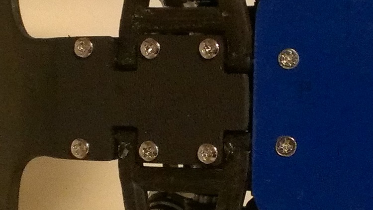

The bumper, besides absorbing impacts, holds the front suspension in place. The ones delivered with the buggy had seen to much absorbing, so they would only serve as keeper of the suspension.
New one is fabricated in 3mm kydex with milled clearance for the diff.
There were to sets of drivelines with the buggy, fine and coarse tooth. I installed the fine toothed.
A close view of the front UJ with oneway

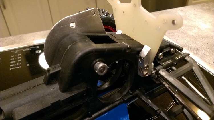

The rear shock tower

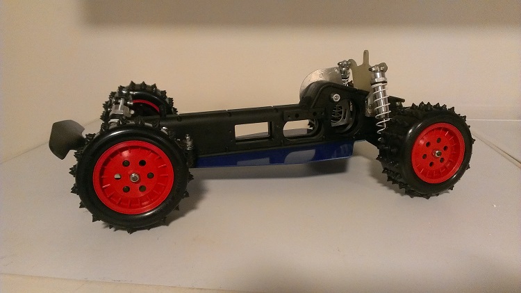

It came with Schumacher shocks front and rear, cleaned with a brass brush and will be polished later

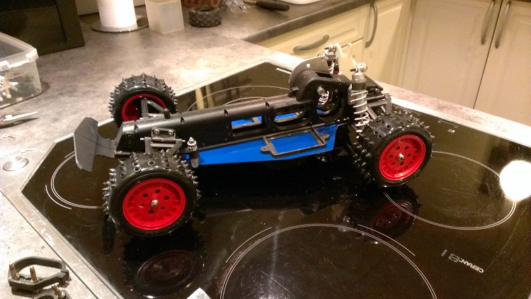

The new Hammer Shark bumper :roll: - sometimes You win, sometimes You don´t
Have yet to decide if it´s going to be saddle or stick. The stick arrangement for this buggy, is a bit mal engineered in my opinion

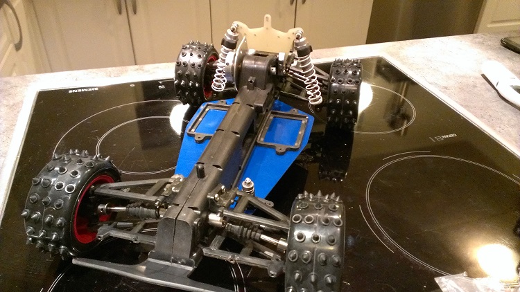

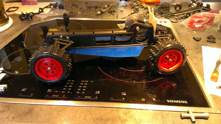

Got a little more done today -
Polished the shocks and replaced the pistons, which was just a LITTLE bit bend.
Mounted some new front suspension struts, which I took from an ENA 3D buggy - the mounting holes chassis wise, are a direct fit. Wild Willy delivered the main parts for the crossmember.
The old upper front shock mounts consisted of cutdown original rear mounts combined with a CAT XLS rear shock mount - an odd sight.

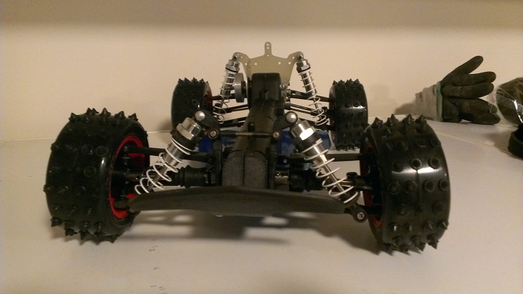

The new front upper shock mount.

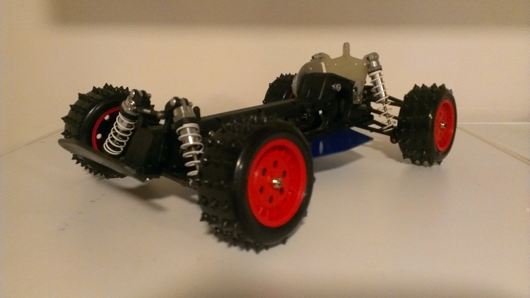

Nothing beats fresh rubber and rims - I believe the rims are shared with the TAG Geronimo and the SG Coyote, but who made them?
