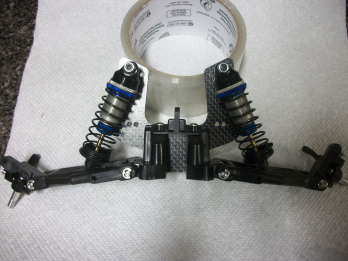

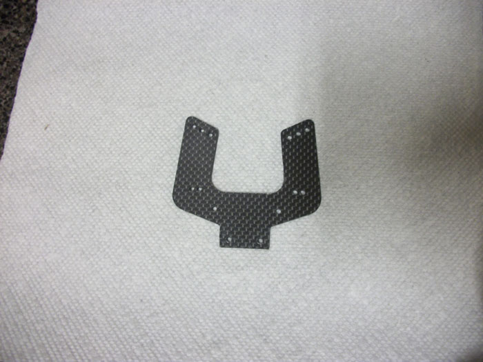

Alright guys, that was a lot of fun...
Actually I ran into a bit of a problem but I still was able to produce a part I can use
I wanted to run the shop vac to keep the dust from building up but controlling the machine, recording, and vacuuming was too much to do at once. I also did not want to run coolant cause I don't want the dust in my coolant just yet. I need to do some more research on machining CF.
The first video is the machine working itself around cutting the holes for the tower. I don't have a drill chuck for the machine yet so I had a 3/32 end mill go around and make all the holes. A drill would have been faster but this was all I had.
The second video was the profile of the tower. I only made 3/4 of a pass before I had to put the camera down to fix a major problem. You can see at the end of the video, the end mill was actually smoking. I didn't realize this but the end mill was not the one I wanted to use for the tower. I cut the video and finished the tower with the proper end mill and it came out great.
Things to do:
Setup a vacuum system
Finish mounting my coolant line
Finish the coolant splash guard
Overall, the build was not as intensive as I originally thought however I did have a few moments of confusion throughout the process. I still have a good bit to learn but as time goes on I will become more proficient with the machine.
Enjoy the videos.

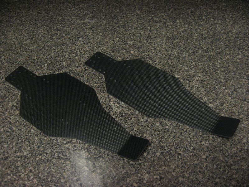

Hey guys was able to cut two chassis' today. I was only going to cut one but I screw up the material placement the first time. I was able to save the chassis, I just had to make it narrower than I wanted. The chassis' are for a Traxxas TRX1 that I drew up.
I am calling the mill thread done for now and will posting pics of parts cut in the various forums where the builds take place. Looks like the 91 Worlds car will start making progress again...
Jake
