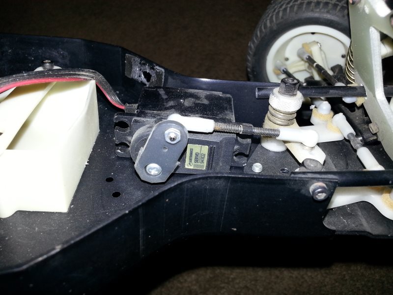

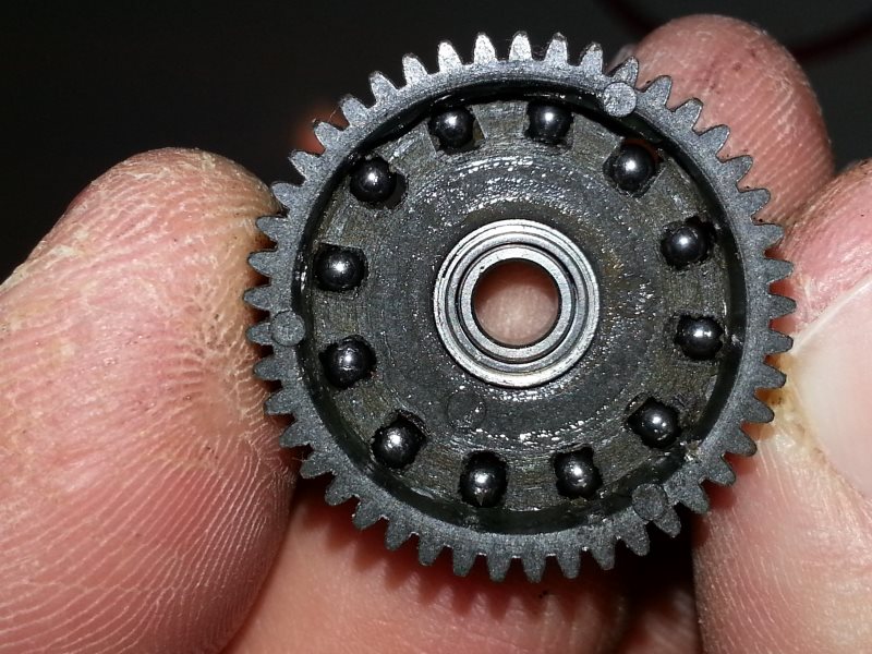

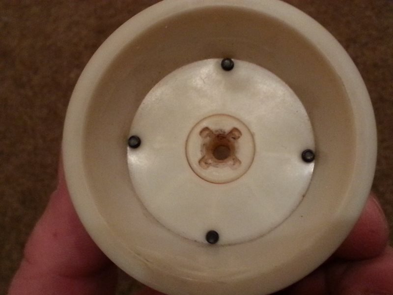

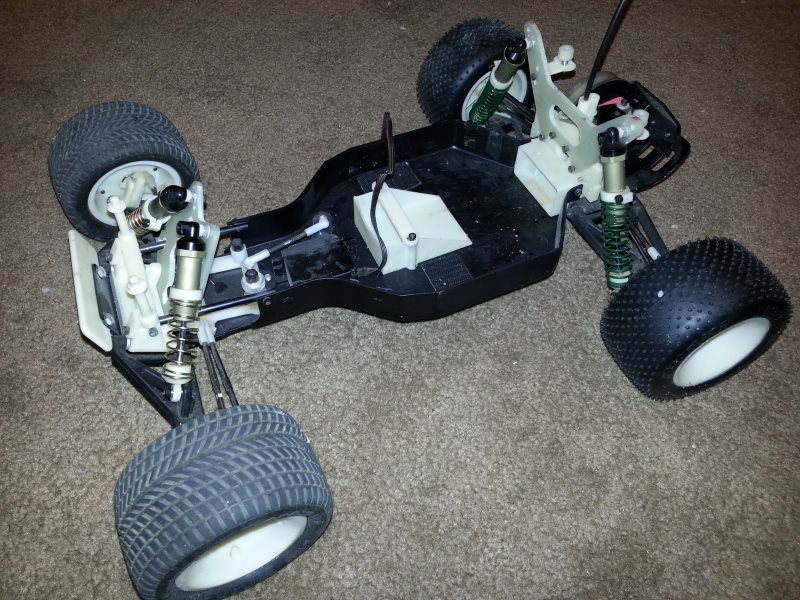

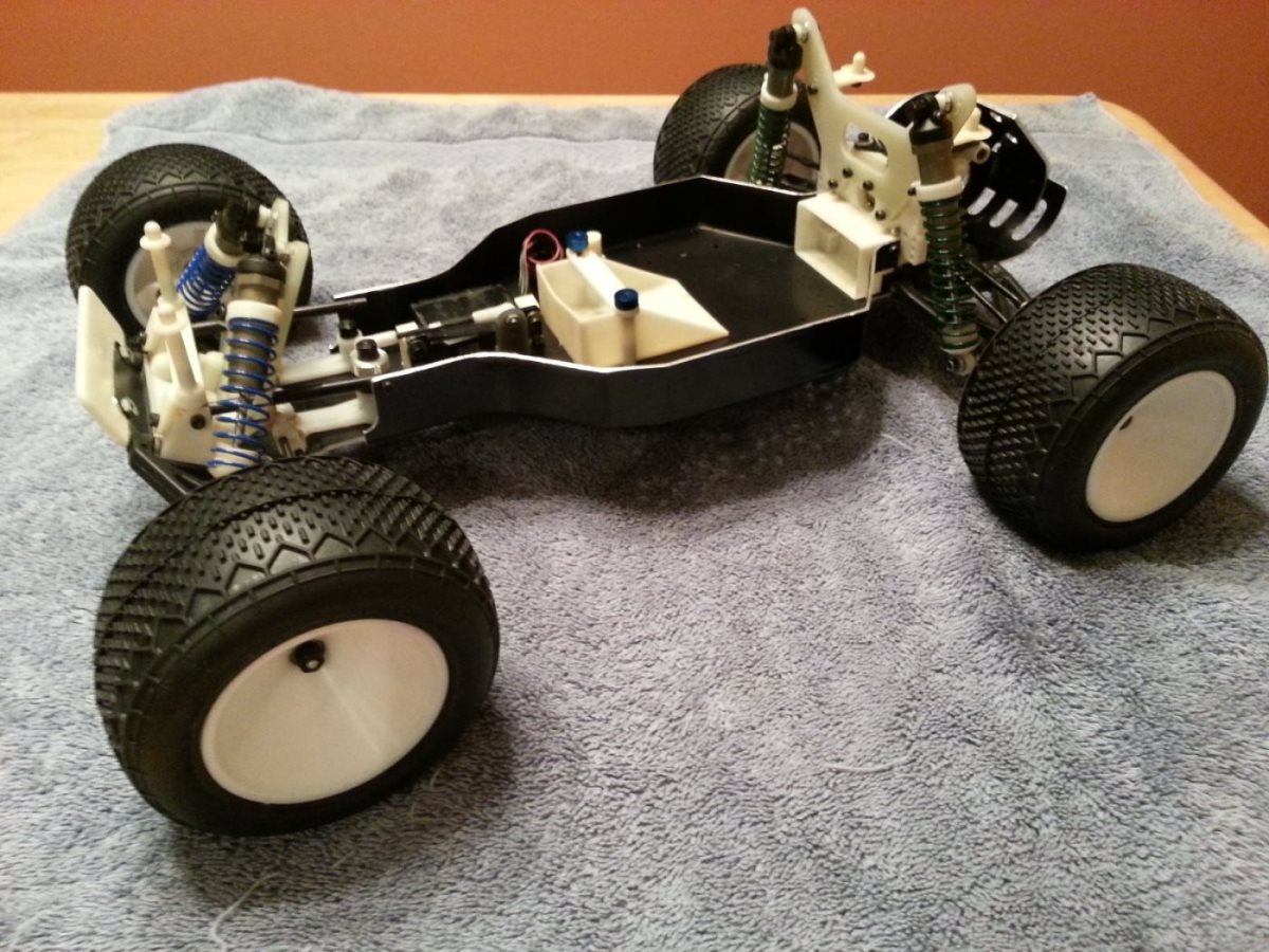

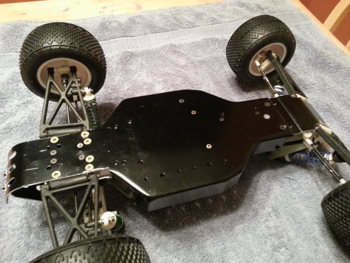

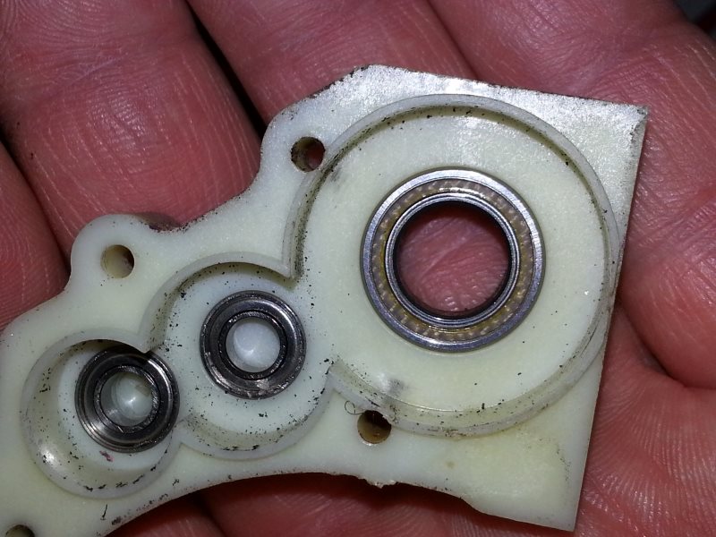

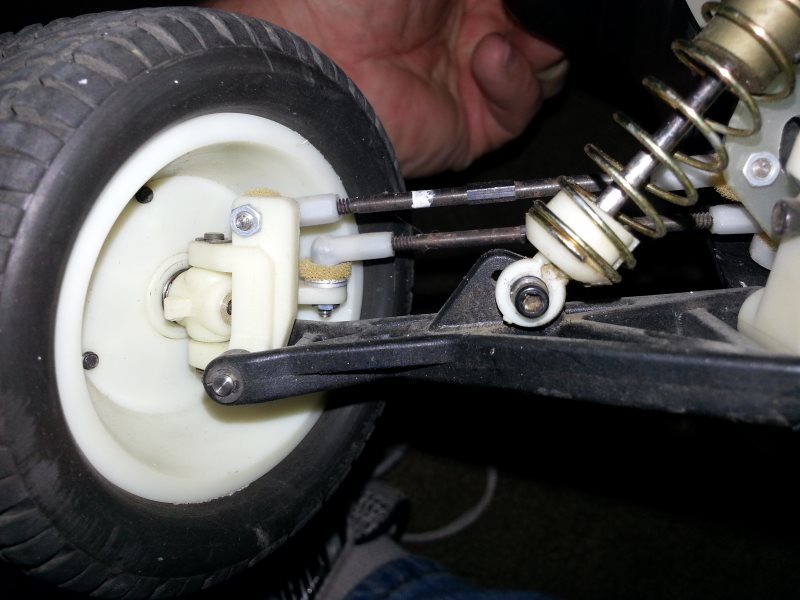

The truck showed up at my door on Christmas Eve day. I finally had time to tear it down, clean it up and reassemble it. So far I am waiting on the B4 slipper parts to show up to convert the trans. Otherwise, I think the pictures speak for themselves. Does anyone know what front arms the truck has? They look newer. Also, it appears I have 1/4" rear universals on it. Am I able to get plastic hexes from the T4 and ream them out on the back side to fit so I can run the newer hex wheels? I f i can do that, should I convert the front wheels to hex's also?

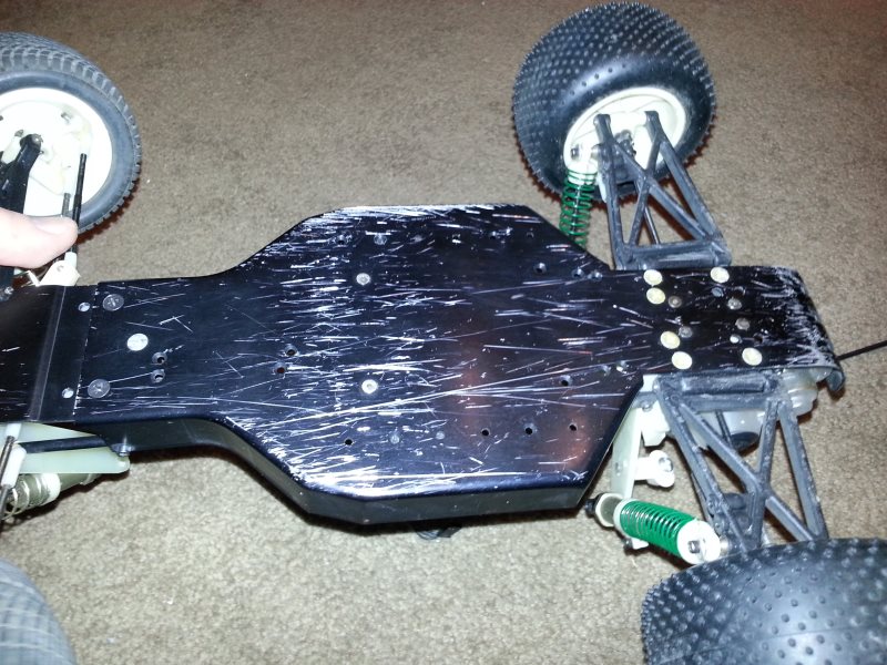

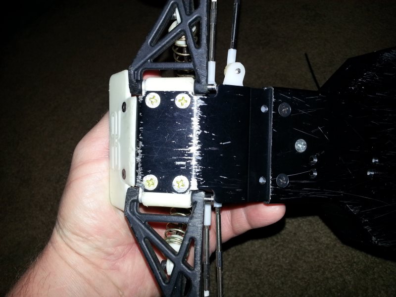

The diff looks like it hasn't been run hard or was rebuilt before I bought it off ebay. All in all, I am happy with the purchase, just wish the bottom, wasn't scratched so deep.

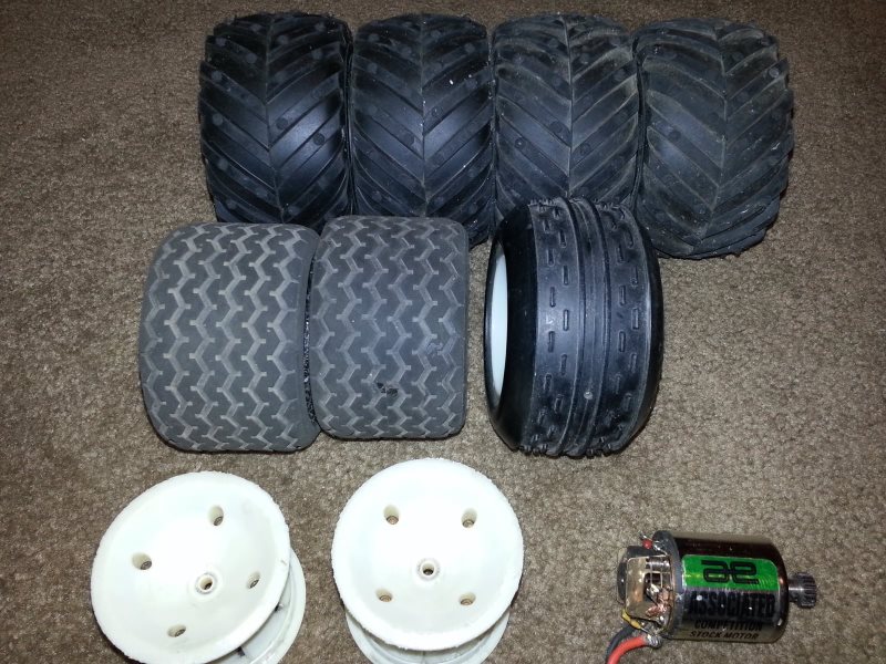

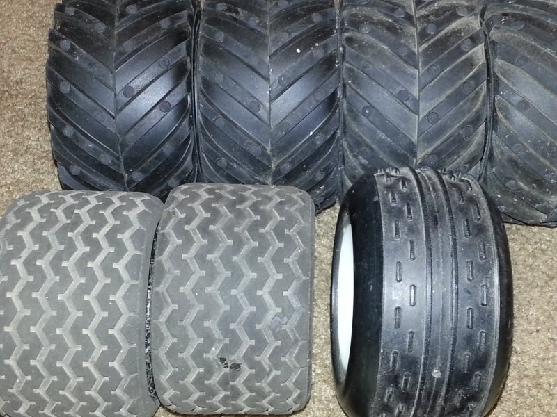

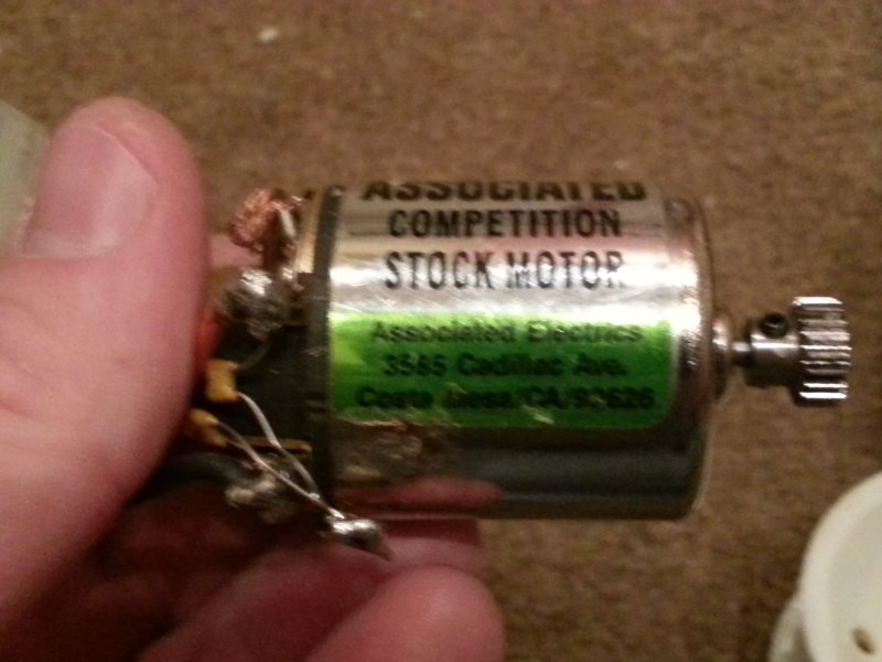

A few more pics. The seller included a bunch of tires. I don't know if they were meant as packing material or he just wanted to get rid of them. Both the servo and motor work. The wheels are missing the band and look like they had tires glued tot he bead before.
You could, but not much point, since the 1/4" and 3/16" pinned style is still supported by AE and aftermarket. If you can find 1/4 wheels you like, run the universals. Otherwise, just pick up a set of T/T2/GT CVDs and 3/16" x 3/8" bearing, and run 3/16" wheels.
Also, by going to 3/16", you'll be able to use commercially available alloy clamping hexes, should you decide to run hex wheels. There is only one source for 1/4" hexes, they are not clamping, and they do change the offset a bit.
I run 3/16" CVD or universal axles on all of my trucks, save for my white parts GT shelf queen.

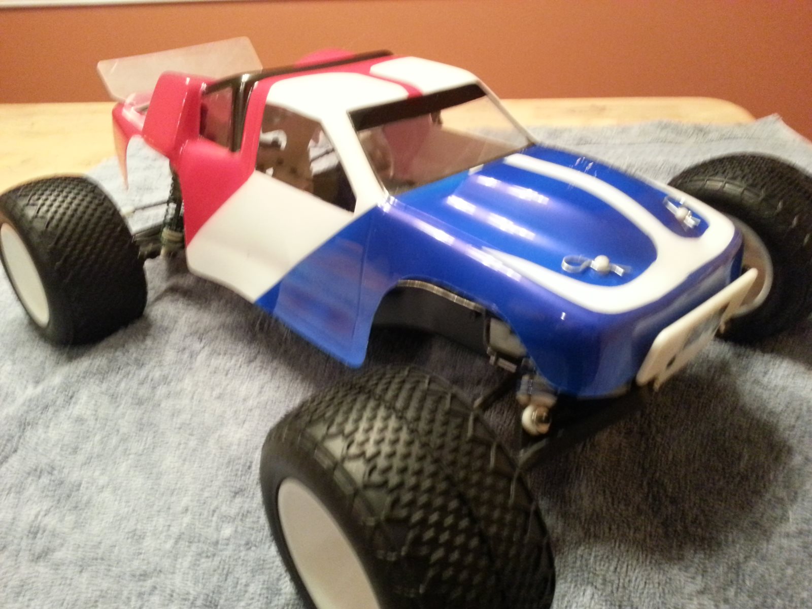

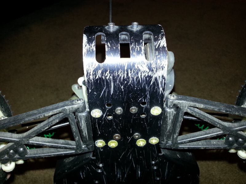

Here is the finished truck. As you can see, some of the scratches were a little too deep even for light sanding and still appear after the paint. I'll try to strip the truck in the spring and see what I can do.
Just need to sort out the trans rubbing issues.
