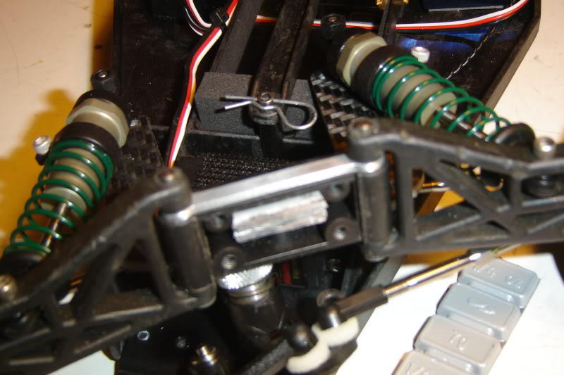

I may eventually try some weight up front;
- any chance you could show exactly what you used for weight and where you mounted it?

I had the correct ballast weight but I missplaced it :oops: anyway you take the front kick plate off and mount it inside the front bulkhead (it's technically hollow) then reassemble the kick plate.

someone had a picture of it before. they used a stick on 1:1 wheel weights, trimmed to fit up inside the bulkhead.

jwscab wrote:someone had a picture of it before. they used a stick on 1:1 wheel weights, trimmed to fit up inside the bulkhead.
That was me on my B2, same bulkhead as B3 and T3. I think adding weight helped the most for me!

slotcarrod, How much weight did you add?
Currently I have added travel-limiters inside the front shocks, stiffer rear springs, and dialed in a bit of toe-out.
With all that my T3 handles very good, but I think I will try some weight in the front bulkhead to further settle the front end.
(I have several 1/2 ounce weights, not sure how much to use though)
