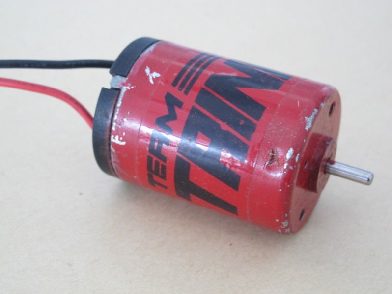

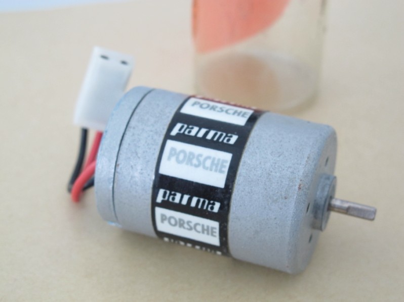

I really love the old Igarashi based motors. Just got this Trinity stock motor and the Parma Porsche.
The Trinity have some signs of wear from storage but seems unused. The Parma motor is new for sure and came in a motor box. Got these at a shop when asking for old motors. :D
