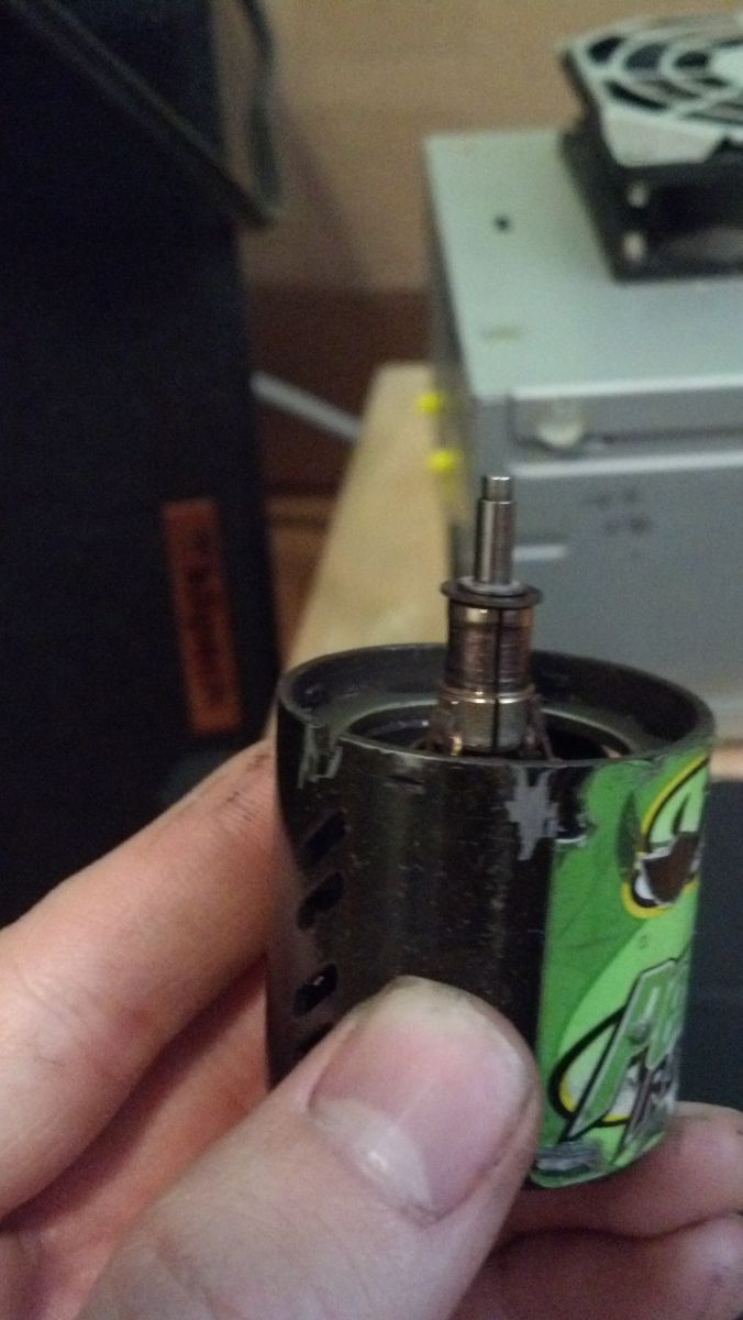

First, I have an adjustable timing motor with the endbell removed and no markings. How do I reset it to 0 degrees timing? What will happen if I accidentially put the endbell on flipped 180 degrees? And how do I count the wires to find out how many turns it is? There's no label.
The Trinity Chameleon and the Peak Dynasty 19 turn motors appear to have some comm wear. Do they look like they're due for a comm cut?

To find 0 degrees, look at the magnets. Dead center between the two is an imaginary line, that's 0. Line up the screws with that. (A sharpie works).
If you put it on backwards the motor will run in reverse
(if you think about it the only difference is the + and - marks)
Re: Brushed motor questions
So if I put the endbell on backwards and switch the motor wires, it will be the same as if I did nothing?
