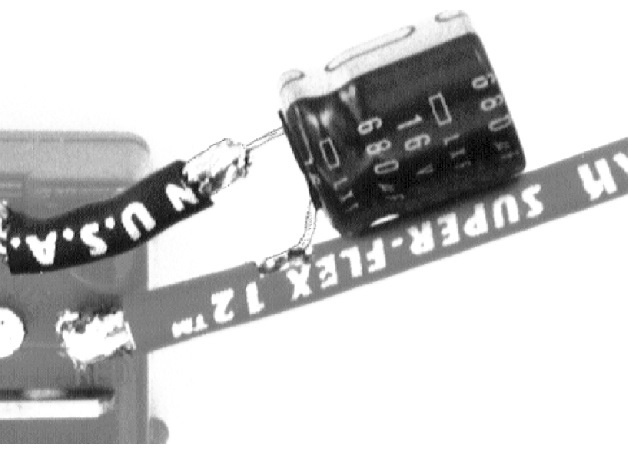

I wrote to novak a few years ago with the same question. John responded back saying they are 16v 680uF caps. The part number is 5682 if you want genuine parts or you can buy them online for cheaper.

Interesting.... But id take a Novak techs advise over the bit I searched any day! In the manual it specs a part number 5670, which doesn't come up on the Novak chart, however in a pic of a cyclone which uses the same kit it shows this...proving Richies post
