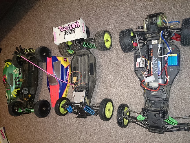

Thanks for your reply Shawn!
I have attached a pic of the three together, they all want rebuilds and look terrible next to everything else i have seen on here but you've got to start somewhere and i am just happy to finally own them!
Looks like the XX4 is quite rare beast as it took me ages to find one....
I'd like to build them up in 'period' spec, managed to get a Novak Cyclone and LRP IPC speedos from ebay so thats a start.

I was watching that Double-X for a while on eBay but with only two not-so-great photo's, I passed. The 'home-made' front brace reinforcement looks interesting but will obviously need replacing with the re-build....Klubtropicana wrote:Thanks for your reply Shawn!
