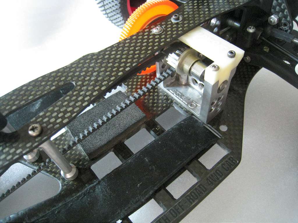

- The top deck was also modified so that receiver and antenna mount (I used one from Kyosho, small and light) were both on top deck. The antenna did come out from middle of "windshield" and not have anymore possibility to stuck under rear wing. Also the whole receiver&antenna was on different level on car than power wire so possibility to radio interference was much smaller. The rear belt tension adjustment possibility was removed, only "the correct" tension was left. With this mod we managed to remove the stock rod adjustment rod to get the a bit lighter and made room to rear camber plate.

The "bags" around tie rods kept dirt, especially small stones, out, but also water if we raced in rainy weather. The major problem with Yokomos was open drive train. Small stones in rear diff pulley stuck the whole drive train and changing rear diff pulleys and belts, cleaning and replacing rear diff parts without those "bags" should have made about after every run, if the car even managed to work the whole 5-minutes.

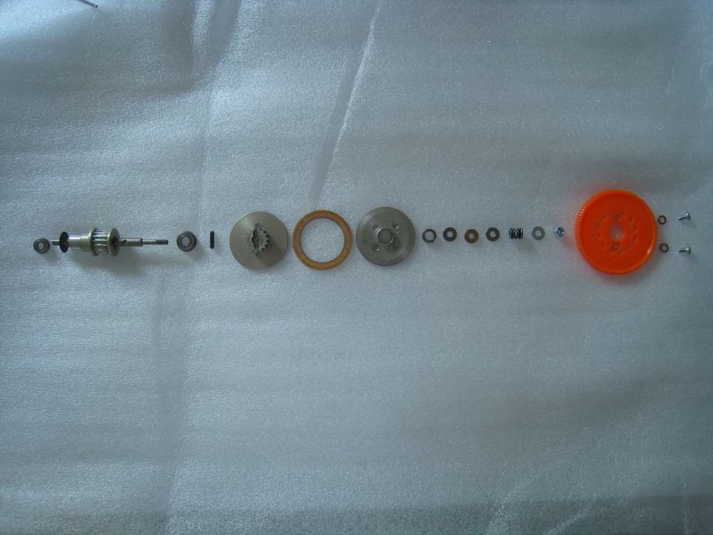

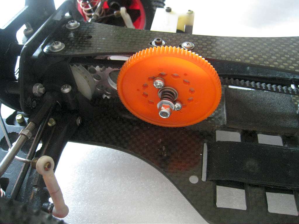

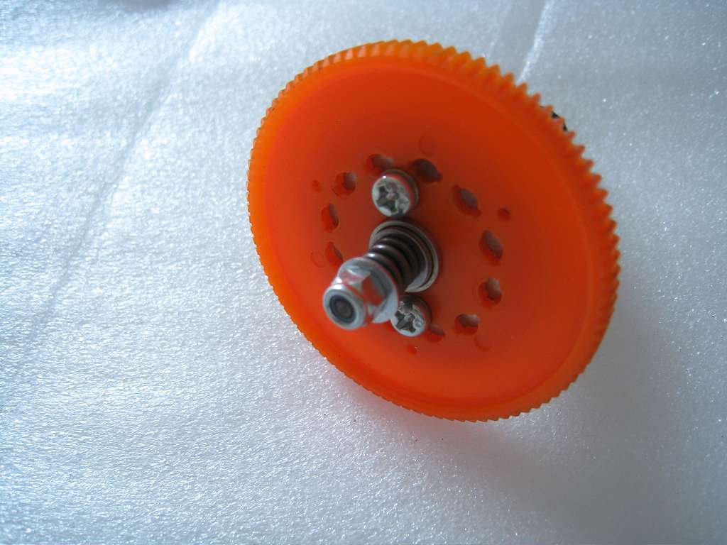

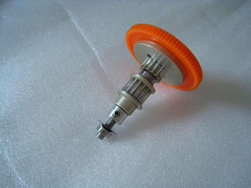

Thanks to both Gentlemen Vin and Aaron, I got all parts to Yokomo's TCS. It is now installed to my YZ10. The thrust bearing is bushing style, I have never seen this kind of solution before, but since I will not drive my ZY10 no more, it is just fine. The slipper clutch is really smooth and I do not know what kind of grease is needed to such a thrust bearing, I keep it just dry. Maybe it is self lubricant.
