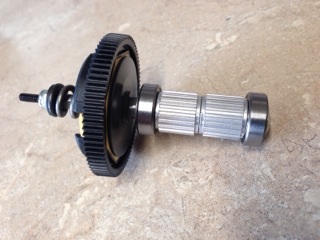

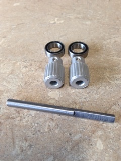

Finally got back on to this one a bit today, as it stands you would need a couple off-the-shelf pulleys from Sdp.si, a pair of 10x16 bearings, and a layshaft from jwscab.
I'm not 100% happy with the area between the two pulleys, it would be nice without it- but this is all done without machining to the parts besides the custom topshaft. Until I can find the perfect pulley these should do fine. They will also allow any combination of belt widths due to no flanges. The lower diff should keep them on track just fine.
I have a nice plastic center pulley I planned on using, cutting down these pulleys to fit it in the middle. Due to time and cost it isn't really a viable solution for me however. Again, unless a better pulley pops up. I am still searching, perhaps misumi has something closer...

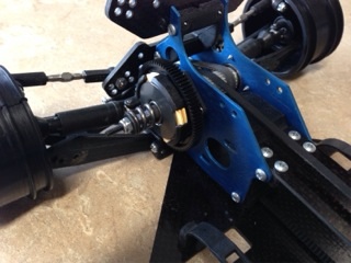

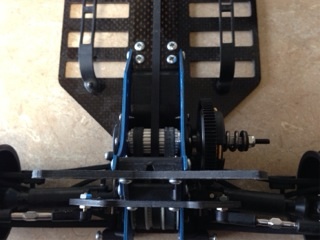

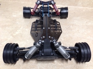

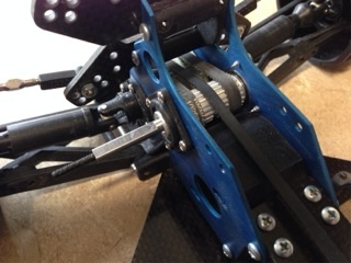

Re: Bosscat Works project- updating the slipper
Wow it's really come on.
Now how dose it sit with the shocks as it looks long, I had a problem with my wasp slipper catching the shocks if u wanted to use the inner most hole.
- Posts: 12353
- Has thanked: 1133 times
- Been thanked: 3930 times
I need to have jwscab modify the shaft a bit, I had him make it too long and also the setscrew needs to be shorter or driven in further. At full droop (which is beyond where it should ever be lol- I need to limit it), it doesn't rub using the inner upper and outer lower holes with the large losi shocks. It is very close tho. With making the changes to the shaft it should be great. The slipper could be installed further in, but the slipper plate would need to be machined or the one pulley to fit it. Again, more machine work means more cost. As it stands you only need one specialty item, they pulleys are bored to the correct spec and all.
You can also run the losi hydradrive, losi slipper, losi dual disk slipper, and associated dual slipper so there is a lot of adjustability. Just a matter of using the proper spring length to make each work
